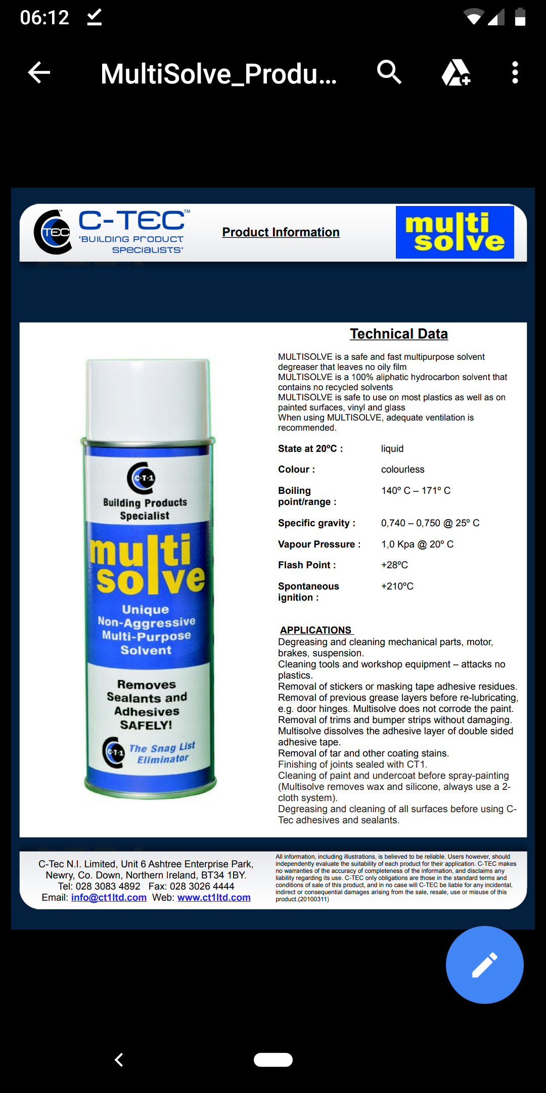

Multi solve cleaner is a good product and is harmless to most surfaces there's no fast fix solution a sharp scraper and elbow grease. Kop

It's often just a case of finding what works to clean off your problem as cleaning is normally specific to what you're trying to get off rather than the tile , always test in an inconspicuous area first to make sure it doesn't damage the tile first , but do not use any acid based products on marble as it will ruin it as it will dissolve the surface .
