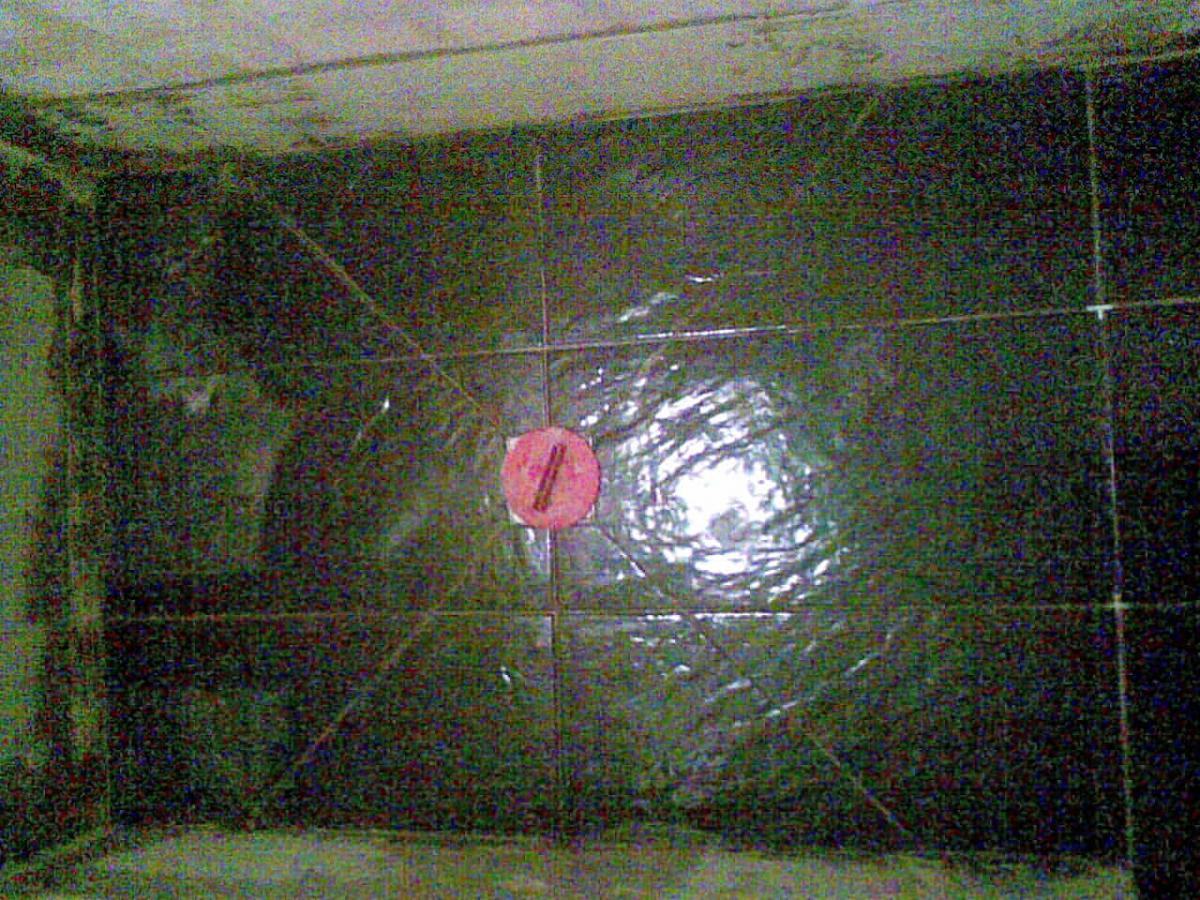

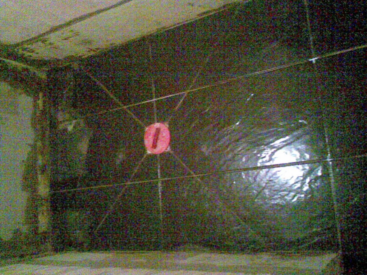

Today I managed to tile the former. I still need to grout. Apologies for the poor picture quality, that's what a 1.5MP phone camera does. The posh mobile is broken :huh2:
You can see I've got the grout lines all in etc and they are all close to 4mm.

Both pictures show the waterproof membrane lapping the walls, left, right and rear. You can't see the membrane lapping the screed at the front because they are hidden by the tiles.
The walls inside the wetroom area are to be primed with SBR prior to fixing the tiles. I have used the tape that Wetdecs sent me to do the vertical corners - you can just see on the left of both pictures.

What do you reckon to the laying etc?
I had to use the wet cutter for the angled cuts, but I only wasted 1 tile, and that's because I tried to use the dry cutter as I explained yesterday.
The top RHS corner of the former was set too low in error, so I had to build up the adhesive for some of the tiles around this area to compensate. Also, to compensate for the tiles being a riven, not smooth surface I steepened the fall a bit.

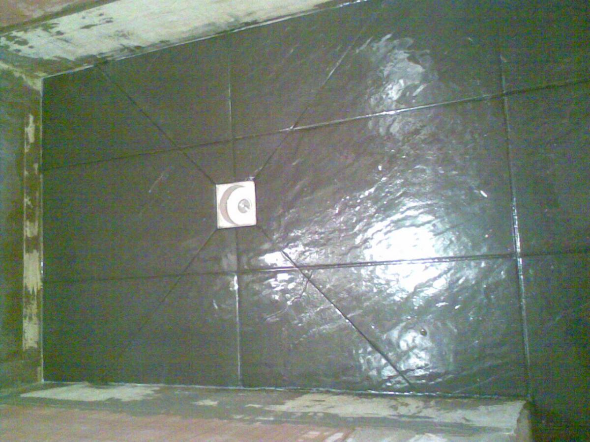

...and now with the grout....

just a quick one m8,am i right in thinking that the former comes with the falls built in,and that these falls sort of originate at the gully and rise up to each corner,creating 4 triangles,if this is the case then did you follow these lines as grout lines for the envelope cuts or did you create your own falls using addy.the reason i ask is(an i think i am confusing myself here)if you have trimmed the former off the long edges should not the diagonal lines for the envolope cuts have been on the short edge of the former.i hope you understand wot i mean,not sure i do !!!
