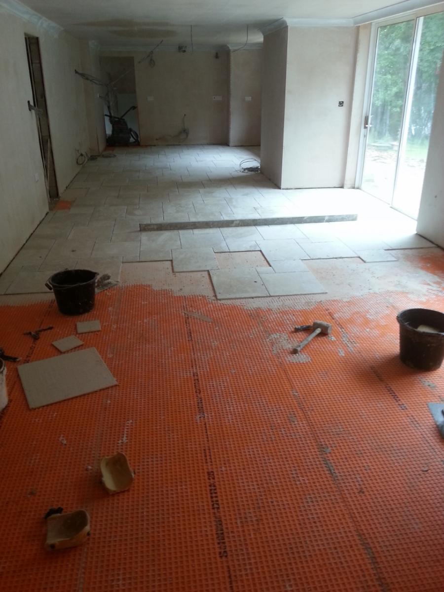

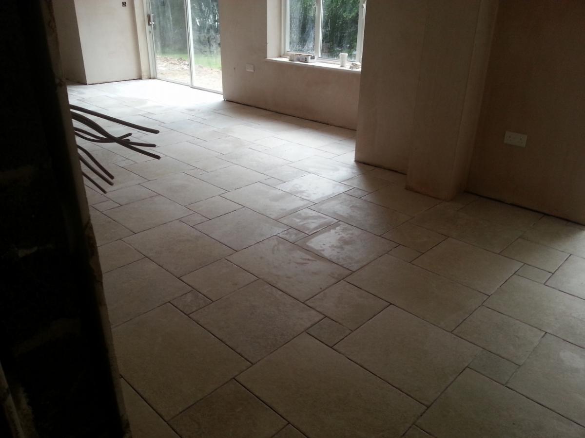

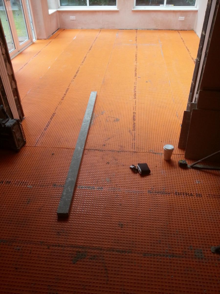

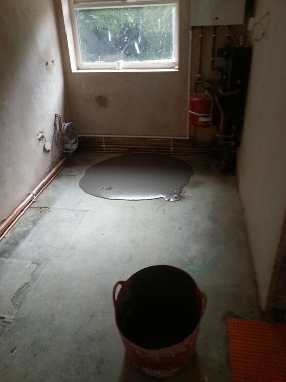

so here is what I did yesterday and today , tiles were already on site the floor was scraped, hoovered , primed and ditra matted the day before , about 75m2 tiled by me and another lad all tiles were back spread and the floor was bedded out with adhesive where needed . started at 9 am finished at 4 the first day started at 8.30am and finished at 5pm this evening and also latexed a small 10m2 utility floor as well , nothing special we didnt rush just worked at a normal pace left the place clean and tidy and put all our waste in the skip. I know tilers like PJC has guys that knock out 60m2 plus a day on their own to a fair standard on shop floors and do this day in and day out

Looks great mate, 2 days is bloody good. I really have to find someone to work with more often, i do 99% of jobs on my own and a floor like that would prob take me about 5 days 'odd'. Not so sure it's working out cost effective for me to keep doing it on my own, yeah i get a bigger lump of money but it is so much graft on your todd, all the washing, tidying, mixing etc takes up so much time. Trying to find a laborer is bloody difficult though.............
