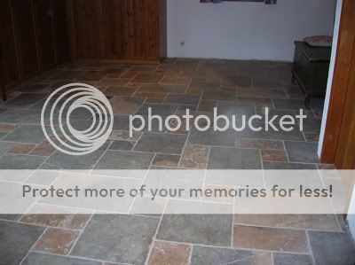

I worked with a professional French tiler laying a very similar limestone opus floor on a wet u/f heating surface in my own house here in France. But please note I am very much an amateur, so I just offer this for what it is worth.
The two rooms were both around 42 m2 (6m x 7m). The floors have been laid with no expansion joints in the floor itself, just round the edges (where they will - eventually) be covered by skirting boards. Despite substantial summer/winter temperature differences over the last two years it has shown no signs of cracking anywhere. Perhaps it is a little early to tell.
Obviously there were no expansion joints in the anhydrite substrate.
