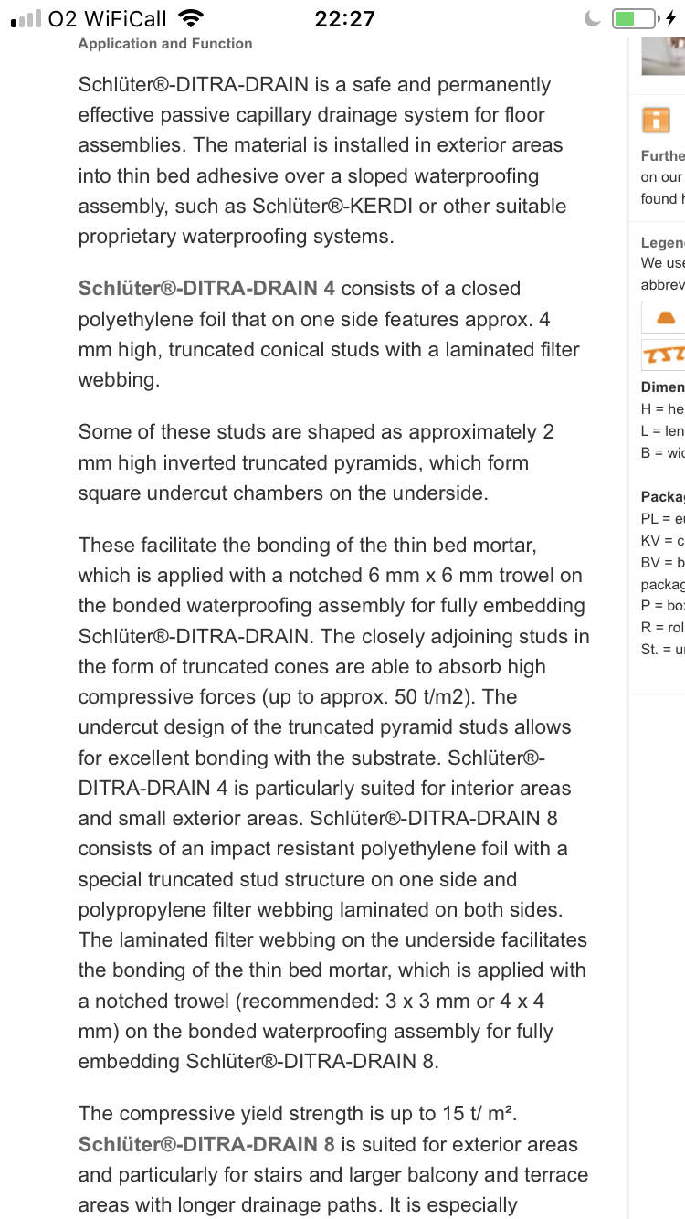

I agree with @hmtiling My conversations with schluter regarding ditra drain on a patio of that size they recomend drain 8 and yes it is good practice .

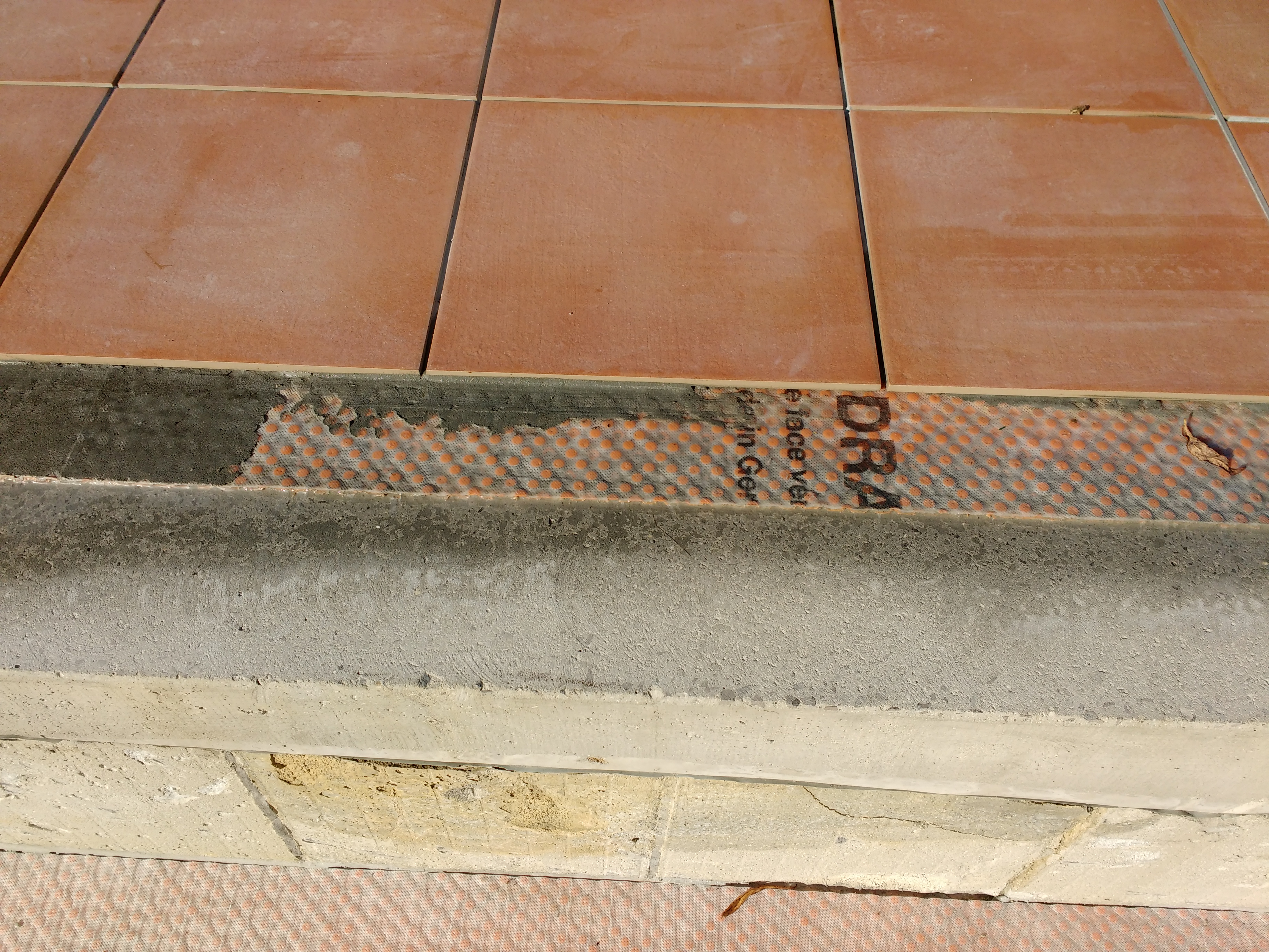

Thought you might like to see that the drainage mat certainly works. It rained here on sunday and the ungrouted terrace got soaked. Two days later water is still seeping out of the exposed lower edge.
I hope it can dry out so that edge can be completed before it rains again.

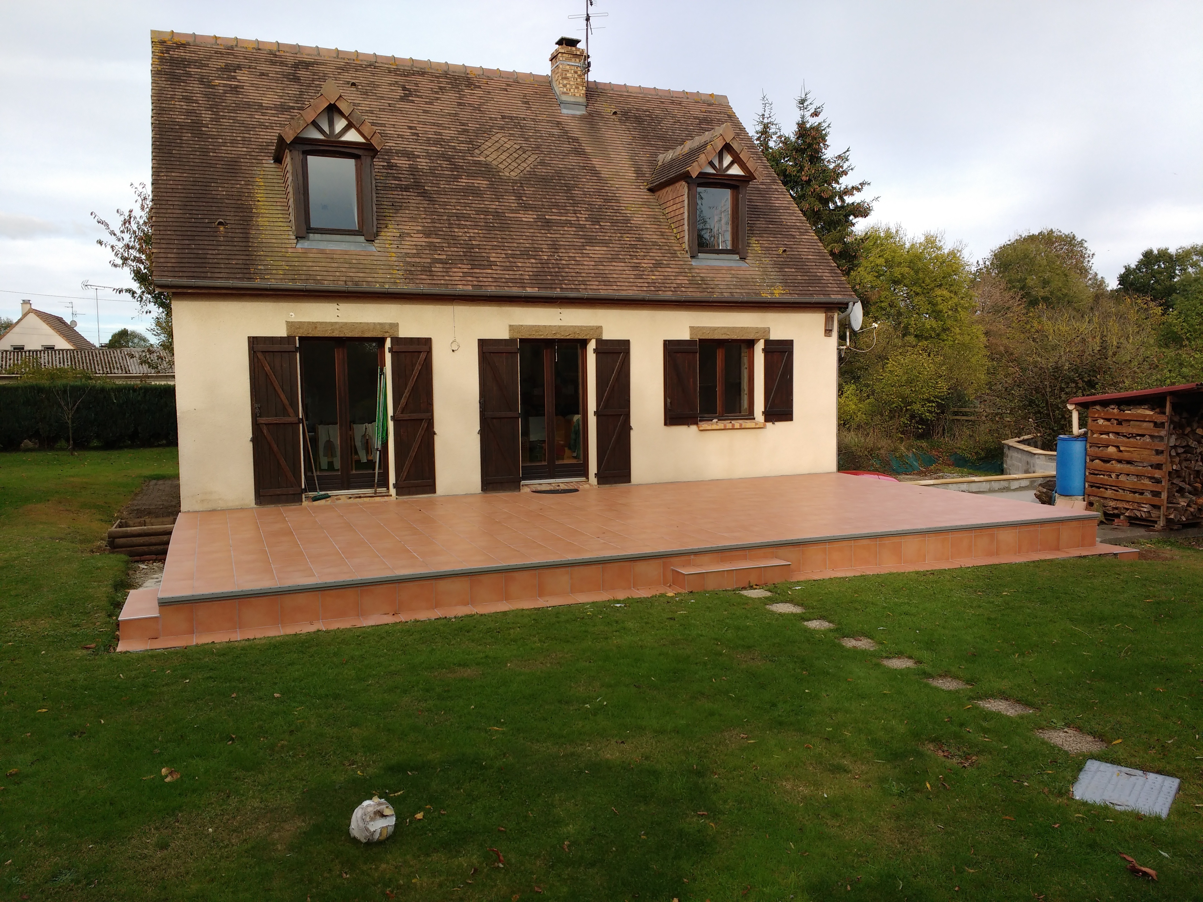

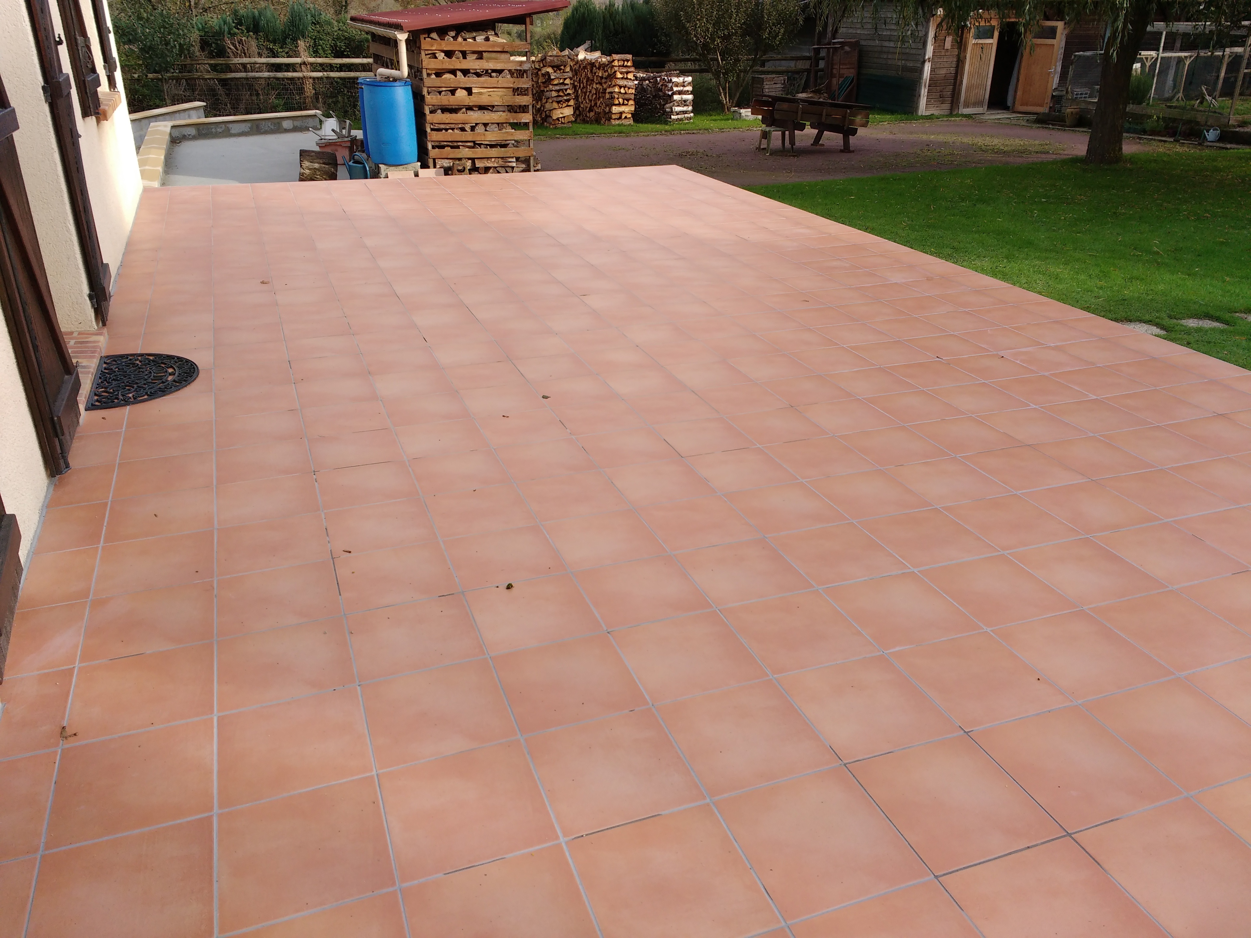

As promised photos of the finished terrace
I need to build up the lawn on the right hand corner and along the left edge and I also want to create a drainage ditch/gully, gravel filled, along the front edge. I would welcome guidance on how wide and how deep that ditch should be.
