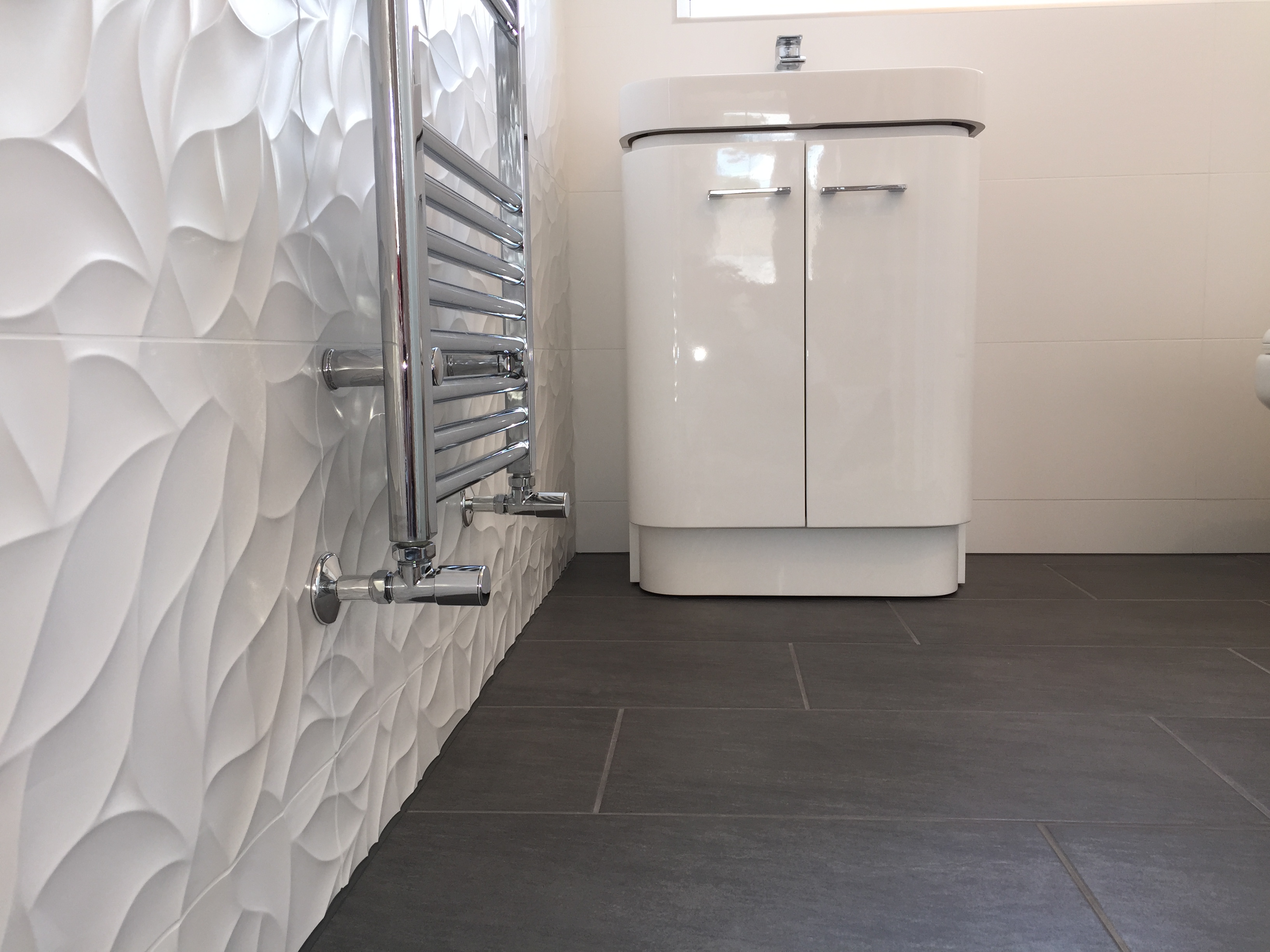

If your main field tiles are a flat tile make sure you fix those first and the feature tile up to them. If you do it the other way round you wail have gaps all over the place, unless you can scribe the tile in!!!
Practice siliconing on offcuts as well prior to the actual finished job. I used masking tape on the pic below as the Fugi finishing tools are no good on this type of tile
I've done loads of Oxo Deco and always dry cut with a Sigma. As John says, just do the Marmi first then the deco. Grout & silicon will sort the rest out.
