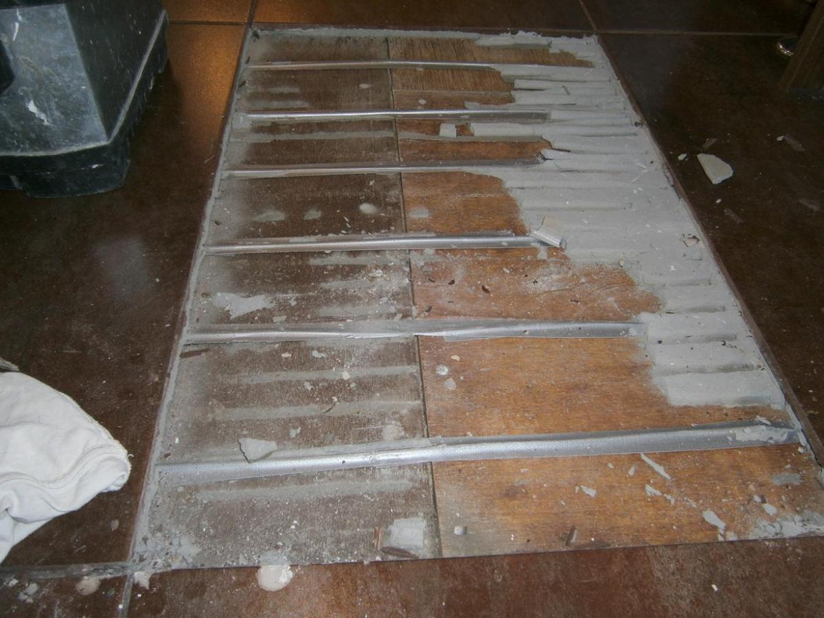

right ive been and had a tile up today, 2 thirds of the floor has cracking grout,one third is fine

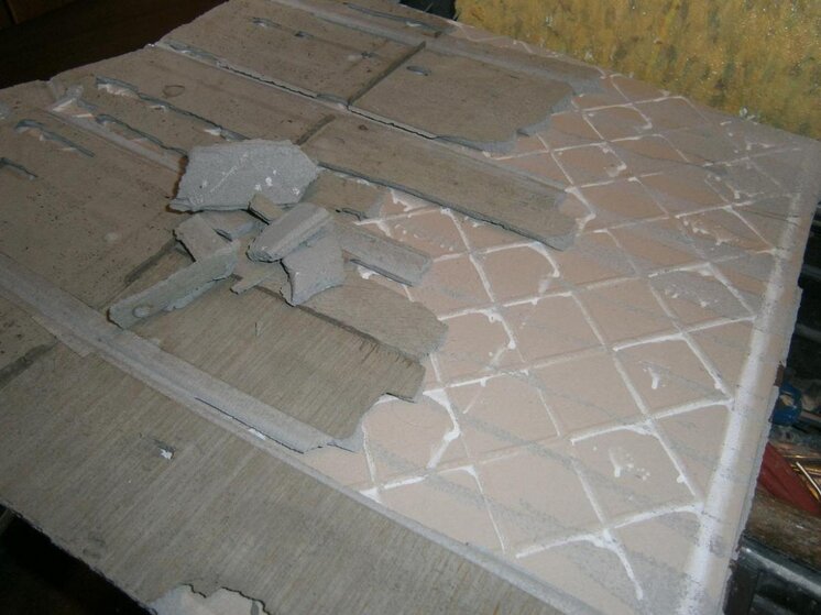

lifted a tile ,which didnt want to come easy[topps rapidset flexi]
i think its movement in the floor ,which i didnt think was as bad when i jumped up and down next to a glass water,when quoting
the addy seems to have come away near ply joints,awway from joints its stuck good on tile and ply,not just one or the other, warmup loose wire ,with their own green primer

Bit of a shame mate. This time check the floor is 100% deflection free, then glue and screw hardie/other cement board, then tile. Also in pic 2 it looks like you haven't back skimmed, make sure you do this time. Oh and take the ply out before all of the above! 🙂
Sent via Tapatalk for iPhone
This is why i do not like tiling direct to ply... too much cheap ply in the uk market and it can leach resin and this results in tiles de-bonding... you can see on pic 2 where the ply grain is embedded into the adhesive but de-bonded.. this is typical of cheap ply and UFH...
IMO you need to use a cement board to get a better bond... cover the UFH in SLC suitable for timber floors and then solid bed fix onto that.. making sure you back skim those tiles as well to create solid bed..

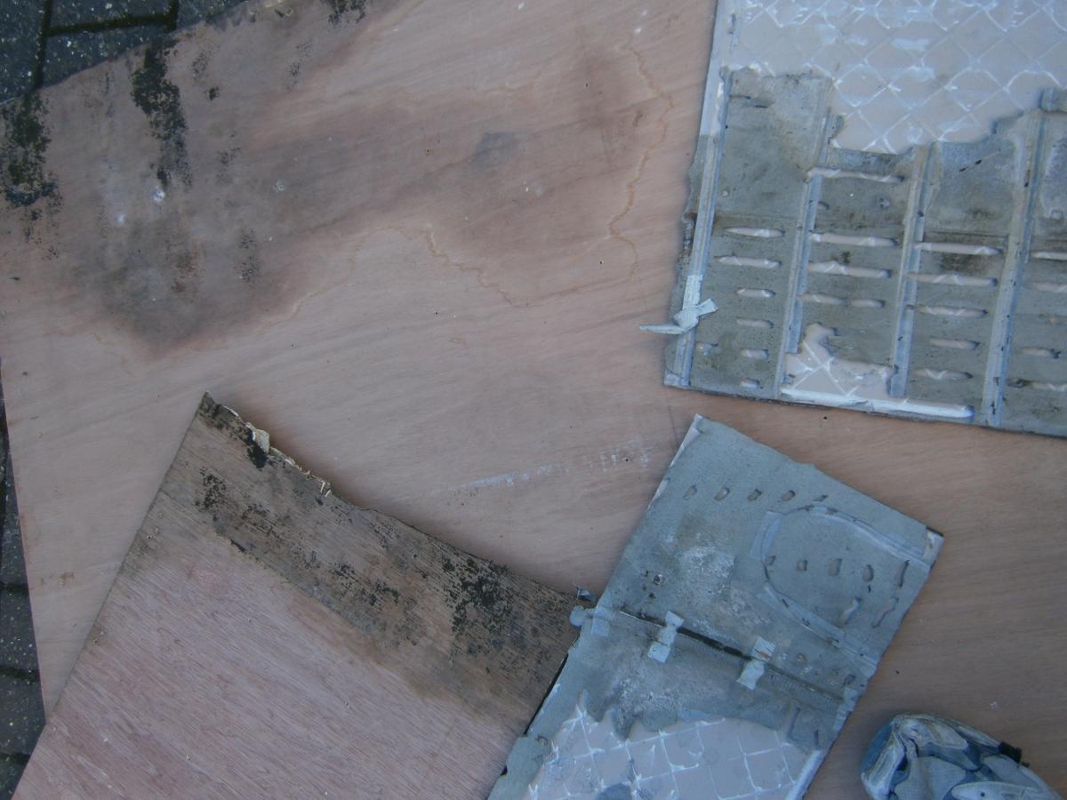

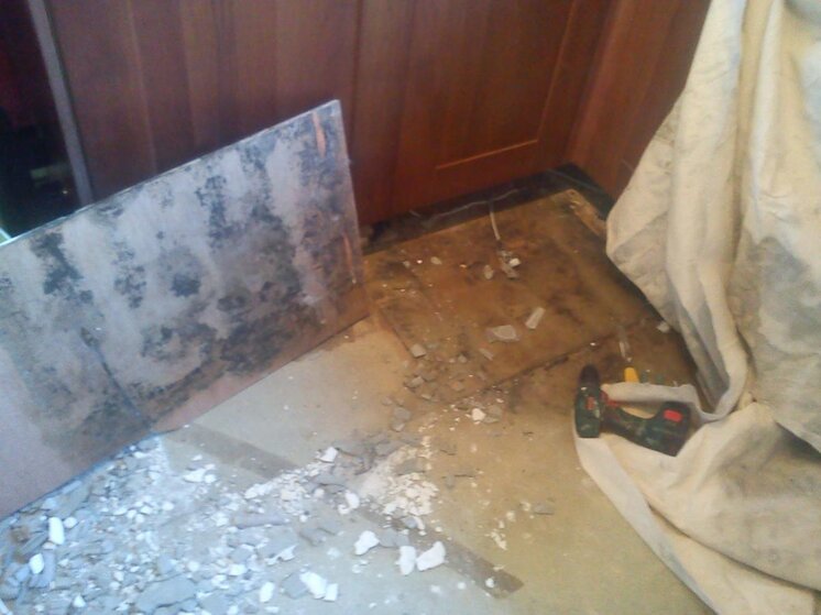

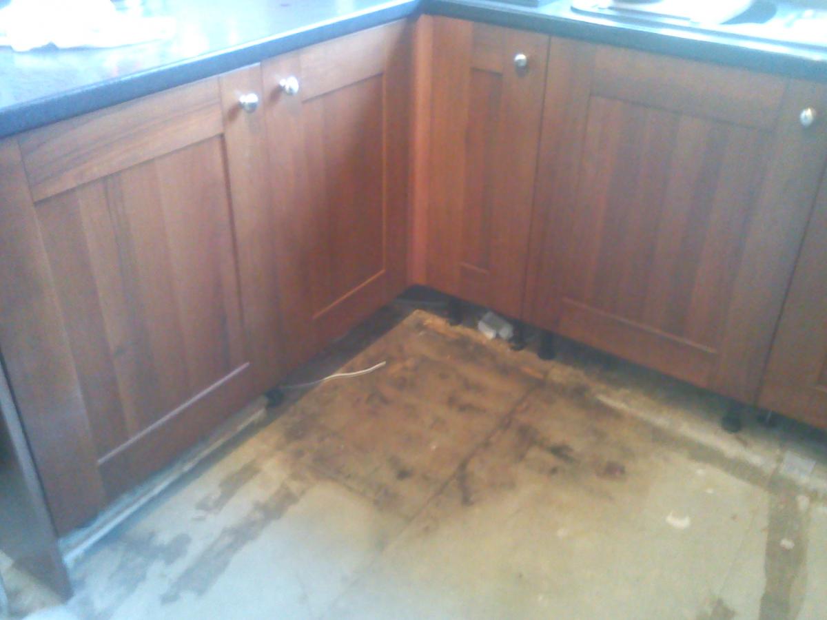

today i went to rip it all up and i found a water damaged area near to where the first cracked grout showed itself
looks like a fair bit of water sat there for a while,but they have told me absoluotly no washing machine or waste pipe leaks,which i find hard to swallow
heres the pics boys, showing underside ply and chipboard
so im not happy to refund all the money,ill contact him tonight

That's defo water damage. I wouldn't refund a penny as this looks to be the main cause. What guarantee did you give the customer on the floor?
Are there any water appliance near by that area. Deffo water damage but you cant say that is the sole reason for failure.
What is worrying to me is that in your first photos it shows tiles removed the floor fairly clean and the tape over the UFH with hardly a mark on it ?
i agree ,thats why i could still owe him but maybe not the full amount,washing machine and sink right there

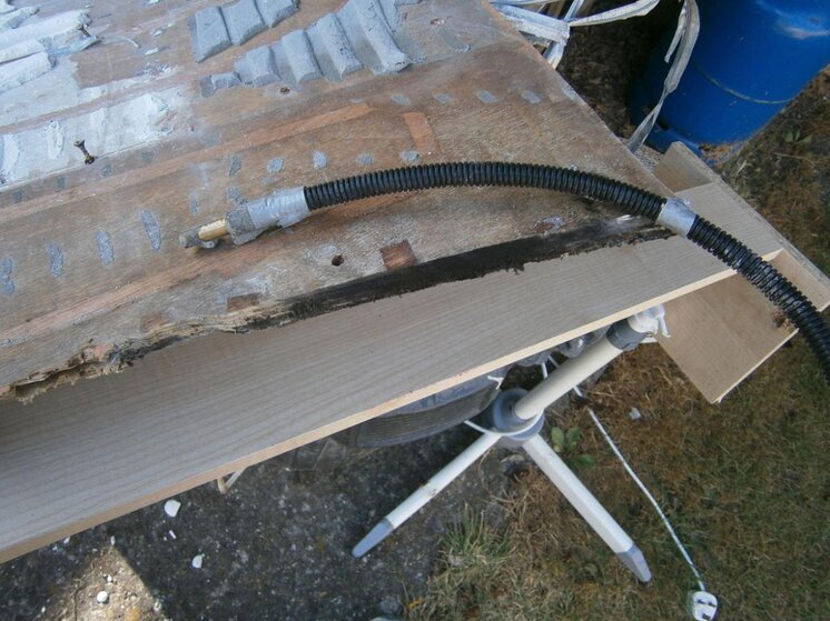

just had another look ,i cut a channel in the ply to recess the probe ,its black as yer hat with mould ,its been sitting in a pool of water
if the leak occurred soon after fixing it wouldnt help
also would the probe give a lower reading in water ,in turn making them raise the temp?
