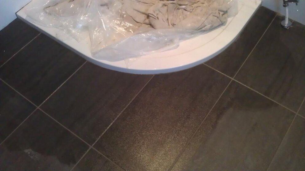

last one was pocelain round shower base.made a template to a perfect fit transfered to tile, used wet cut on strait,then grinder on curve.it took for ever.tile band saw must be the answer

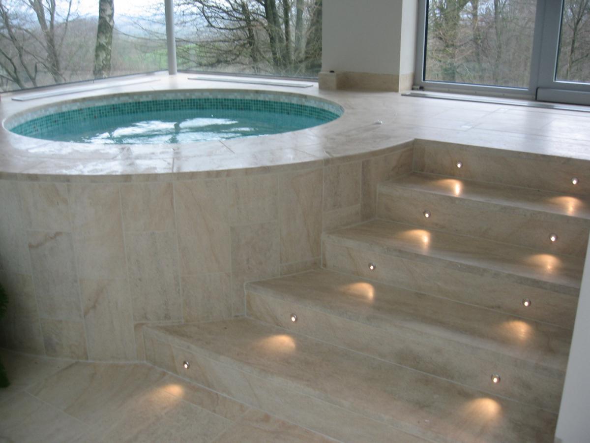

heres some curved cuts done with angle grinder .
made a plywood template first, to radius inside and out of spa.
cut with grinder and then used portable dewalt profiler.
face of vertical wall under outside edge of spa were flat tiles that were then ground and honed to radius of edge detail above.
alot of grinding and polishing but cheaper than solid slab.

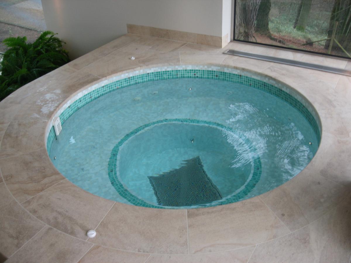

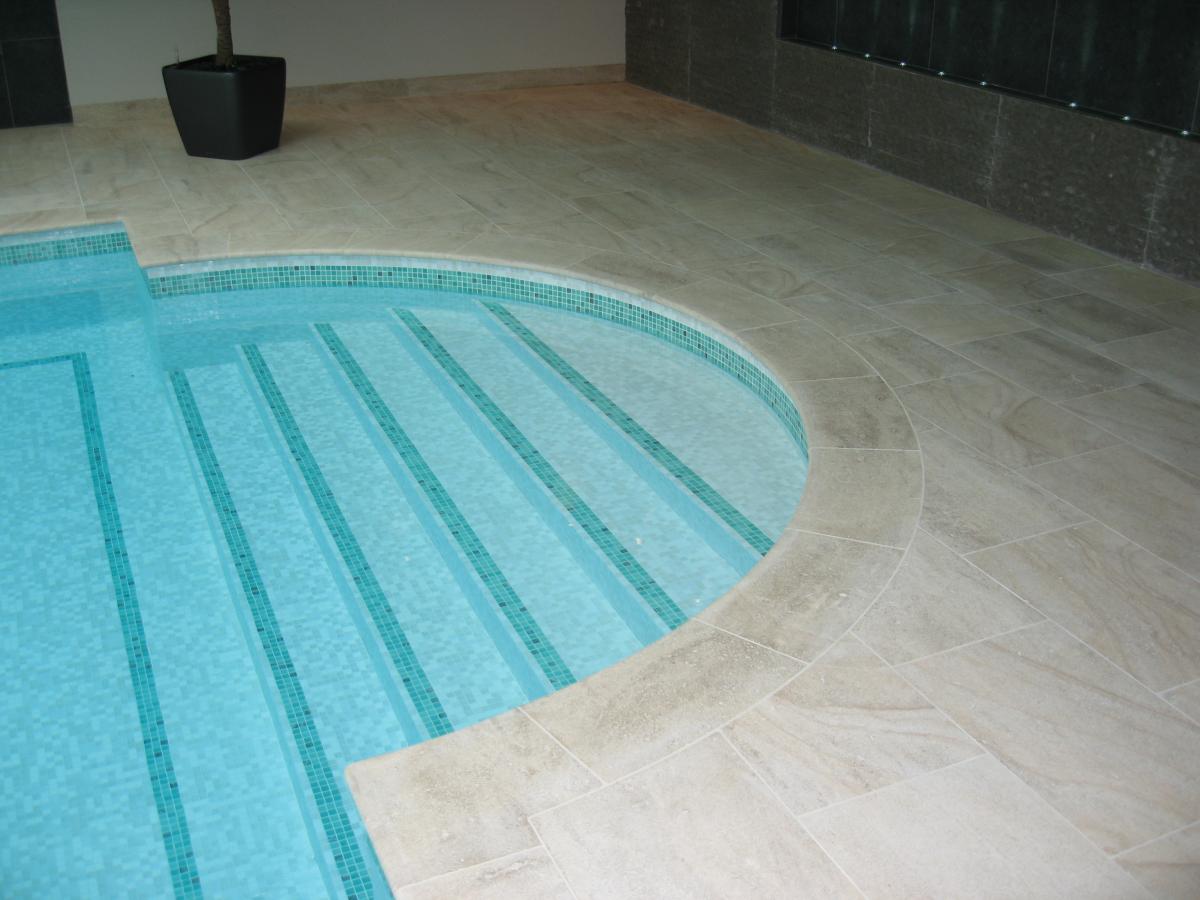

couple more photos of curved cutting.
the coping for pool was done with same portable dewalt router adapted for water. I like these jobs and can do the whole thing on site. just order stone oversized.
