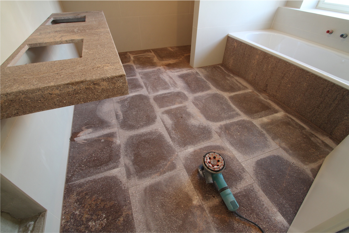

i bought a klindex ufo on stone tec fairy.. it was a good price and i like it. want to grind small rooms and kitchen tops or something. or just can do it and have the tool.

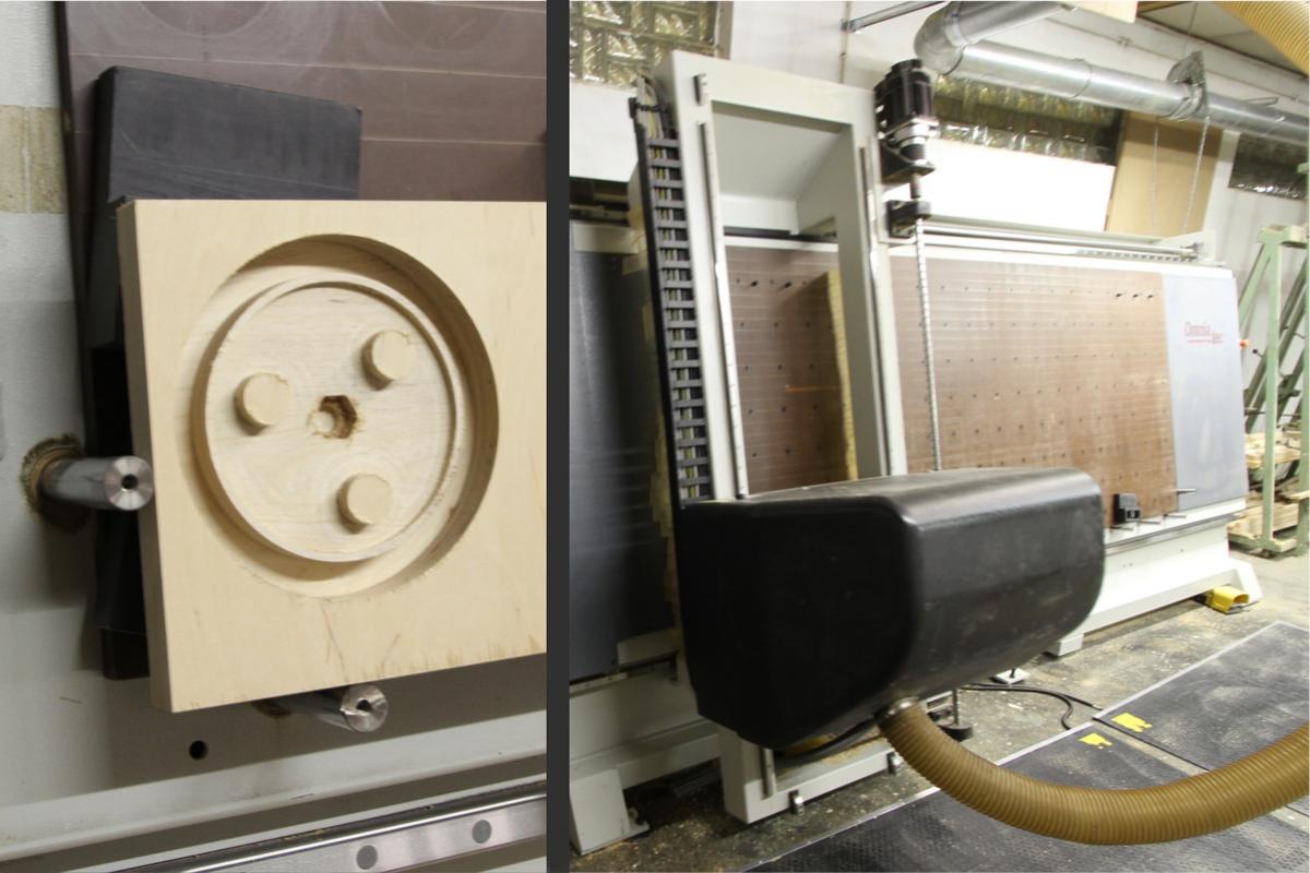

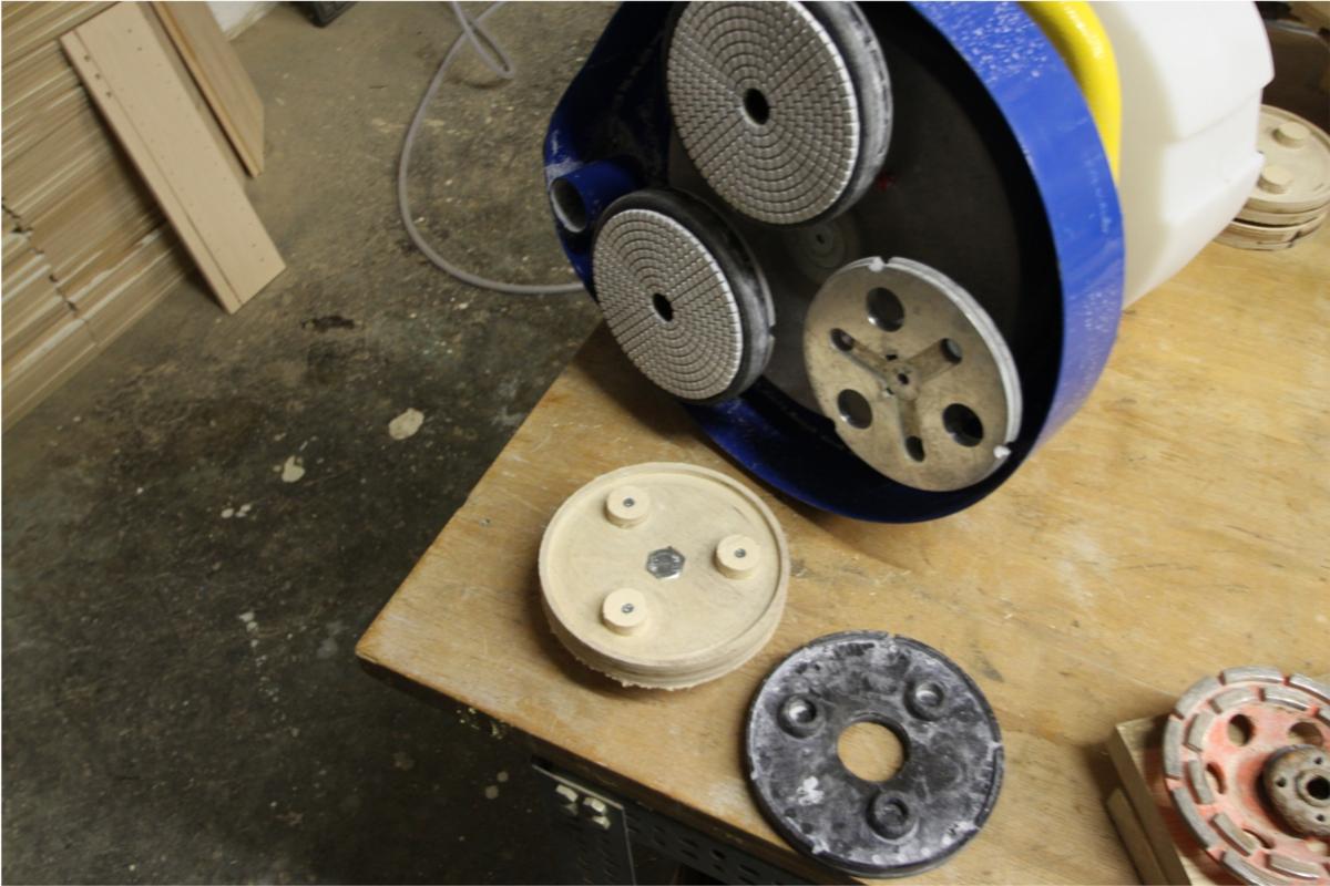

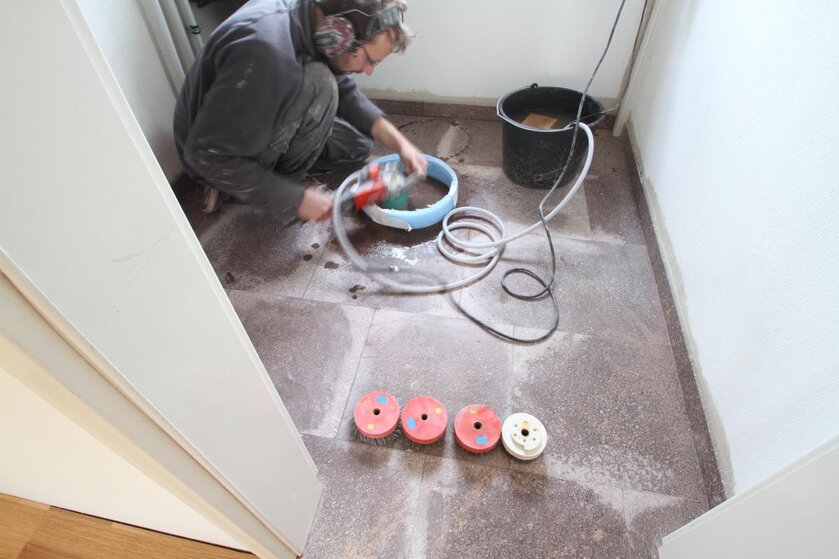

so i have the machine and no tools and the machine has special klindex mounts. so now here are the pics how i solve the problem with my joiner and his CNC.

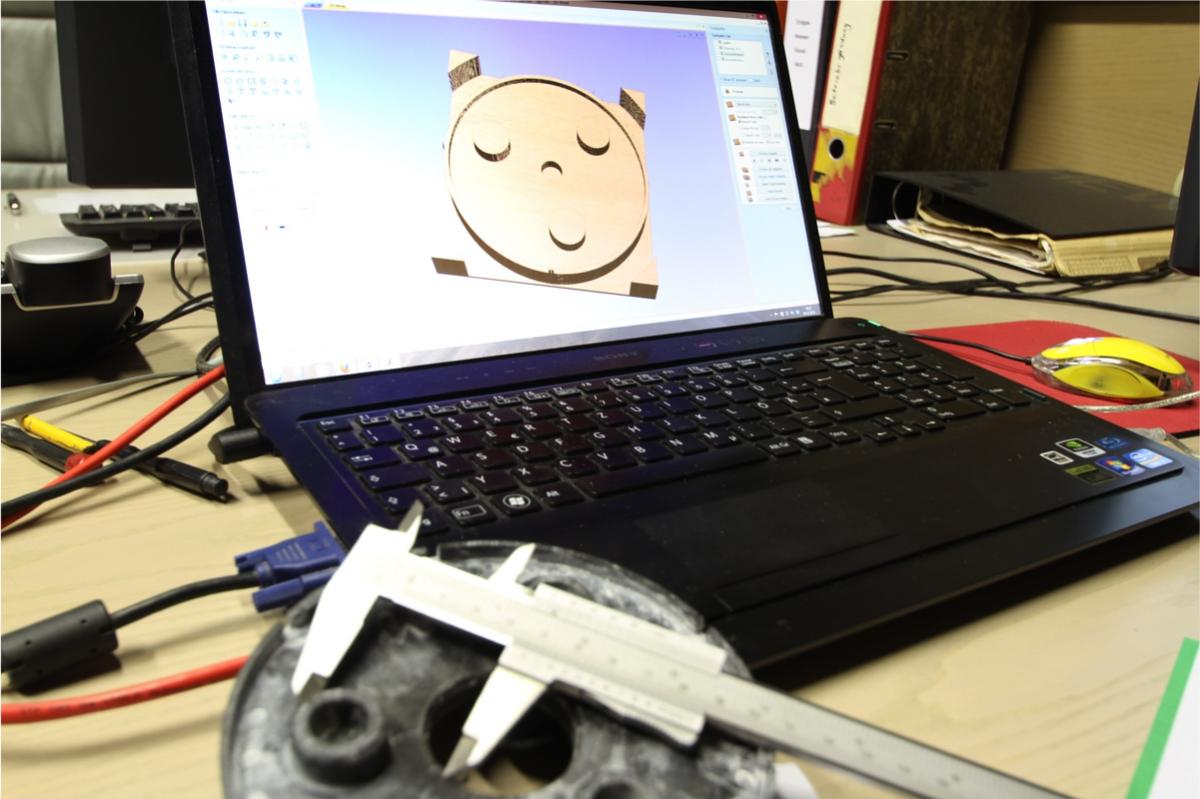

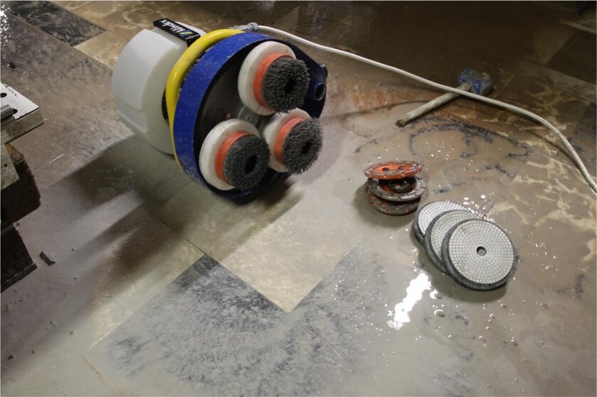

the orginal mounts are just for pads. we make a wooden prototype for a M14 mount. so i can fit cheap grindwheels and cheap brushes. and diamond brushes. there are not available at klindex. (and if, they don´t sell it to me i think, i don´t know why).. so no its no more needet to buy the orginal stuff. i take my good old M14 stuff. .. the final mounts are milled in POM plastik.. works very fine!
