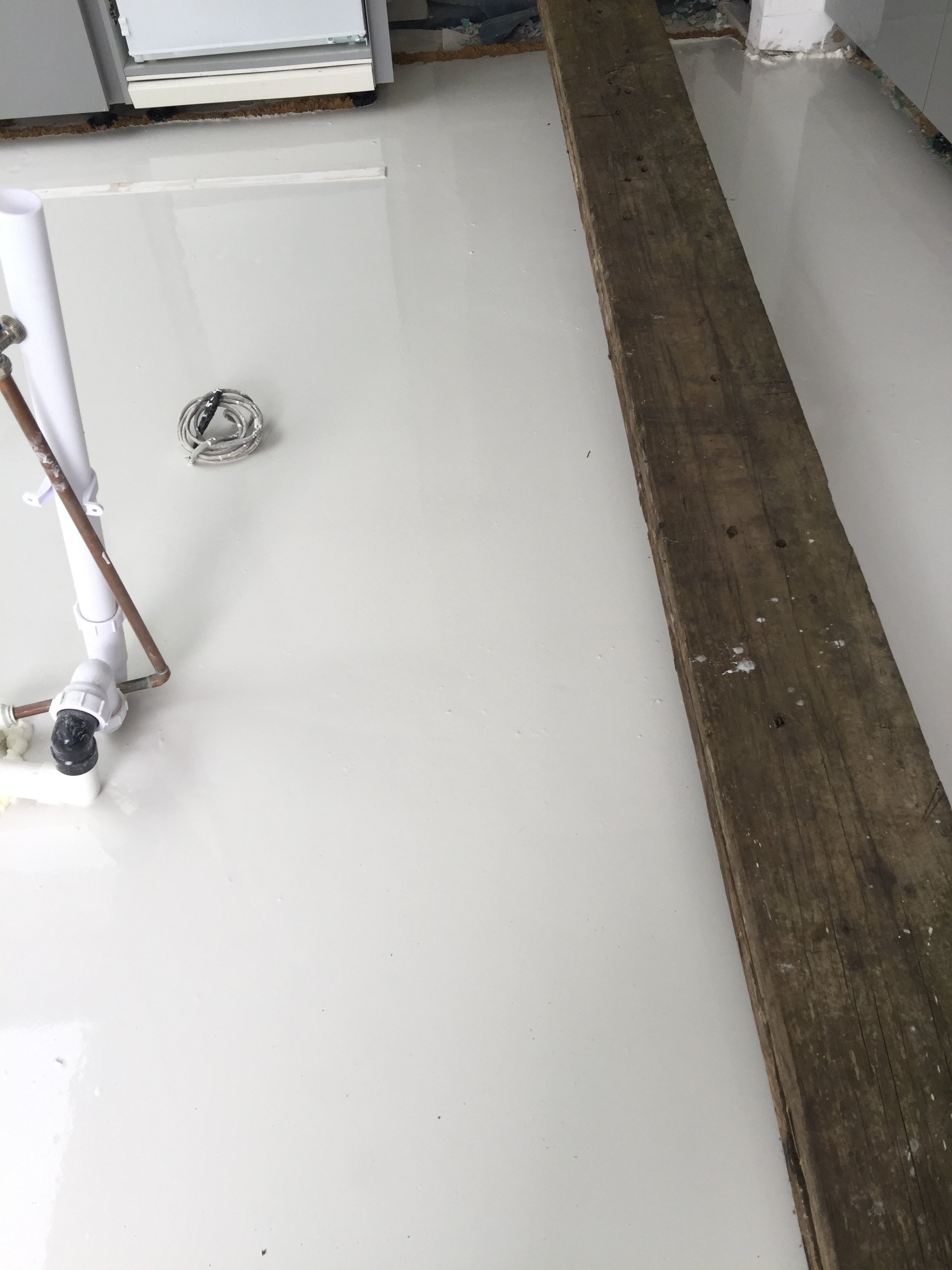

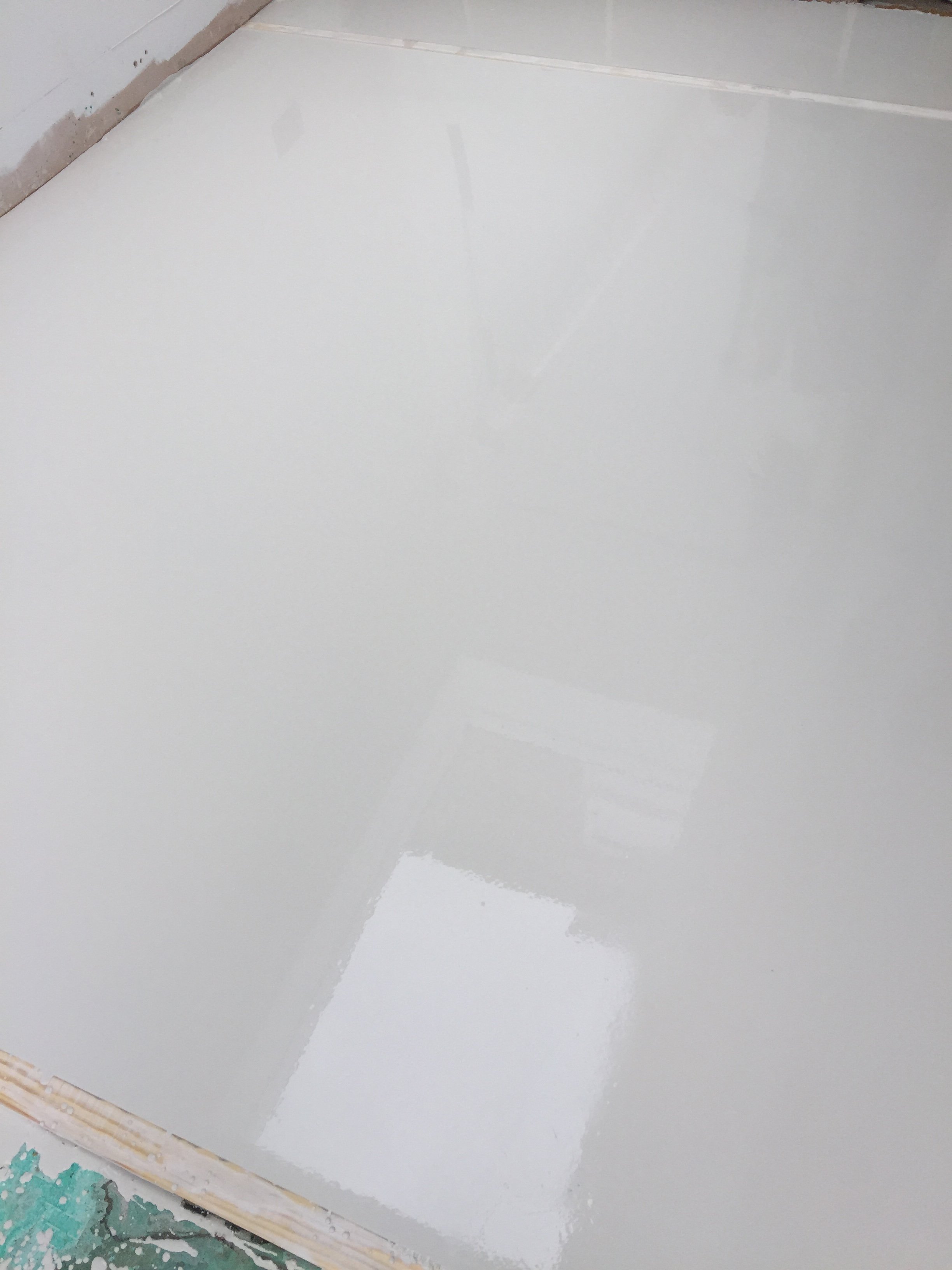

Advice on improving my latexing

I like to mix a minimum of two bags a time if the floor's big enough, I push the poured levelling mix into the corners with a trowel then let it flow back a bit and then tamp it with a straight length of 2 x 1 pse, usually a 5 foot length does it for me.
Do you let the 2 x 1 rest on the ground and pull it or raise it up a bit and pull it?I tried doing that briefly with my spirit level but it didn't seem to work for me very well.
Mate that's the worst screeding advice I've ever heard. It didnt seam to work coz it won't. Sound more like block paving lol
Guy i worked for used to do it like that.His floors were very good.Was the reason i have done so little of it because he always did the latexing.
We're back again to the differences between levelling a floor and smoothing a floor. On a DEEP pour that of which a tiler may have to install this method mentioned by Doug can actually be quite effective. Obviously it wouldn't work on a wash or quick skim so to speak.
No not at all mate
apart from being strickly karndean/amtico install now
I'm also an qualified sports floor installer and I've laid deep comounds in many sports hall averaging 800 m2 plus to take resin sports suraces.
If these aren't level and smooth with in a strict tolerance that's a potential bill of 10s of thousands of pounds.
