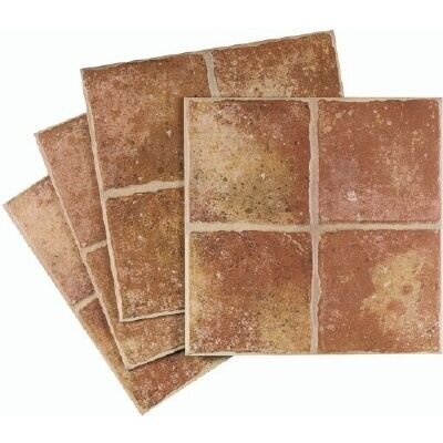

The customer recently purchesed a farm and the existing tiles ceramic had been down over 10 years and did not want them removed i looked at them and they were layed well like stone henge and no movement at all
The tiles are 41x41 from wickes
Now i wanted to confirm a few points the job does not start til 2 weeks time
1, HOW do i match up the grout lines on these tiles as the edges have grout look alike lines if i used 5mm spacers surely wud look out of place?

3mm joints.

Yes Raja 3mm but i think i would be looking to get a coloured grout close to the the edge colour of the tile

test spacers on the middle of the tile, whatever the "fake" join is you need to match!
5mm joins on floors used to be the norm, they will look more out of place if you have 5mm join on the tile and 2/3mm between tiles!

raja,cant you but the tiles against each other?some that type have like a lip on the grout bline and it looks like a 2mm groutline when butted,try it.

sometimes the do have a recessed edge.....however, butting up tiles is not advised.....no room for expansion and contraction.
p.s you will still need to grout, and as i have said before even one of the most flexible grouts on the market "Mapei Ultracolour" is only guarenteed in joins of 2mm up to 20mm......20mm!!!!!!!!!! i would like to see them spacers.....how many would you get in a pack..........10?.....
