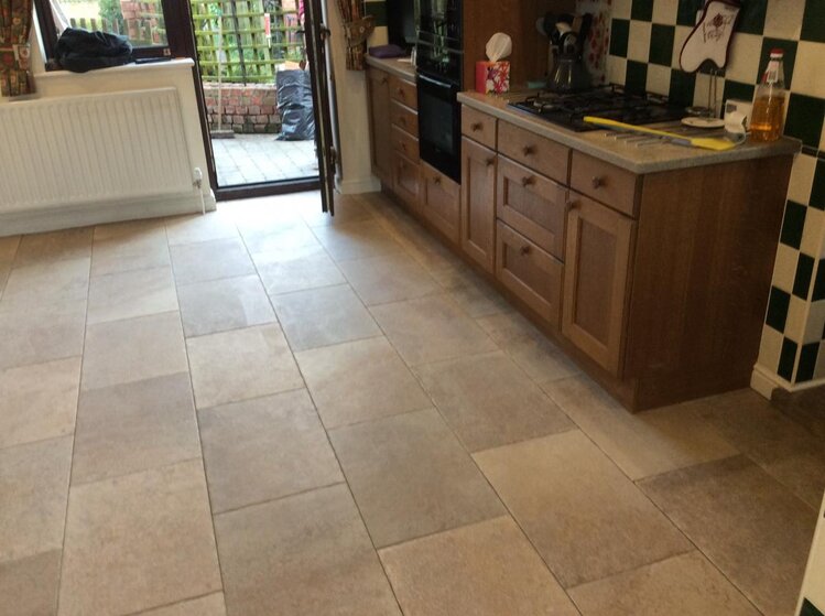

Stripped the old vying out removed plinths and over boarded the floor with ply(I've not used hardibacker yet but ive priced a small en suite with one so until then ive used what I know) screwed at 100mm centres. Laid 22 m2 of 610x330mm porcelain tiles, cut and re fixed the plinths and doors. I've also supplied all tiles adhesives and grout plus the ply. Ive charged £1500 and it's taken 2 days with a labourer.

Good price.
dont mention cutting plinths on here :lol:
Is that 2 days for just fixing the tiles without the other bits involved.
The tiles are £28m2 so total at £616 plus materials so I'm thinking im a little shy on labour?
what size joint is that you used on them tiles ??
Should've offered to redo the walls as well :sofahide:
2mm why?
nothing m8 your the Biulder you know best

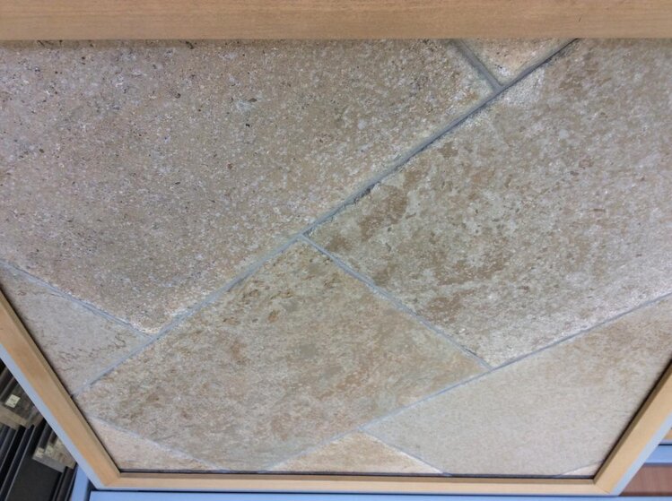

thats helpful, I'll post a pic of the sample board its 3mm at best.
If you've hot any advice I can benefit from im all ears, you're quite right I'm not a tiler so everything's a school day.
