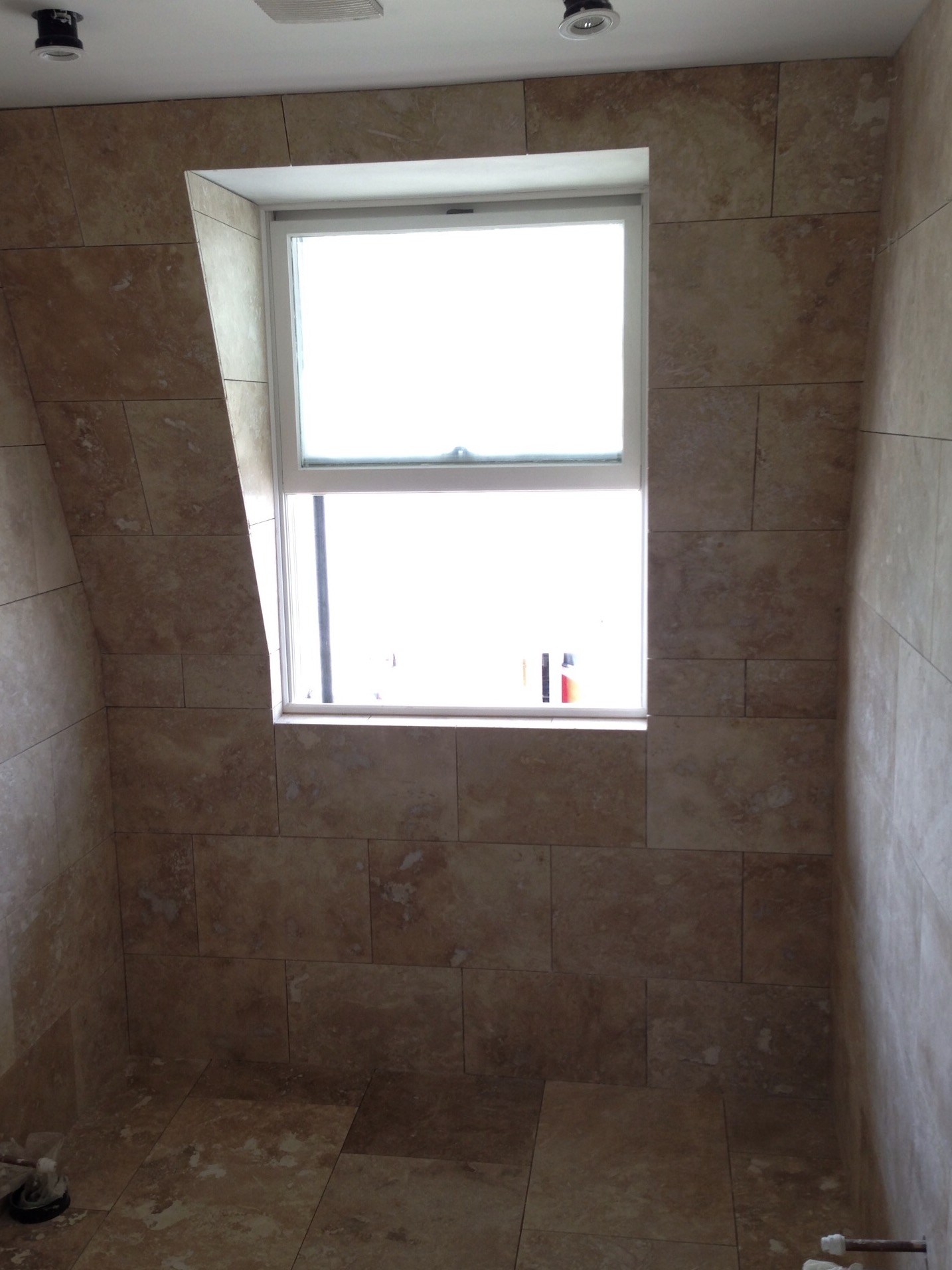

I need opinions on where to start tiling. I'm doing a standard running bond with 300X600 tiles, so like oversized subway tiling.
*Green tiles - cut tiles White tiles - full (uncut) tiles
I want the tiles centered on the window and a full tile where the wall meets the ceiling. This doesn't work well with the height of the window or the height of the room as it leaves a small gap where the wall meets the floor. About 21mm.
The floor tiles are 8.2mm so they will reduce this gap to about 10-11mm.
I've worked all this out with 3mm spacers between all the tiles.
How can I resolve this gap ? Where should I start tiling ?
Need opinions today.
There will be a toilet centered under the window and a wash hand basin to the right.
Thank you so much in advance.
Jim

Can't always have what you want when setting out.
How does your set out work for the rest of the room?
If you can't raise floor or use bigger grout joints then I would be starting 1/2 tile from floor. This will give bigger cuts above bath, still be balanced floor to ceiling, will work with window and allow you to rake your cuts if your floor/ ceiling isn't perfectly level.
jimbob
How's it work taking full tile or three quarter tile off the bath..?
Full tile off bath
The tile above the window sticks out by 5mm either side as the window is 590mm and the tiles are 600mm. Also 74mm tile all around where wall meets ceiling. What do you think.

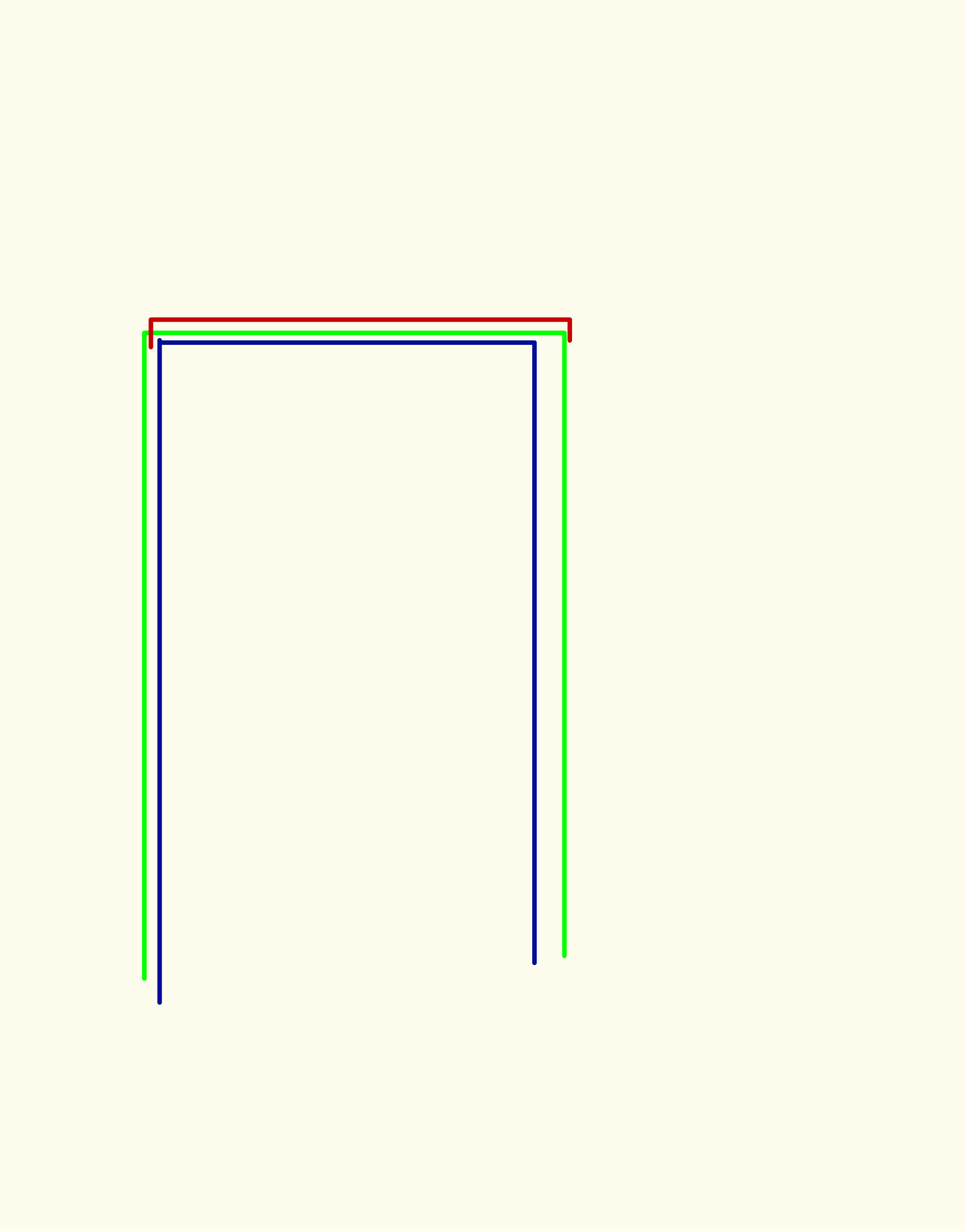

Half tile from floor
much more cut tiles this way and less full (uncut) tiles also have the issue of the tile under the window being 600mm and the window being 590mm so tile sticks out 5mm either side of window.
what do you think?
at the ceiling and move all the tiling downslightly?

If centered on the window both vertically and horizontally
I like this option as it gives about a half tile around the floor and ceiling which looks quite symmetrical but its the issue of the tile above the window again where the tile is wider that the width of the window..
what do you think?
