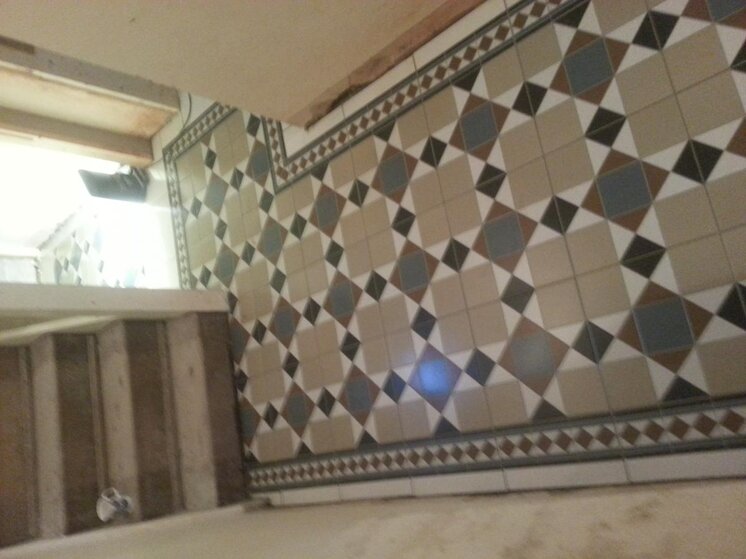

I encountered this with the Topps panel tiles recently and just mitred the borders to form a turn. Creates a double which isn't ideal but 100 times better than their silly infil corner pieces that break the run completely.20141113_142157.jpg
