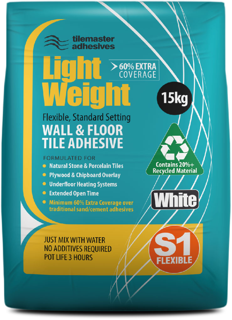

Tried this adhesive today, lovely stuff to work with, 600x300 porcelain on walls notched and back skimmed. Mixed 15kgs bag with 8 litres of water as instructed, very creamy and doddle to trowel. Just wondering with such a large amount of water content is it prone to shrink and be noticeable with 2mm joints? Perhaps someone who uses it a lot can answer as this brand all new to me.
I've not noticed any shrinkage at all but it does stay "green" for a long time. Final bond strength can take a few days, but not an issue unless you are fixing water-sensitive stone.
Never had any shrinkage when using it on walls or floors,Dries quick when using a ceramic tile though.
Very very fluffy. Be carful for skinning over, make sure you mix it as per the instructions
If this is 50% lighter per mt then it should be good for large format ?
