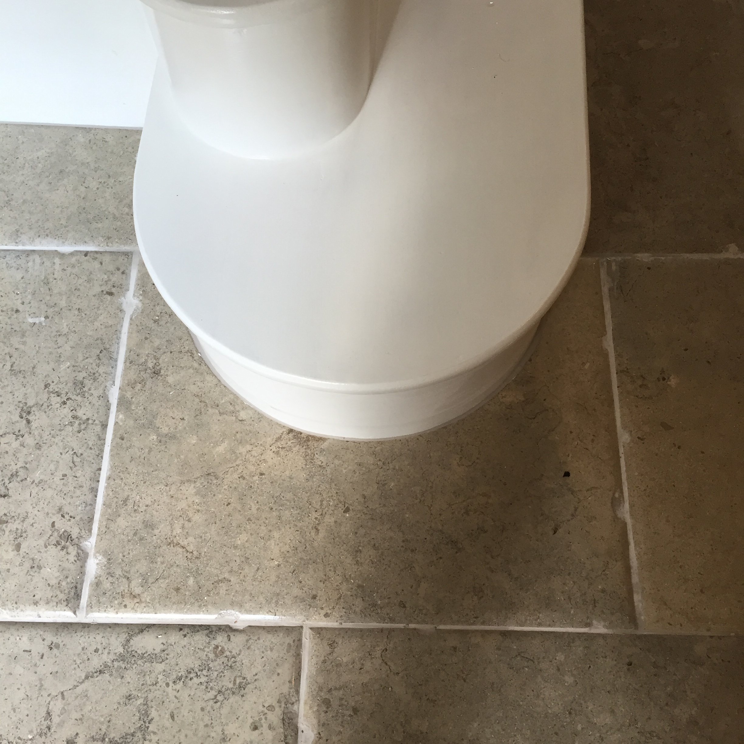

Very smooth edge to cuts.
20mm limestone with an angle grinder and top quality blade = maybe 2or3 mins per cut.
Dewalt, or other decent saw = 30 secs.
Minutes turn to hours, hours turn to days, days turn to lost profits.

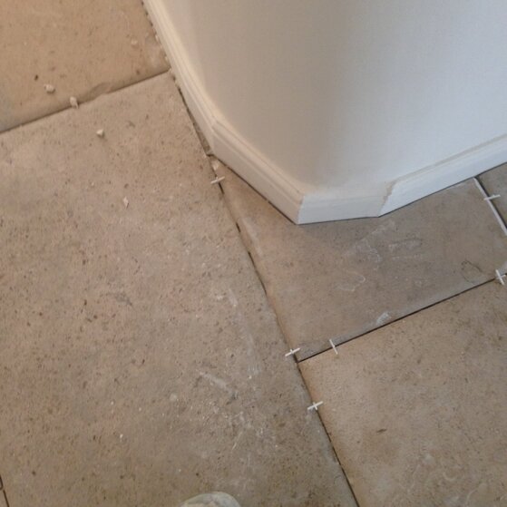

Erm,typically 😉 i find it quicker and more accurate with a grinder on stone .
The house i did recently was around 3/4 foot out of square front to back .
Every room (7 rooms in total) was twisted badly , it would of taken me longer to cut with my machine , i just measured, marked and cut away .
Oh and every blooody skirting was on in every room , and not one wall or skirting straight 🙁
Ps i once saw a thread or post on here years ago saying you should not use wet cutters on stone as you can't lay it wet?
