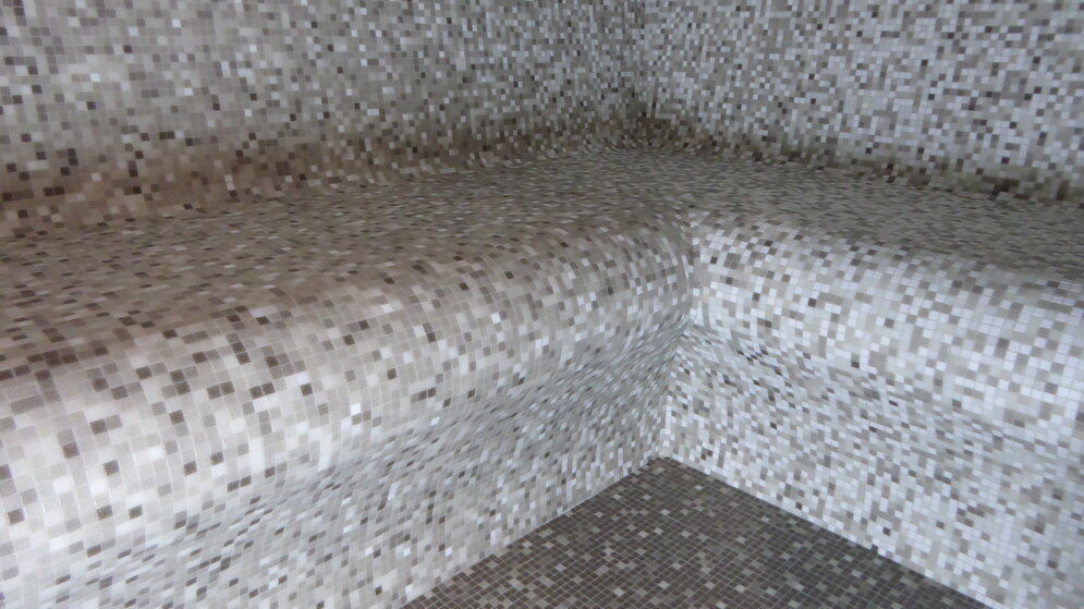

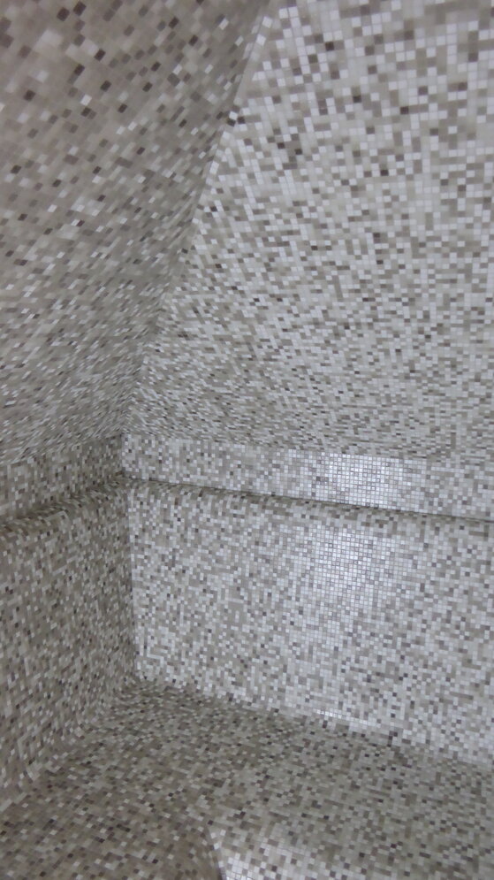

This is a steam room I finished last week and was good fun, small but a tad complicated. The customer had seen a pic of graduated mosaics and took it to Domus and they suggested Bisazza 10mm paperfaced mosaics, bless em lol. With the amount there was there wasnt enough for a vertical blend. With graduated blends where theres seats, angled ceilings etc you get a lot of wastage and you need more of certain sections of the blend for it to match the walls.
I suggested having the graduation running around the room horizontally, with the shower wall that runs into mainly in the darkest blend. I marked out the walls and it was do-able. The contractor and customer let me get on with it. More of the darkest blend had to be ordered. The floor I just left it to the end to see what I had left to play with. The room is made with pre-formed Lux Elements.
