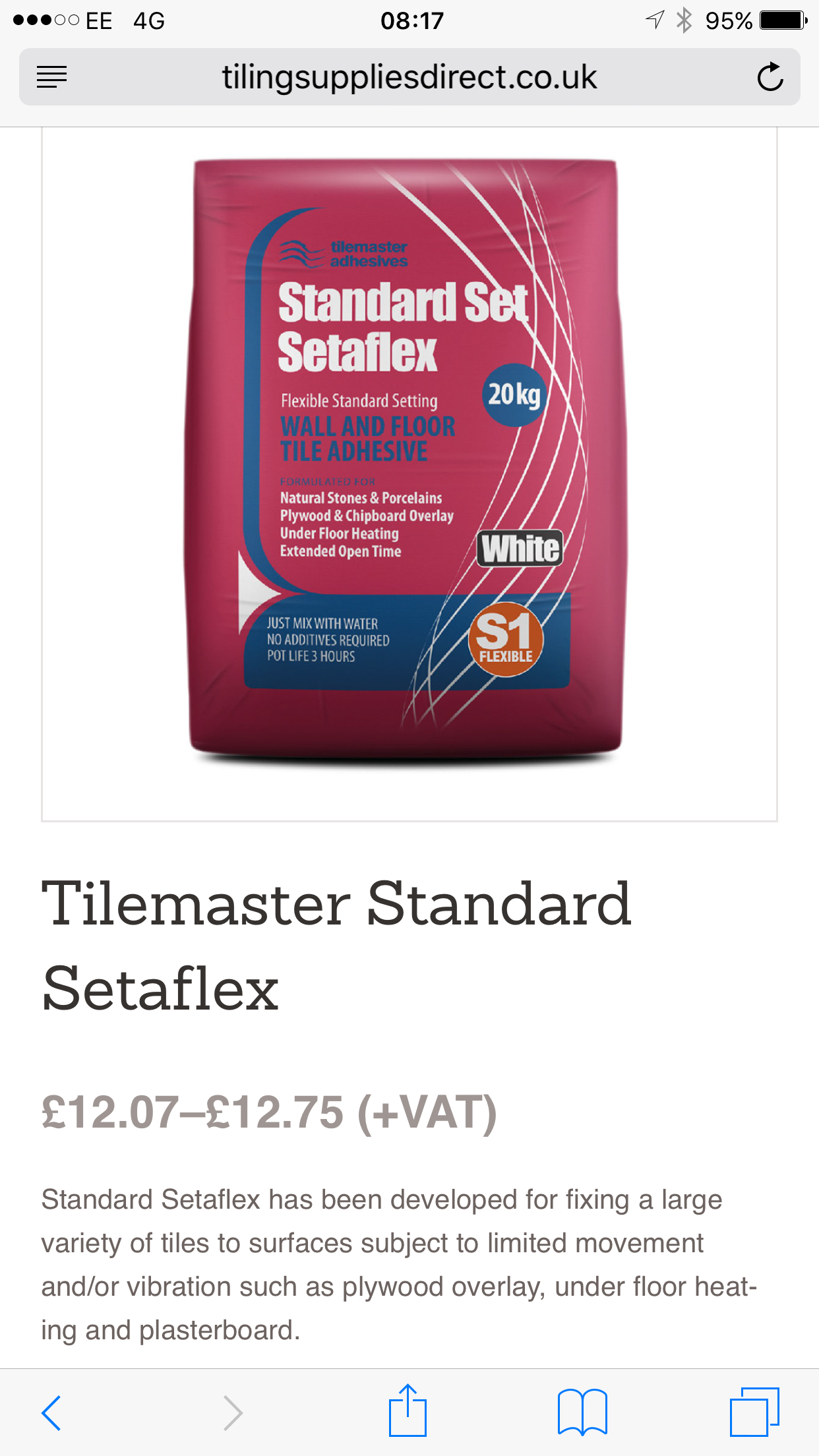

The adhesive would be water resistant if using a cement based and probably work out cheaper in the long run, single part flexible would be a good choice as it gives you more time to work with.
The most economical way and right way would be to use normal plasterboard everywhere, then tank the wet area, ideally before fitting the shower tray so you can tank to the floor. Then tile the whole room using a good flexible slow set powder, such as tilemaster setaflex.

Most decent adhesive is flexible anyway, and a stud wall may have slight movement.
I can recommend tilemaster, as can many on here, good stuff and easy to use and mix.
That helps, so I don't necessarily have to look for 'flexible' on the bag.

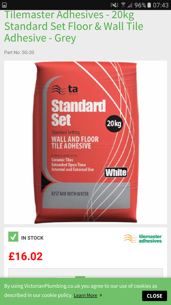

Is the below tilemaster stuff ok, and would it be ok for the floors too? It's standard set, and says it can be used for both walls and floors.
Will be putting ceramic tiles on the walls and porcelain on the floors.
