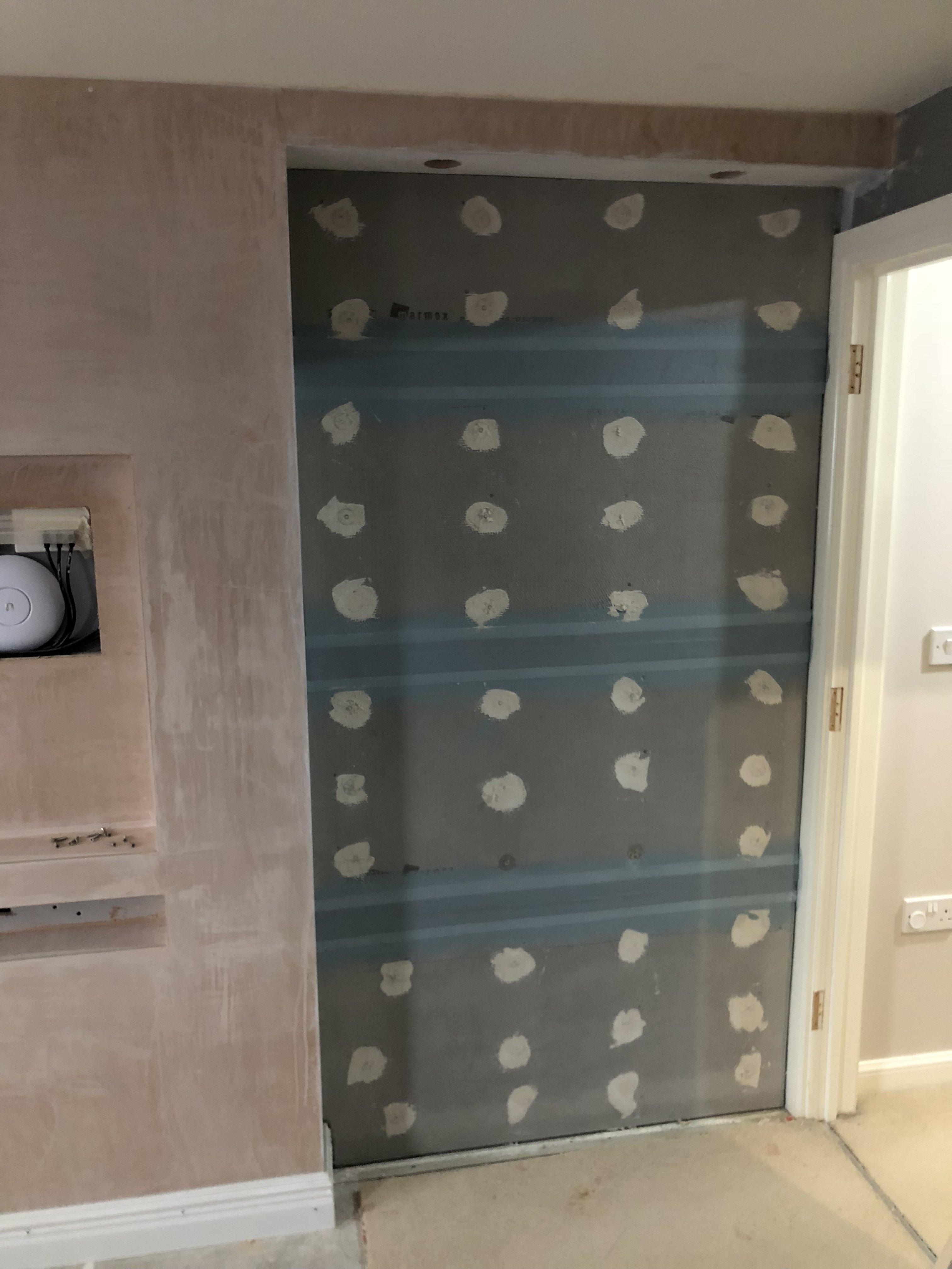

4mm Marmox boards are up, stuck and mechanically fixed!
Thank you all for your views on this
B613E6A0-AA4B-46EE-ACE9-917BB3D092D8.jpeg 4502D3C5-D8A4-49CA-A994-213447EE4F82.jpeg
Hi again everyone, final question on this project I think... the tiler left an expansion gap either side of the tiled area, is it okay to caulk the gap before painting the adjacent wall or do I need to leave the gap?
I would recommend caulking the joint and then cut in with paint when dry. I’d use a quality caulk though, something like Den Braven or Geocel.
