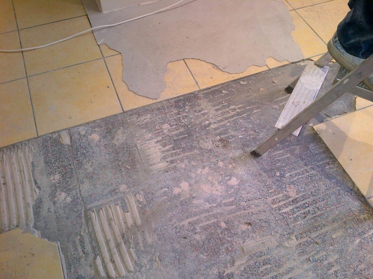

Got a guy who has bought some Wickes SLC and has laid it over existing ceramic glazed tiles. The SLC has not adhered to the tiles and is lifting in sheets. There are 2 layers, down, of tiles and its on a concrete floor. I dont know what type of SLC whether it was a polymer enhanced one or not at the moment. I was going suggest a UBA/ Acrylic slurry coat over the existing tiles then then a fibre reinforced SLC. Any other suggestions?

The existing tiles need to be removed IMO..
The substrate looks dark, any idea what it is.? or is it maybe just a bitumen adhesive residue..?
The way it was done was wrong... so prep right and it will be much better...
Also for those that do SLC over substrates that are normally not straight forward to adhere to, then try Mapei eco-prim grip.. Broken Link Removed

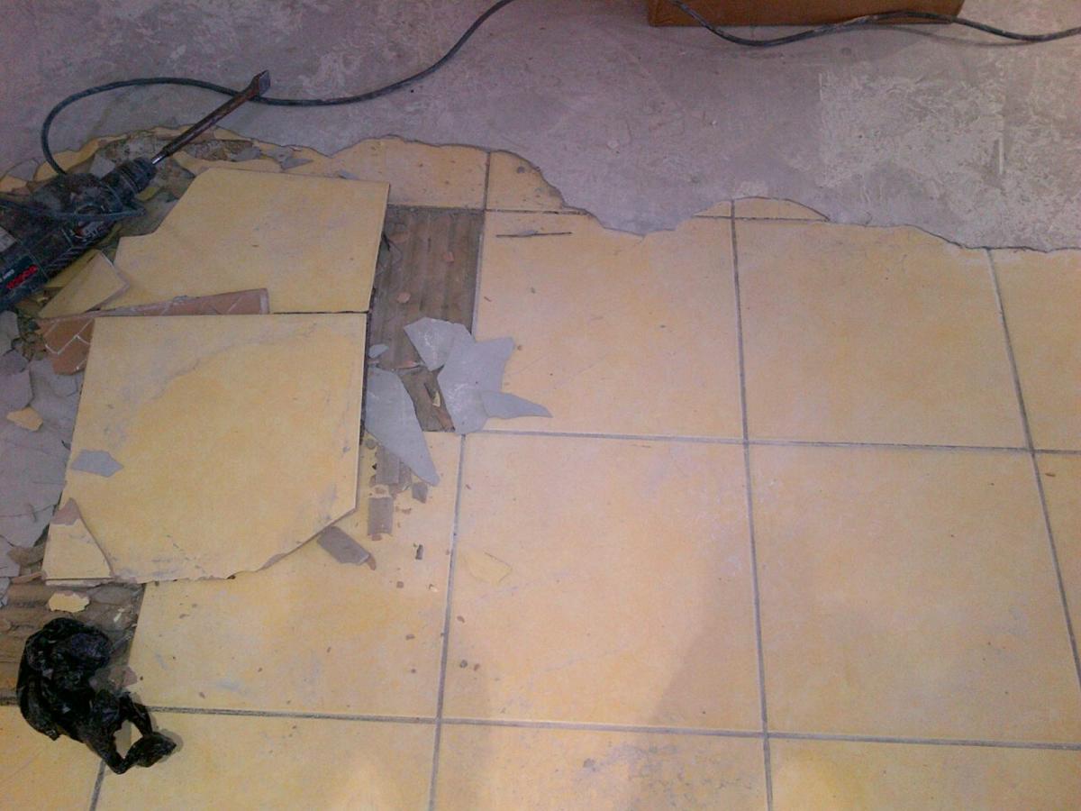

Its the normal thing Dave. People want to do it QUICK but when it goes pear shaped they dump their problems on mr tile shop. They have SLC'd over existing tiles and it has come away. Ive just looked and they havent even cleaned the floor b4 they applied the SLC. Its in a hairdressers and theres hair stuck under the SLC! Tiles are firm. The black stuff is old terrazzo that they tiled on to 15 yrs ago. They want to SLC to lay rolled vinyl in the morning!IMG_0159.jpg
Mad innit...
Needs to be slurry coat then, and tiles cleaned first... or cleaned and a 2 part slc used..
Leave old terazzo tiles on floor, remove all tiles, clean the floor.
Apply mapei eco primer T with paint roller wait over night,put at least 3mm mapei latex plan than lay your vinly following day
PS: check old terazzo tiles after you have remove tiles if there is any movement on them you will need to remove them too

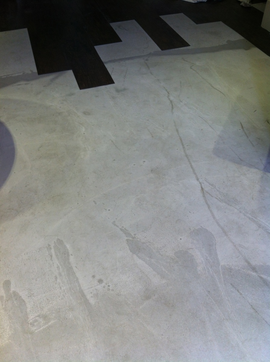

Now finished. Customer used the Mapei eco primer, recommended by Dave and he said was spot on (Like something to a blanket, were the words i think!) . Took a couple of finished shots. Not the best levelling skills by the guy but he was happy with it.
Larsen SLC 1550 and Mapei Eco Primer
