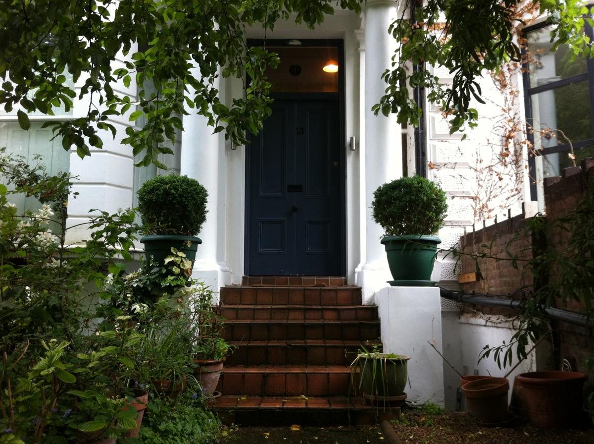

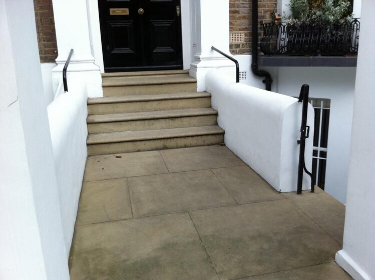

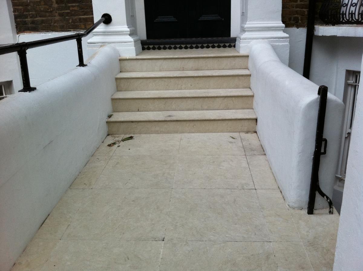

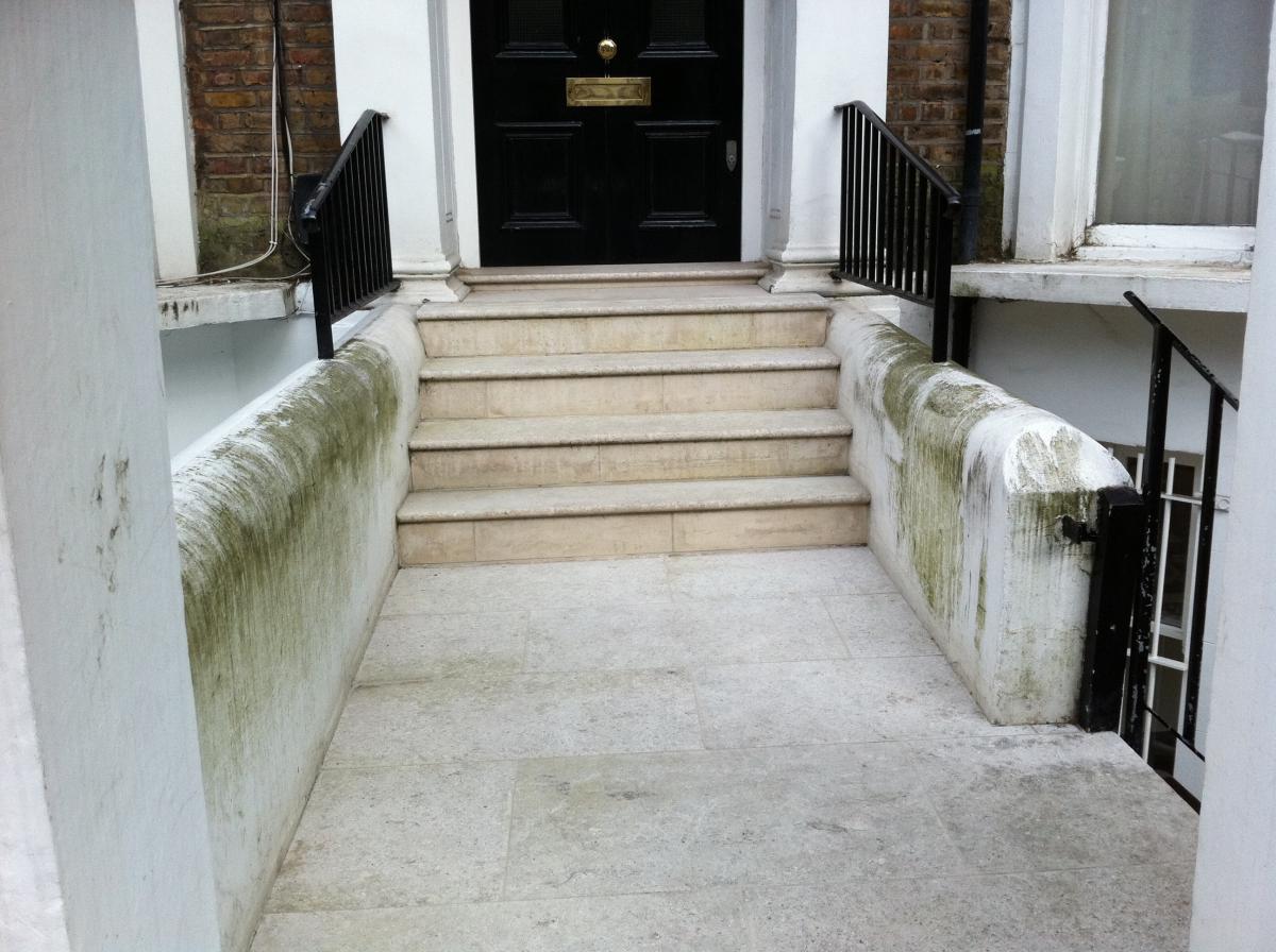

Here are a couple of examples of neighbour's houses that I quite like:
