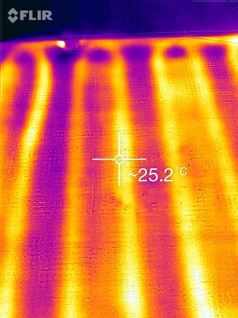

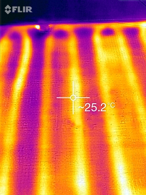

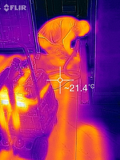

First thing to overcome was locating ufh pipes so we can safely cut away joints and remove tiles.
Solution, thermal imaging camera.
Pipes located without too much problem.

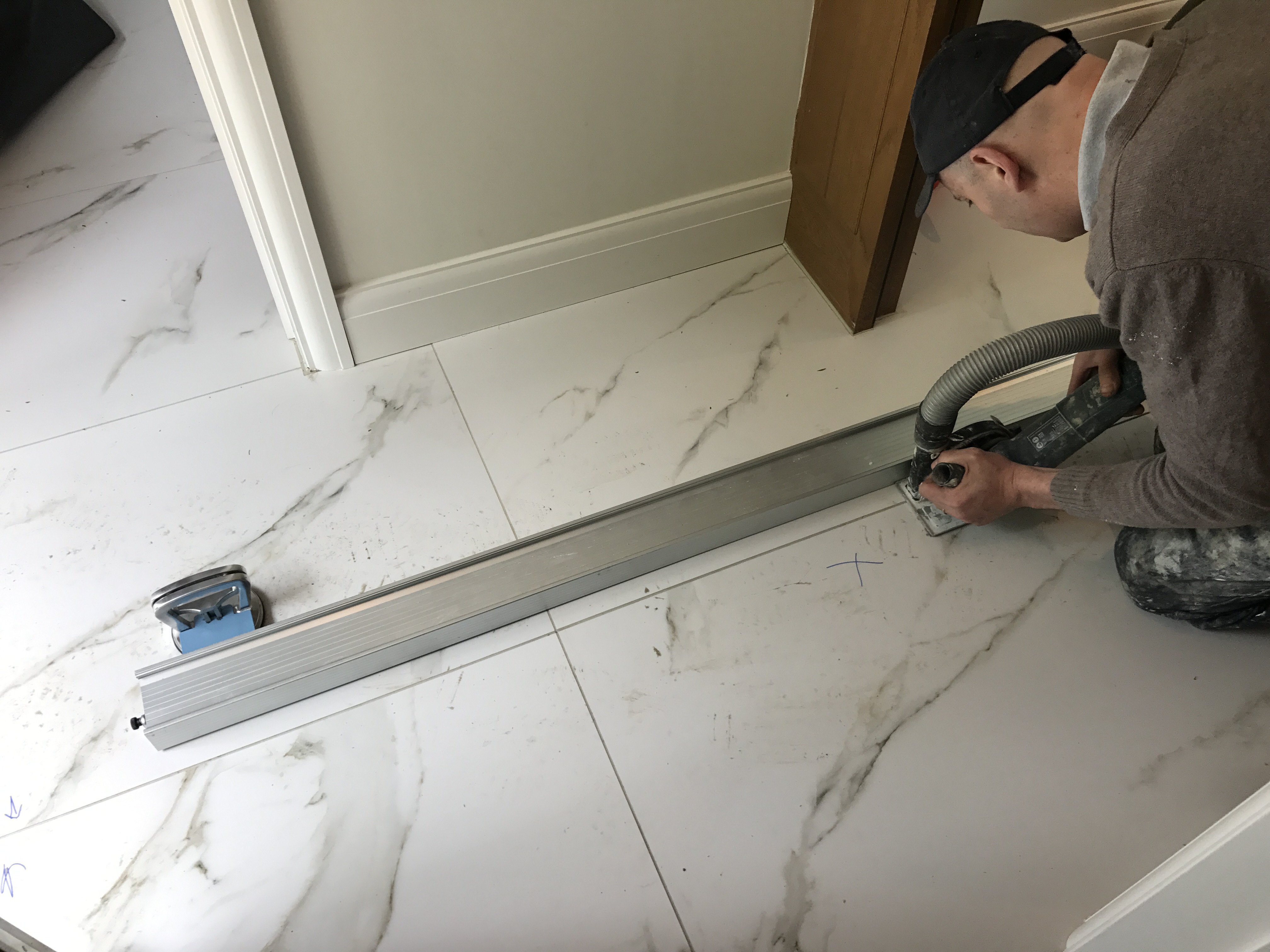

Then we needed a way of cutting the joints open to free the tile from the rest of the field so that when we chop it out, it doesn't effect the tiles around it.
It seems we found a new use for the sigma Kerra Cut! 🙂
Securing the guide rail to the floor we used it as a fence to run a grinder, with a variable depth shroud on it to cut away the joints.
The blade was set for the exact thickness of the tile.

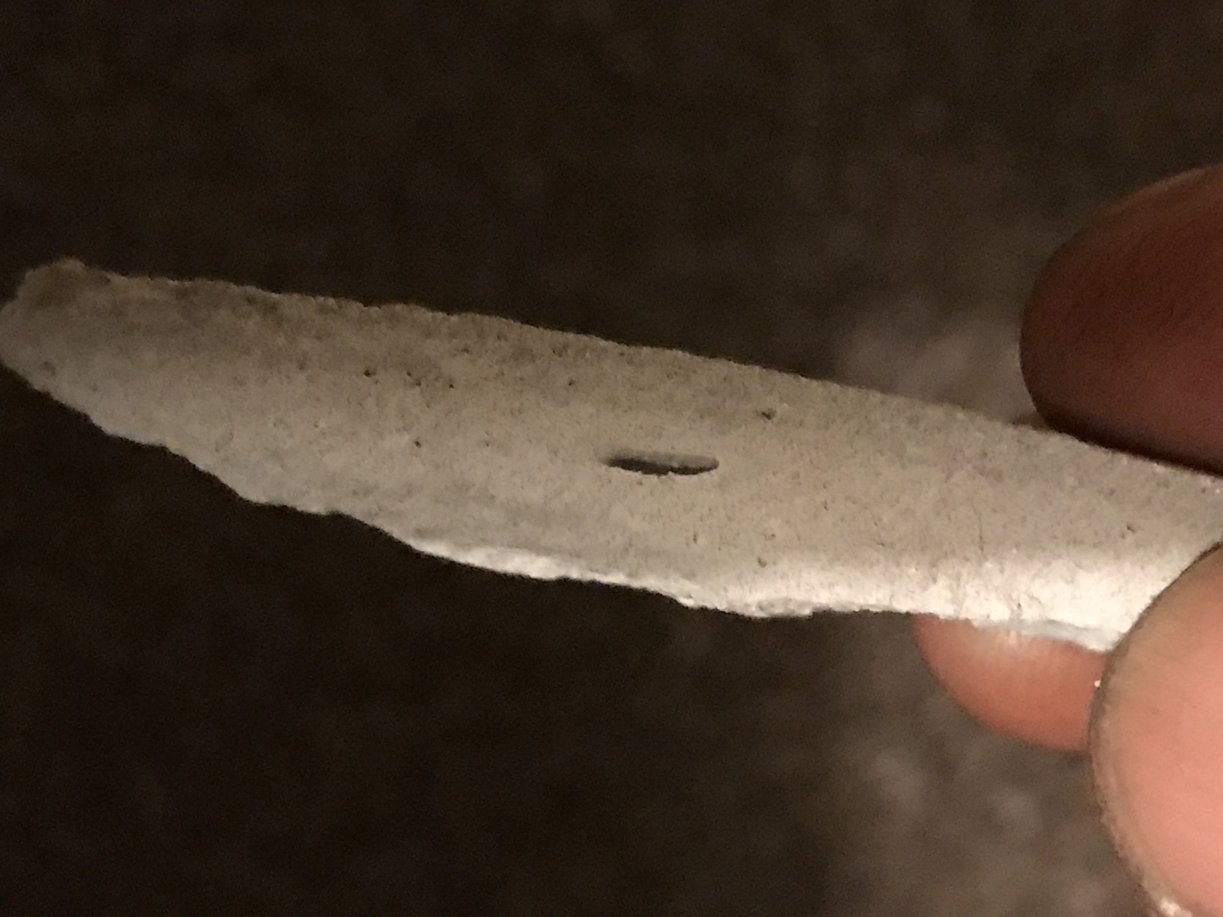

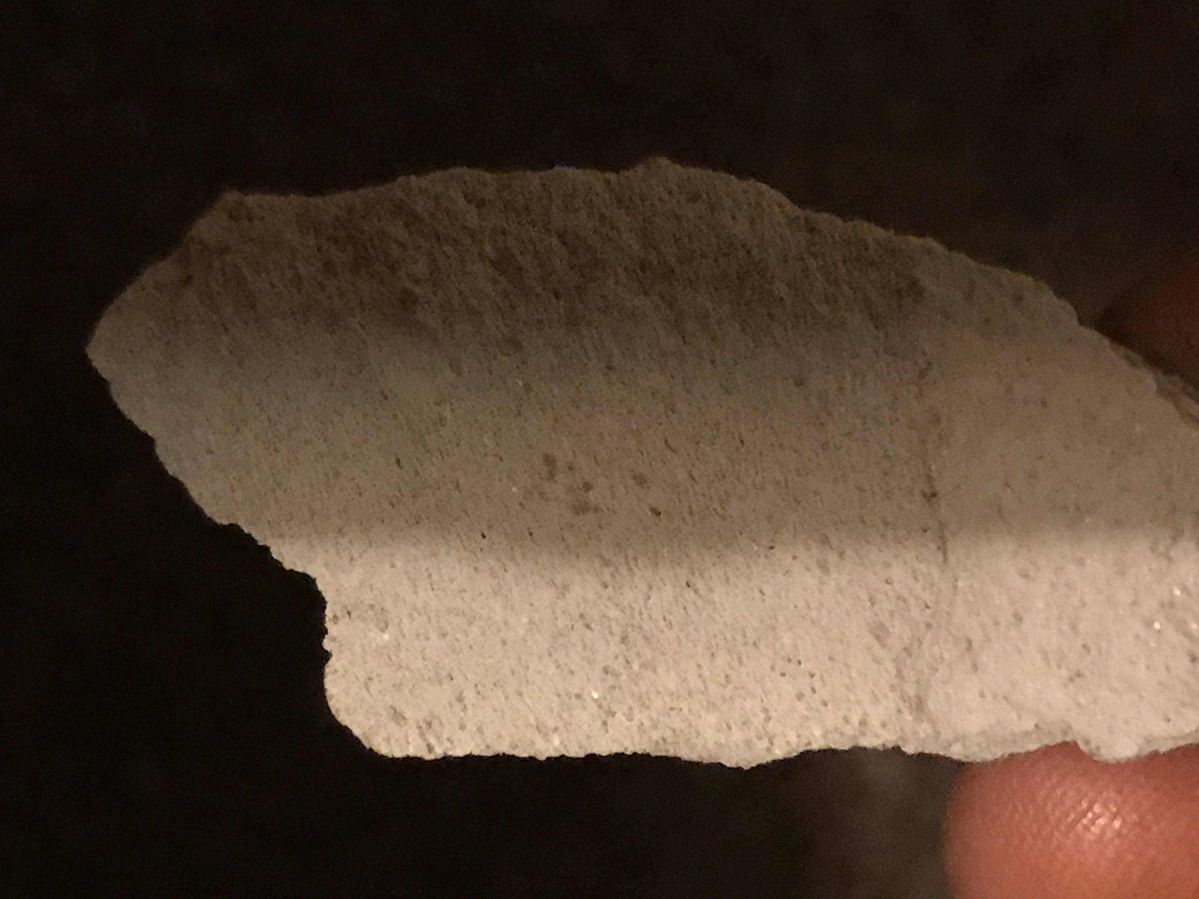

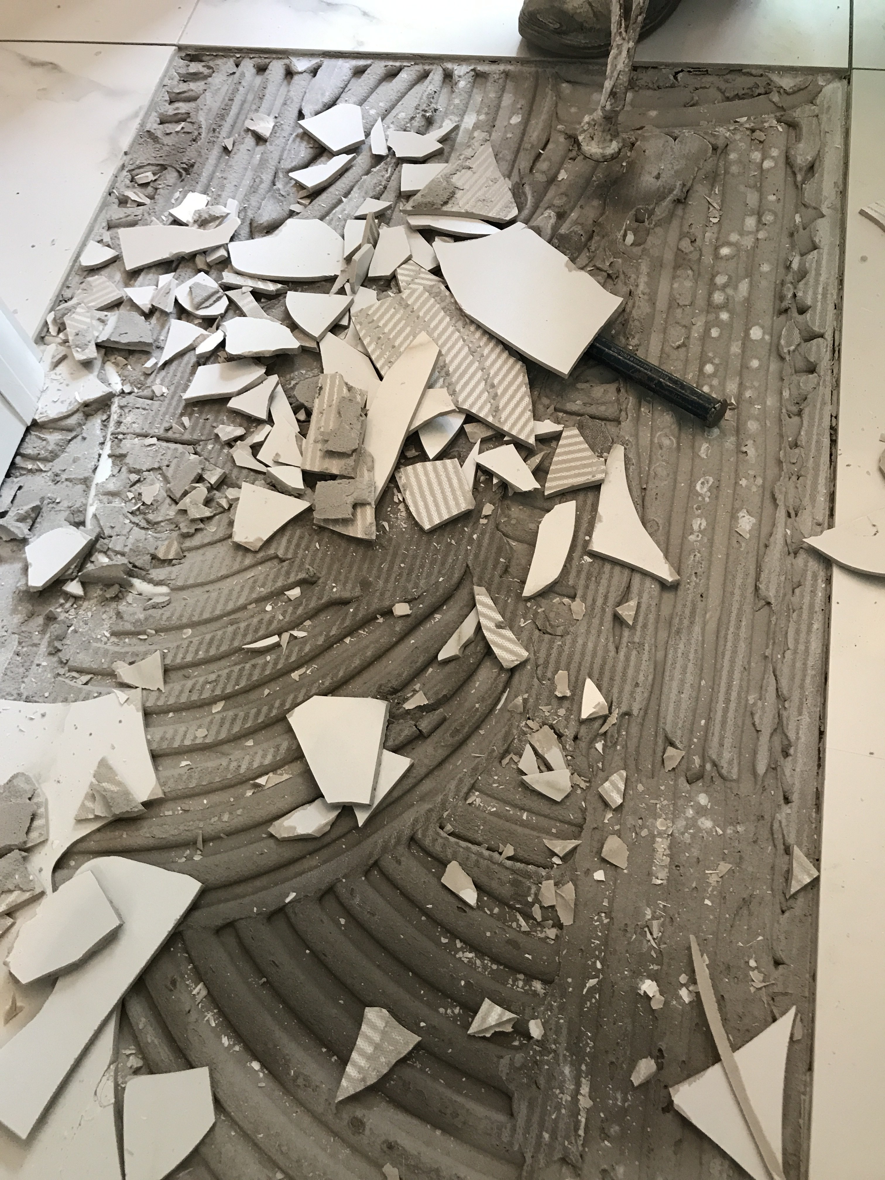

What we found beneath was a floor with around 65-70% coverage at best, and poor troweling technique.
But most disturbing of all was the adhesive had very little strength and was soft and easily scraped from the floor.
The tiles were stuck to it, no doubt about that, but there was just no strength in the adhesive at all, we could crush it between our fingers.
The floor has been down for 9 months, more than enough time to cure completely.
The recommended adhesive is Mapei Kerabond T & Mapei Isolastic stuck direct to the aluminium.
No priming required.
The adhesive used, Ultra S2 single part adhesive.
Priming was required if this adhesive was to be used, unfortunately, it wasn't.
So in normal circumstances you might think that you'd have a half decent chance of the the floor being ok even tho you didn't prime.
Thing is, when aluminium comes into contact with Portland cement, a chemical reaction takes place, this chemical reaction creates hydrogen gas!
What does this mean?
Well in the first instance the adhesive is filled with bubbles of Hydrogen gas, which in turn causes the adhesive to expand considerably causing tension in the floor. Secondary to that, it also causes the aluminium to corrode.
So what you are left with is a floor where the adhesive is literally on the edge of catastrophic failure.
I have some better examples on site I'll post tomorrow.
But as you can see, it looks like overwatered adhesive, but in fact it's cavities caused by hydrogen gas. Causing the adhesive to be almost useless.
We scraped it away from the floor with a bolster by hand!

One daft question..... why did you need a thermal camera if you were using a variable depth grinder set to the tile thickness, to cut the grout joints?
It's got nothing to do with the tiles tho Ian, that's the whole point of the thread.
It's fixer error, and the on going saga with retro fit ufh.
It's a difficult aspect of the trade to deal with correctly, and some fixers are just too gun ho!
As it turned out some of the pipe work was actually touching the underside of the tiles, we just wanted to be 100% sure that when we cut through the joints we weren't risking cutting the pipe work.
We were there to repair not make it worse haha
