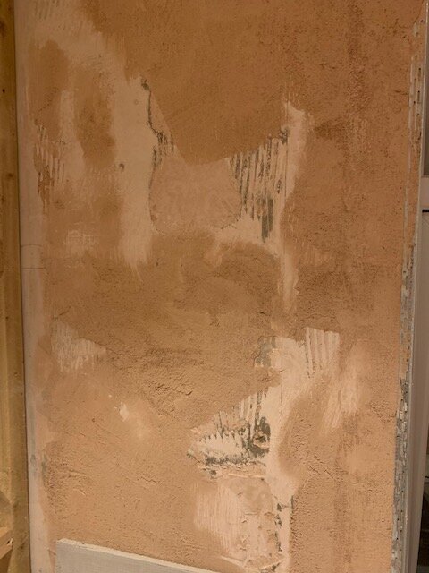

(2) we’ve got a brick wall with a layer of plaster on it but it hasn’t been skimmed (see photo). This is behind the bath, and will be getting the brunt of the water from the over bath shower. We will rank this, but does it need priming first (and if so, will Primer G work)?

2: Not suitable to tank or tile to as it is.

Thanks Dave that’s great. What should we do with (2)? Fix more Aquapanel to it? And if so, would we fix the Aquapanel using tile adhesive rather than screws?

Adhesive and screws. 👍
Nice one, that’s really helpful thank you - I’ve just been reading the AquaPanel technical sheets which validate your advice 😀 One question though - do you put the wall plugs through the panel and into the wall? That’s what the instructions suggest but it’s a method I’ve not used before.
Also, there is a window on that wall, so I presume we should panel all round the window too.
When in doubt, use primer, it never hurts. As for plugs through boards, I would tank the holes then add a pea size amount of silicon just before driving the screws in.
Yes through into the brick.
