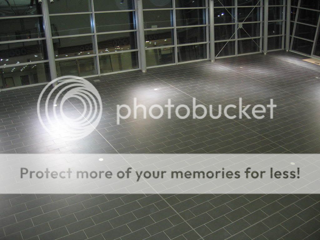

how do the spaniards/greeks manage without expansion joints ?? quality hotel i was staying in tenerife last year had 100,s of m2 of large format marble everywhere , virtually tight jointed and not an expansion joint anywhere, the floors were perfect no cracks or lifting at all . you think with the heat there would be a lot of expanding and contractions , same scenario at a greek airport i was at this year, do they know something we dont??
