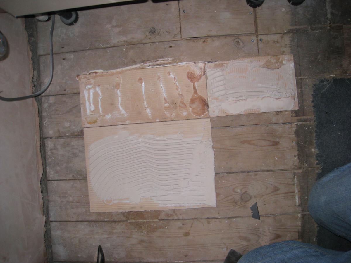

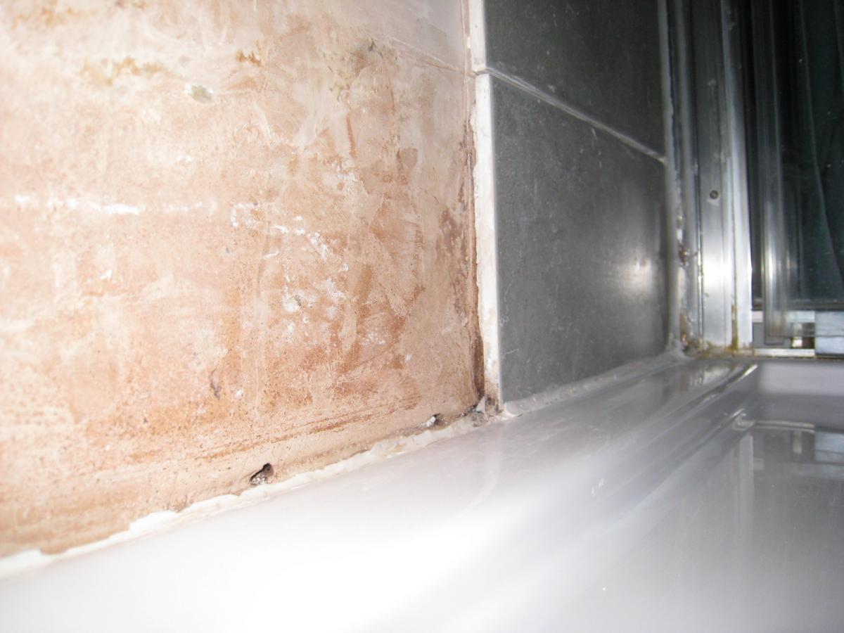

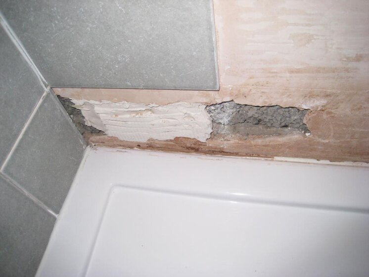

IMG_0384.jpgIMG_0385.jpgIMG_0380.jpgIMG_0386.jpgWhat adhesive, grout, or trowl he used I don't know. I was at work.
I don't think he treated the walls.
I have some pics, I'll see if I can attach them
The whole tile which was loose looks to have the adhesive put on the tile, not the wall. don't know if they are all like this.
The tile round the corner bottom row is loose. As are the whole 2nd row and part tile bottom row to the right, which are both under the enclosuer frame

Hi alan, basically the tiles have not boned to the wall. The water has worked its way in the grout joints. Looks like there is no grout in the tiles anyway. The guy didnt have a clue......

The tiles clearly have not bonded to the plaster wall to create a water tight seal. From experiance water will creep in the smallist crack and over time find a way out at another location. Water is the strongest element you can not cut or break it and it has carved out our landscape in the form of glaciers....
Anyway to fix your problem
1.Take of shower door and tiles
2.Tank shower walls
3.Solid bed fix tiles with ardex 77
4.Grout with ardex fs
5.Door back on
6.Silicon where needed.......
