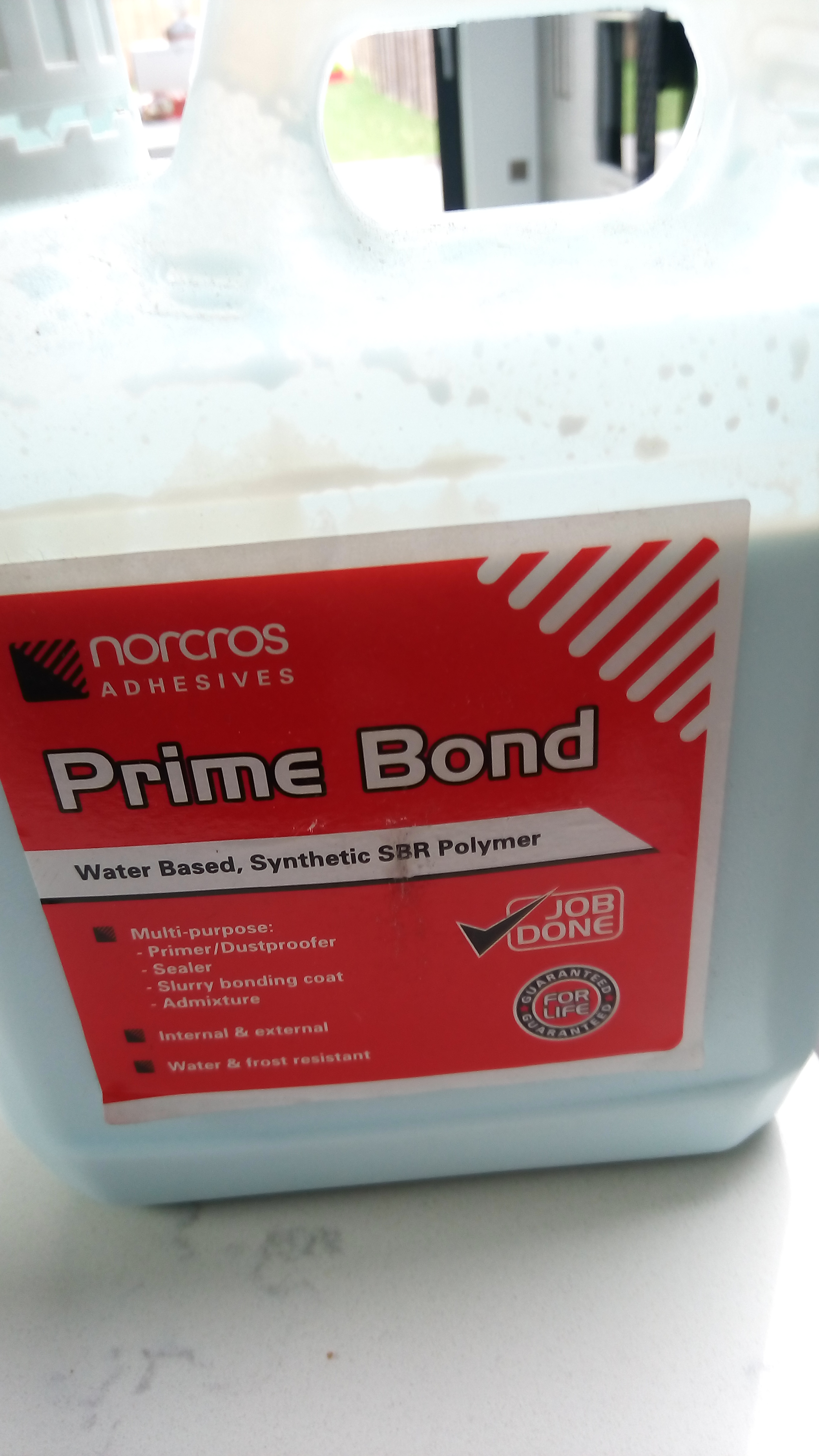

Yes laitence was removed. This is the primer we used.

How many coats of primer were used and to what dilution?
Tiling an anhydride screed with cementitious adhesive requires an in-depth knowledge, and is not something to be taken lightly.
