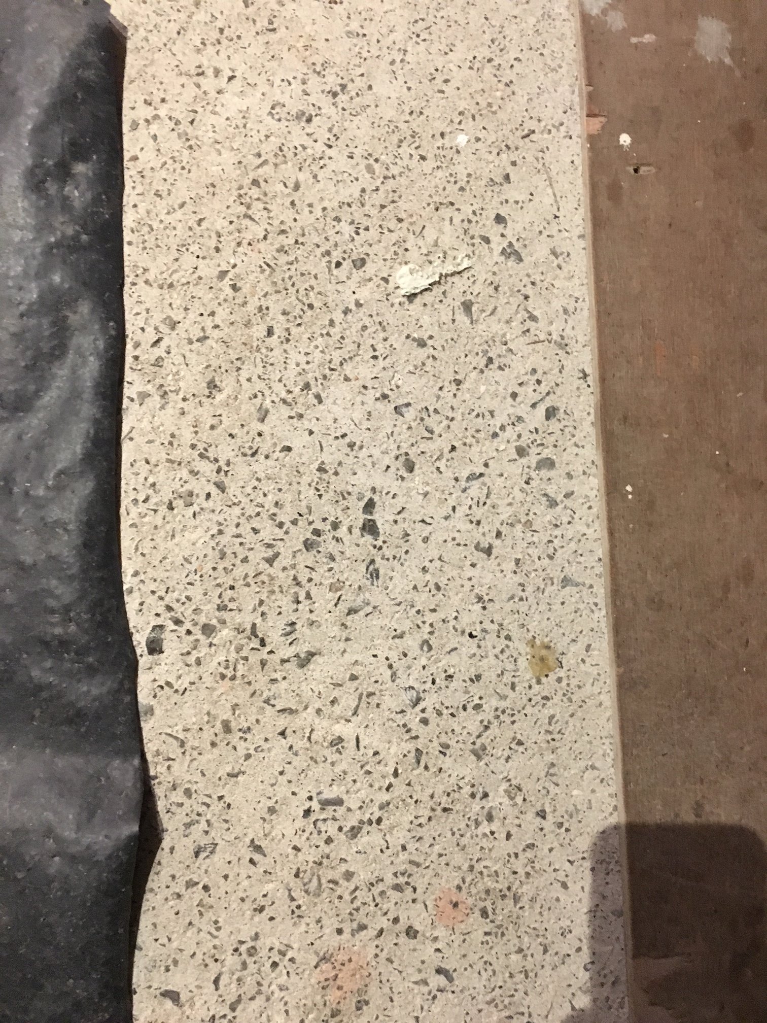

here is a comparison of sections of the concrete.
photo 1 , left covered with dpm
photo 2 , left uncovered and walked on where most of the powdery stuff has eroded leaving hard concrete.
