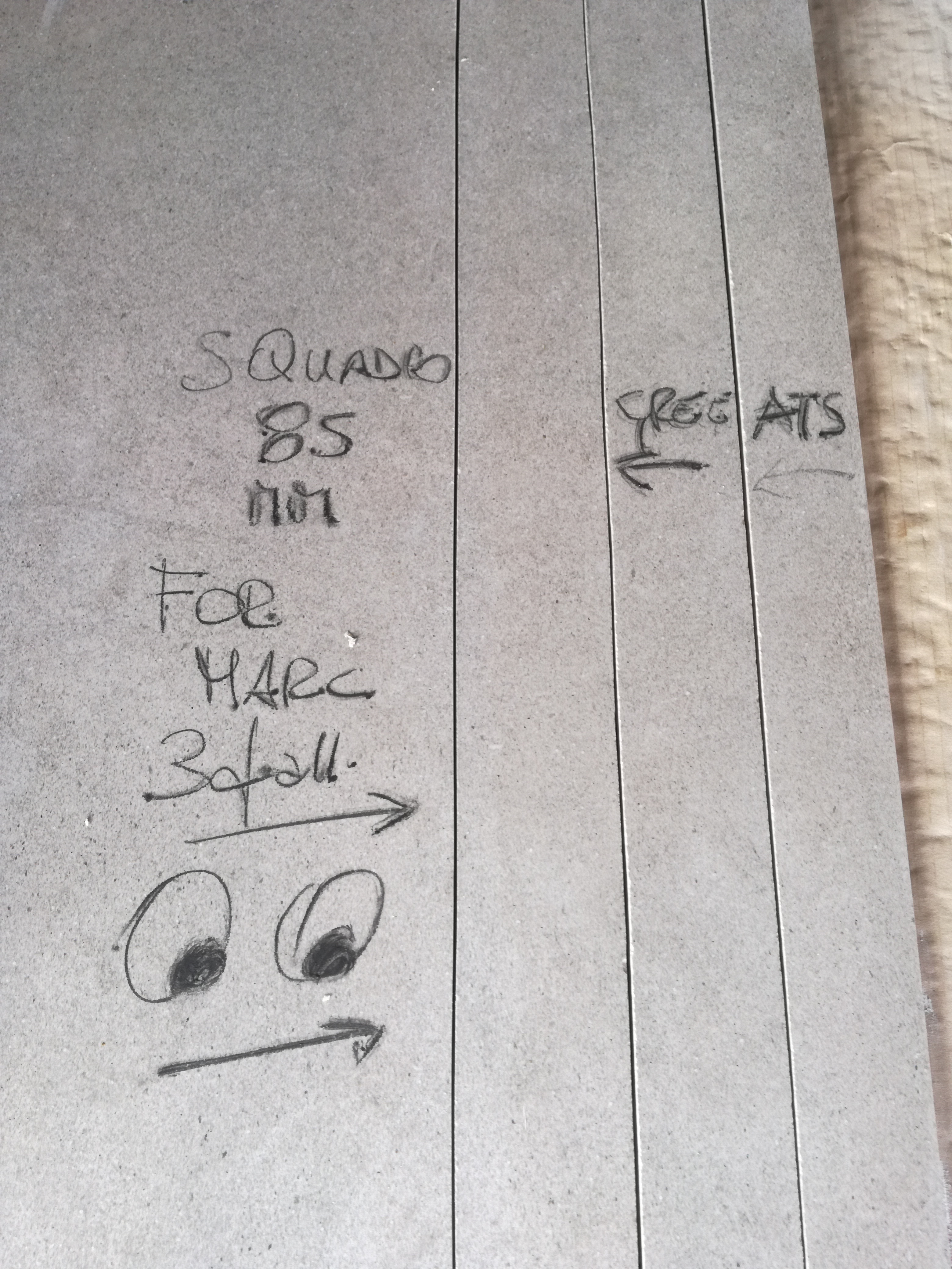

Montolit squadro 85mm for me.
The tile in photo is 5mm
