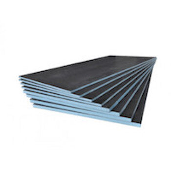

Unfortunately the en-suite is extremely small and having a ticker board would reduce the living space. It's so small that when using the toilet your face is very close to the sink and even one or 2 cm more can make the bathroom unusable. The en-suite had a leak in the shower due to the fact that it wasn't tanked properly, water was going inside the grout lines into the walls and finally under the shower tray causing damage into the living room below. We bought this property recently and this is the first room I am planning to renovate as it's the smallest. My priority is to make it leak proof so I have decided to use the backerboard mainly for that, I bought some like the one in the attached image

Hi Adeblast, if the masonry wall is sound and fit for tiling why not go with a waterproofing kit instead of backing board? But if you're going with a board I'd look up manufacturers recommendation on trowel size (I'd imagine 8mm or 10mm trowel in one direction and rock side to side to collapse trowel ridges) and when installing take the board off to check your coverage.
This is from the akw website regarding warranty and installation so be careful!
Warranty
No warranty is given nor is it implied that
any building material product we offer is
fit for any particular purpose. As we have
no control over the way our products
are used, customers must ascertain for
themselves that an item is suitable for
the intended purpose

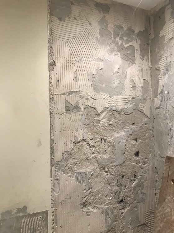

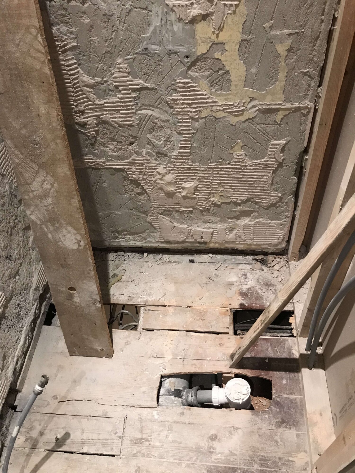

Well think is a brick wall yes, it thin and not load bearing, I will first remove the old adhesive and then add new adhesive and attach the 6mm plastic tile board. Here are few pics of the walls
Couldn't you just use hardie backer boards and mechanically fix them. Or SBR the walls once you've removed all of the adhesive then use a 10mm trowel and apply an S1 flexible adhesive to stick the boards on. Once it's dry mechanically fix it into the wall. You can get 6mm hardie but should probably use 10mm with it being a wall I think?
