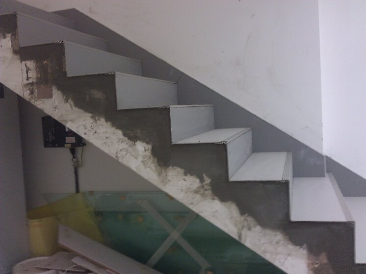

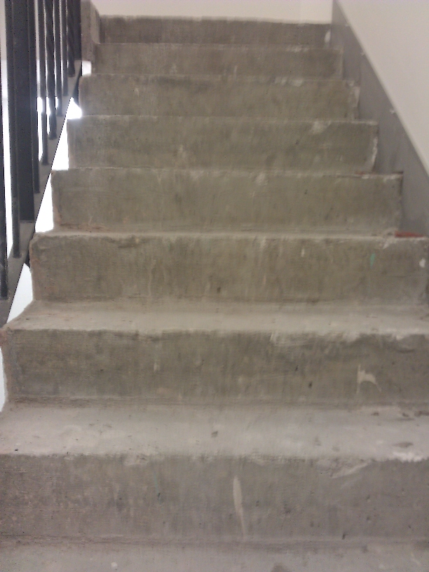

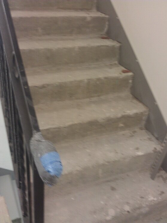

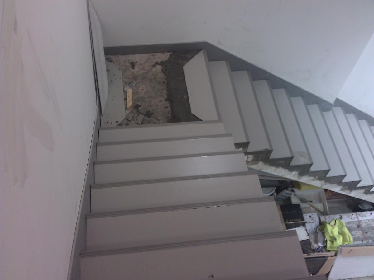

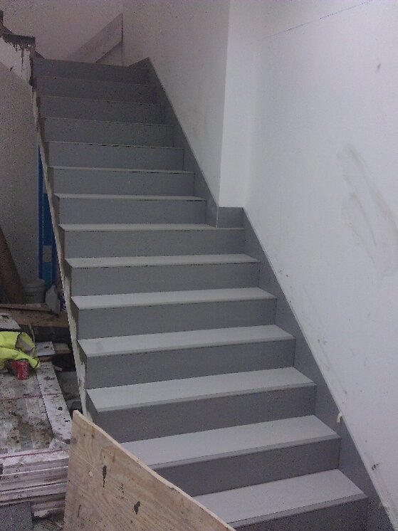

here are some pictures of the work i am doing at the moment some of the concrete is up to 15mm different fro step to step with the raked riser you talked about using the maths I have managed to make all the steps equal and made stair strings fro the tiles too all in 4.8mm porcelain

Its still the vandex. The steps go up on the side of the building to a top flat area about a m2 or so and the door is on the left. Tiling that as well. I'm wondering now how much height I have at the top that I can eat into. Also the top step is the highest so I could just use 6mm board on the top and thats one less to worry about. I think I'm going to follow your advice Gary on working out an average etc. The whole thing is tricky though, if it wasn't for the substantial curve on the internal angle and it was all just nice and square then I could just cut a load of boards to the established average and just bang them in but I cant do that as every curve is different! And it also means I havent got anything to measure from to be spot on to the mm. The whole job is just bloody frustratingly awkward!! Pulling my hair out all afternoon!!
