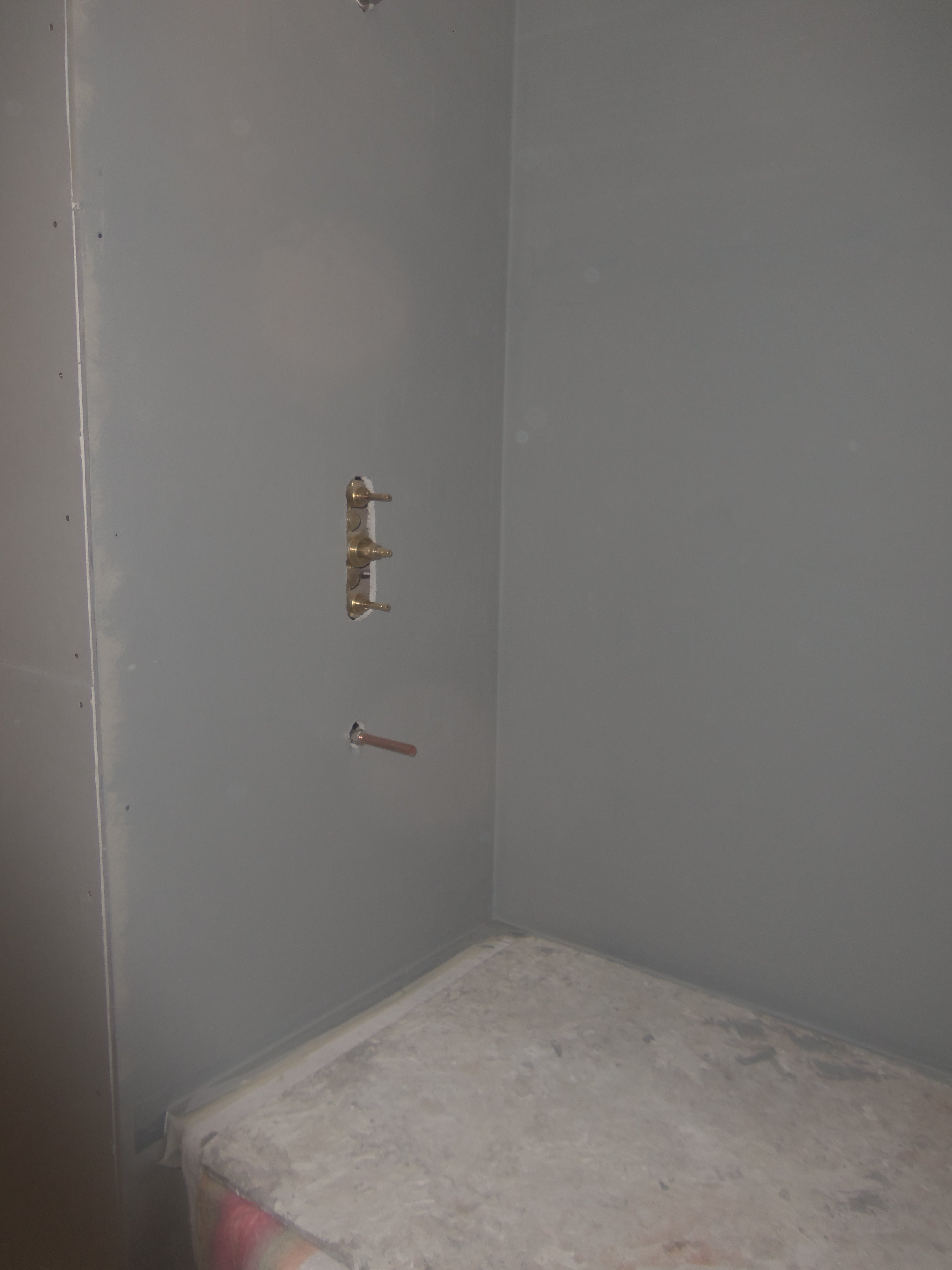

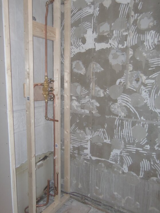

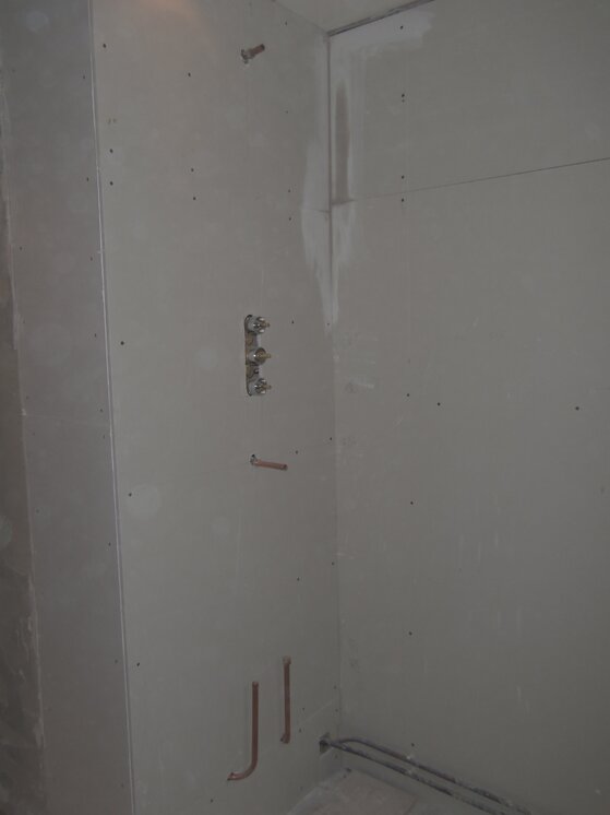

After the problem arose and I was contacted I referred to my before / after pics.... I have blown up this second pic and can see no actual fixings holding this frame in place .....Crikey !! and have come to the conclusion that perhaps the pipe work was aiding rigidity when I boarded the front of it. .......hence it never moved.
Valve slot was at the request of the plumber instead of three separate holes ...to help should a valve issue arise.

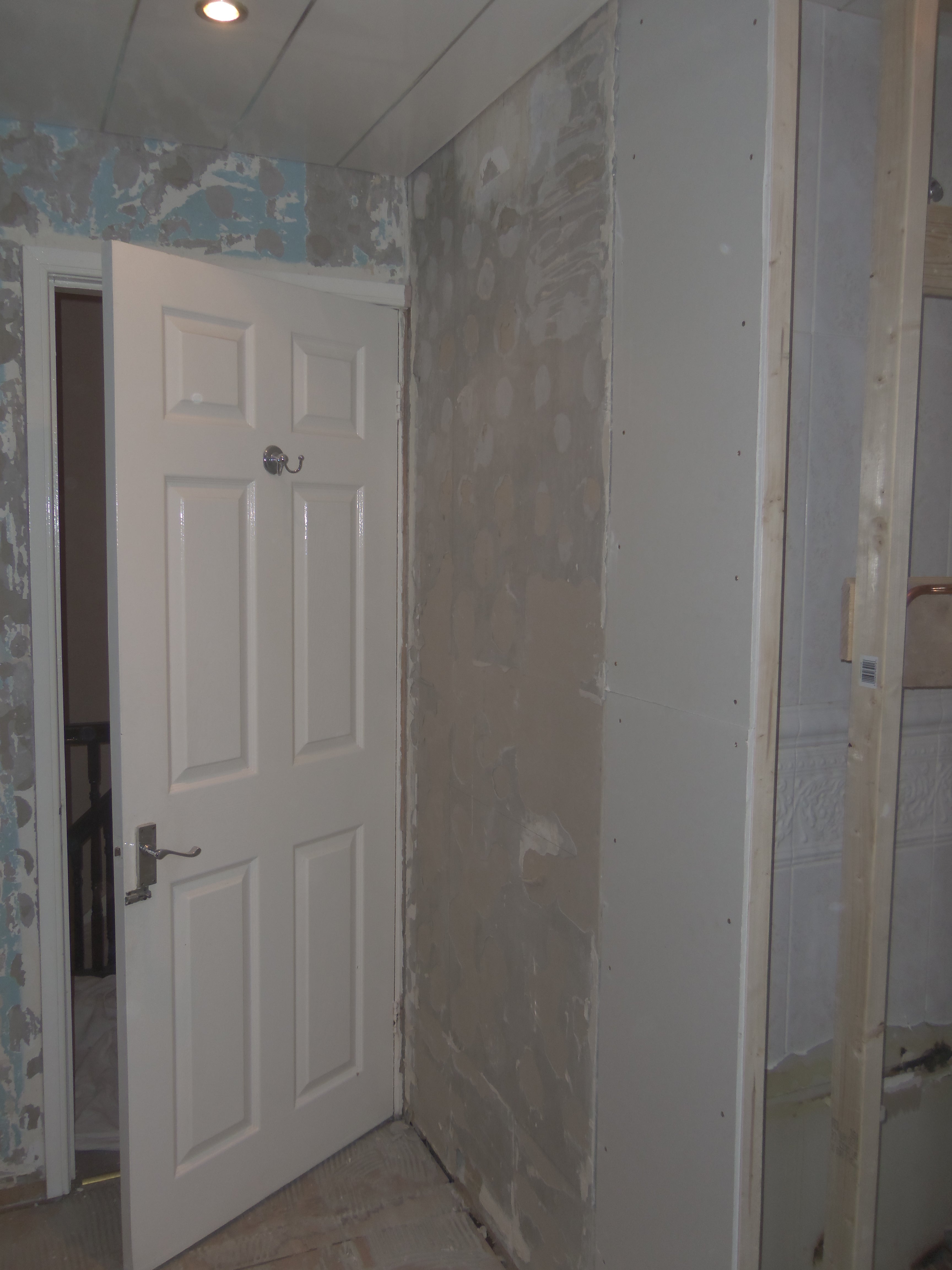

This is where they joined new studding / board to the existing wall to extend it ...yep showing normal screws used in their boarding..... and original D&D tiles some 30 years ago !!..... I boarded the "shower side" using drywall screws this illustrates two individuals work IMO... nothing moved during me doing this.

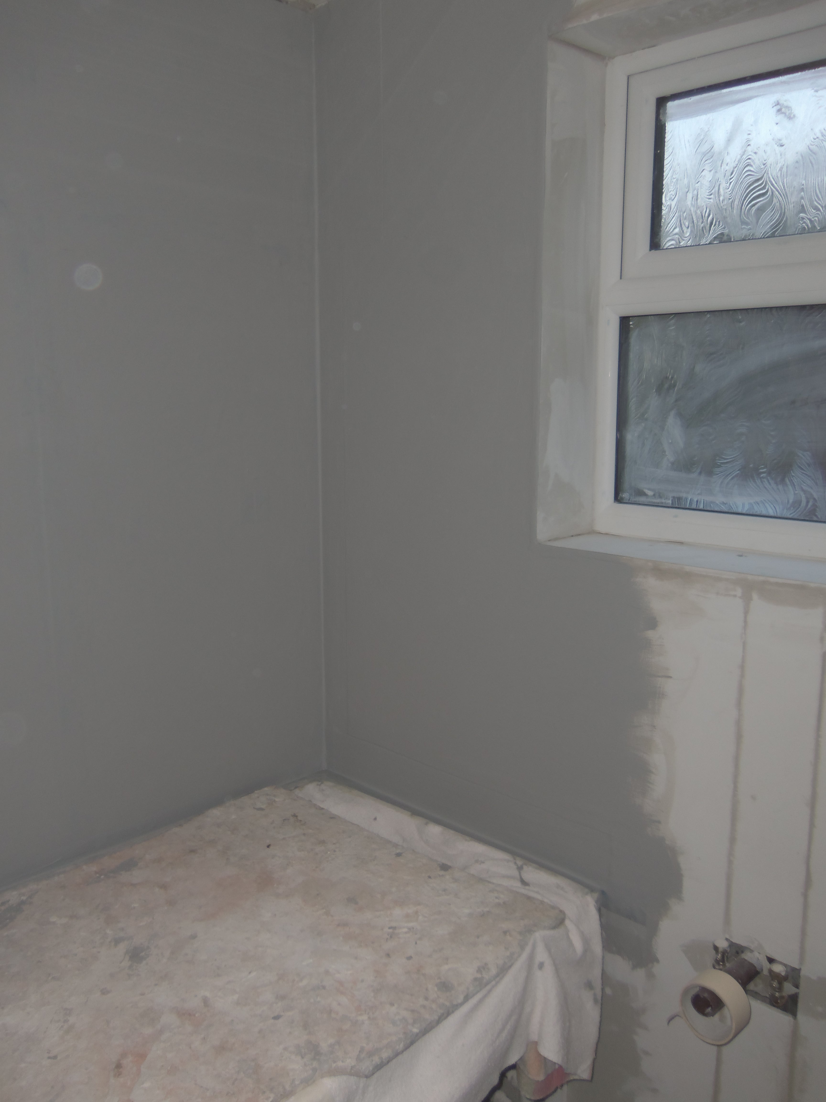

The section was tanked .... I tank every single bathroom I do

Hi Doug ... I have looked back at my other pics .....overboarding the two sections would not have been possible due to the door frame / hinges etc....
