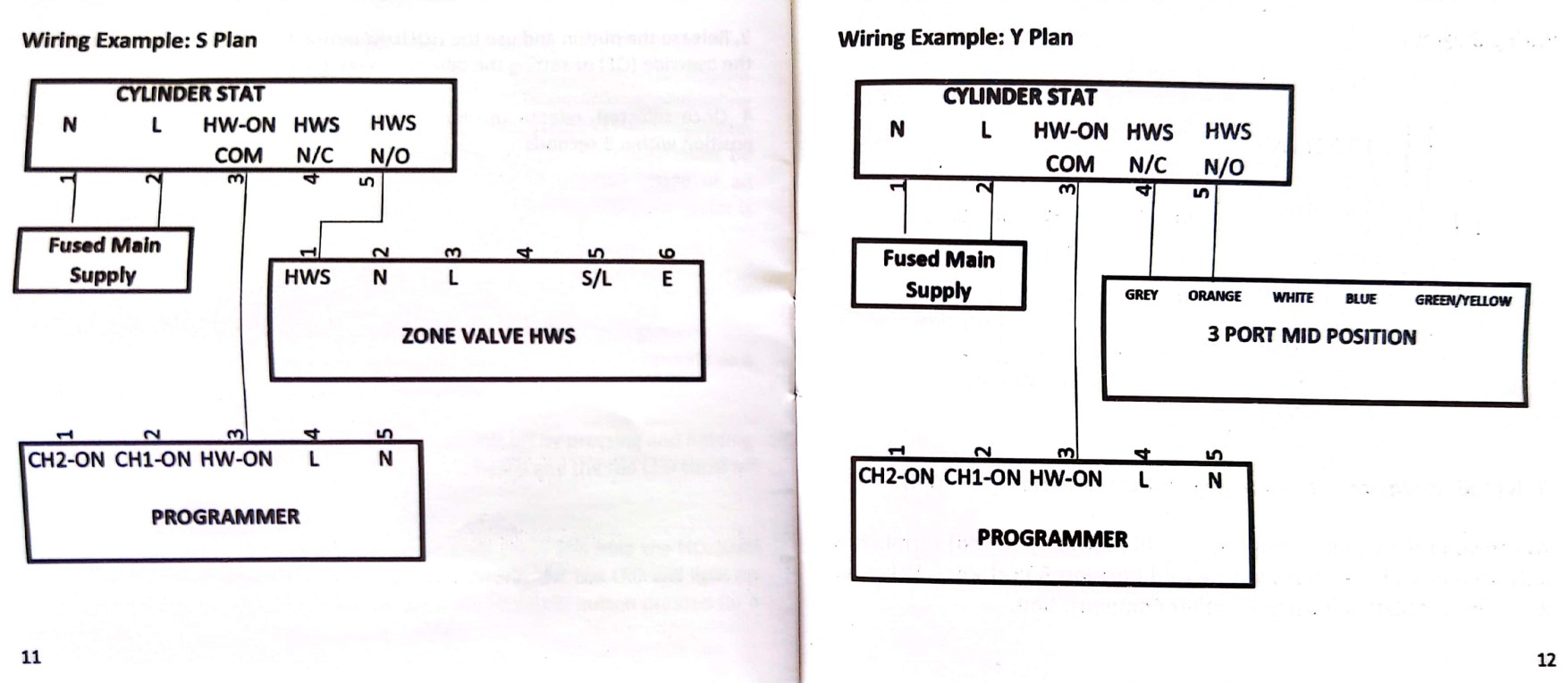

Hi there,
I've had 4 plumbers & 1 electrician look at my problem (seemingly without dedicating too much time unfortunately), spending more than £1000 already 😣, but none of them has found the issue to my problem - that's why I'm reaching out to you!
I have the below set up
The Nest controls (or tries to) both heating & hot water.
At the moment the cylinder thermostat is not working - it just doesn't switch on anymore... (it used to only switch on when setting the Nest to boost hot water)
Thinking it was faulty I ordered an identical replacement, and replaced it myself.
By doing so I found the wiring to be rather odd - I have no prior experience at all with these things, so could obviously be wrong..
I am suspecting that someone messed up the wiring at one point.. Can you please have a look?
Many thanks!!
Central Wiring
Cylinder Stat Wiring
Cylinder Stat Wiring Instructions
