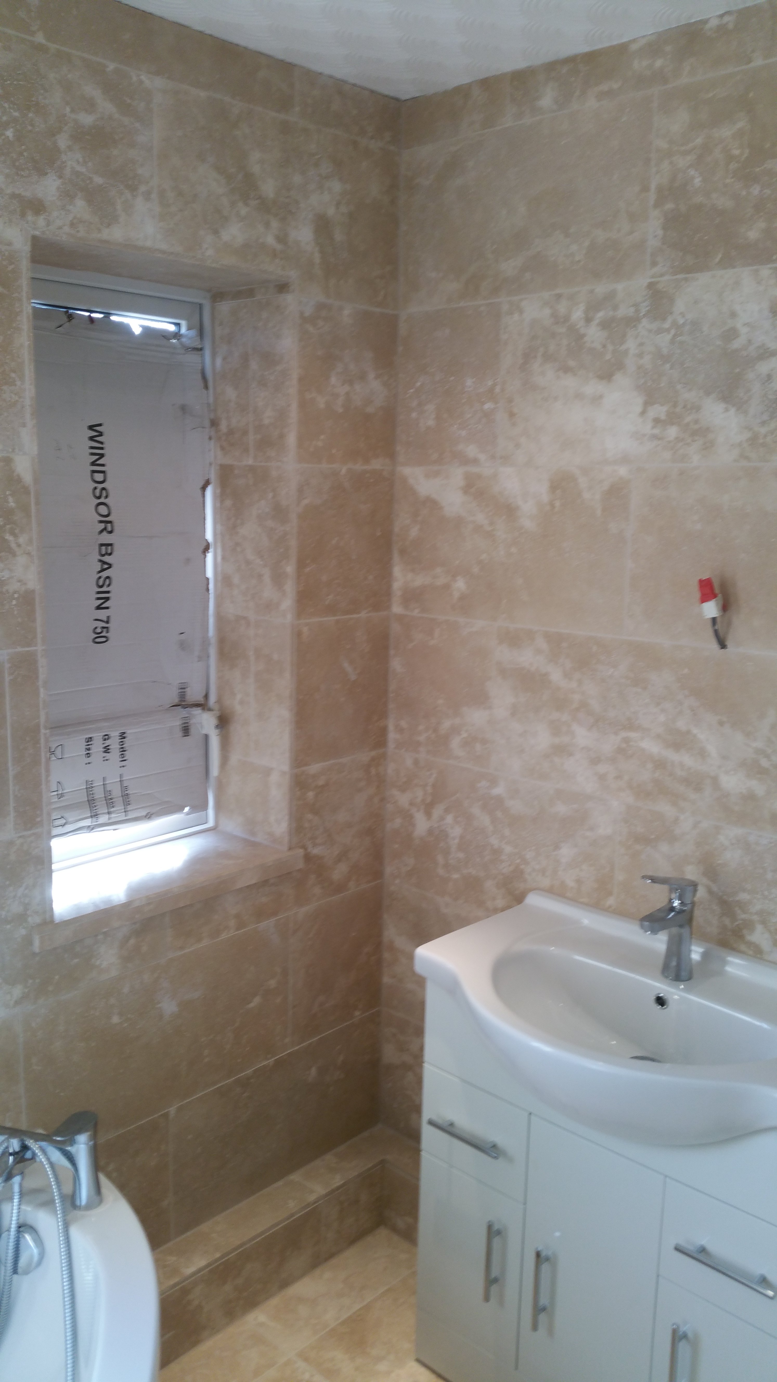

Hand polishing mitred edges-Travertine
Cut your tile to desired length with a straight cut, then cut your 45o, but leave 2mm on the leading edge, as diagram.
Then you can use something like Sait carborundum pads to hand finish before you bring the pieces together.
It will then create a 'birds beak' a V shape if you will.
This gives you a good joint to grout, and it will give it some strength.

That is exactly what I was getting at
If it's only a few edges you need to do a few sheets of wet and dry at different grits would probably do what you need. There's no need to buy a load of Silicon Carbide discs for a one off, it's worth buying them though if it's a reasonably regular thing.
I was never keen on mitres on travertine due to it's brittle nature. I always preferred to overlap the edge and square polish with maybe a micro bevel. It effectively gives the same end appearance and is more resilient to knocks.

Thanks for all replys its given some food for thought. The mitres aren't that bad but there not perfect as to why I want to try and neaten them up a little before fixing. Grout will fill most of it but theres a big difference between 99 and 100%
