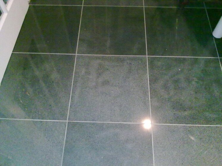

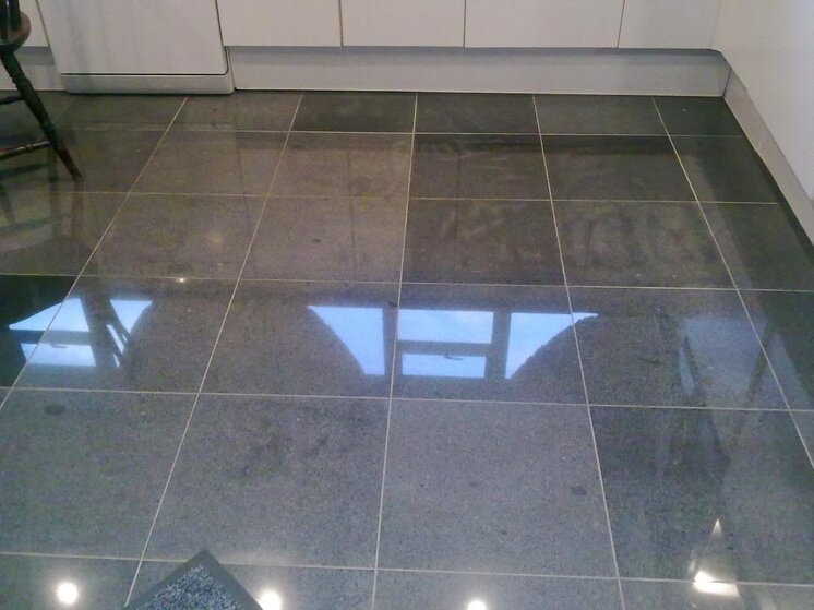

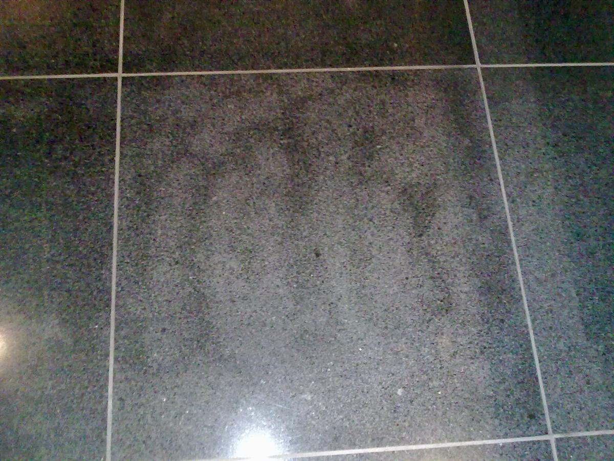

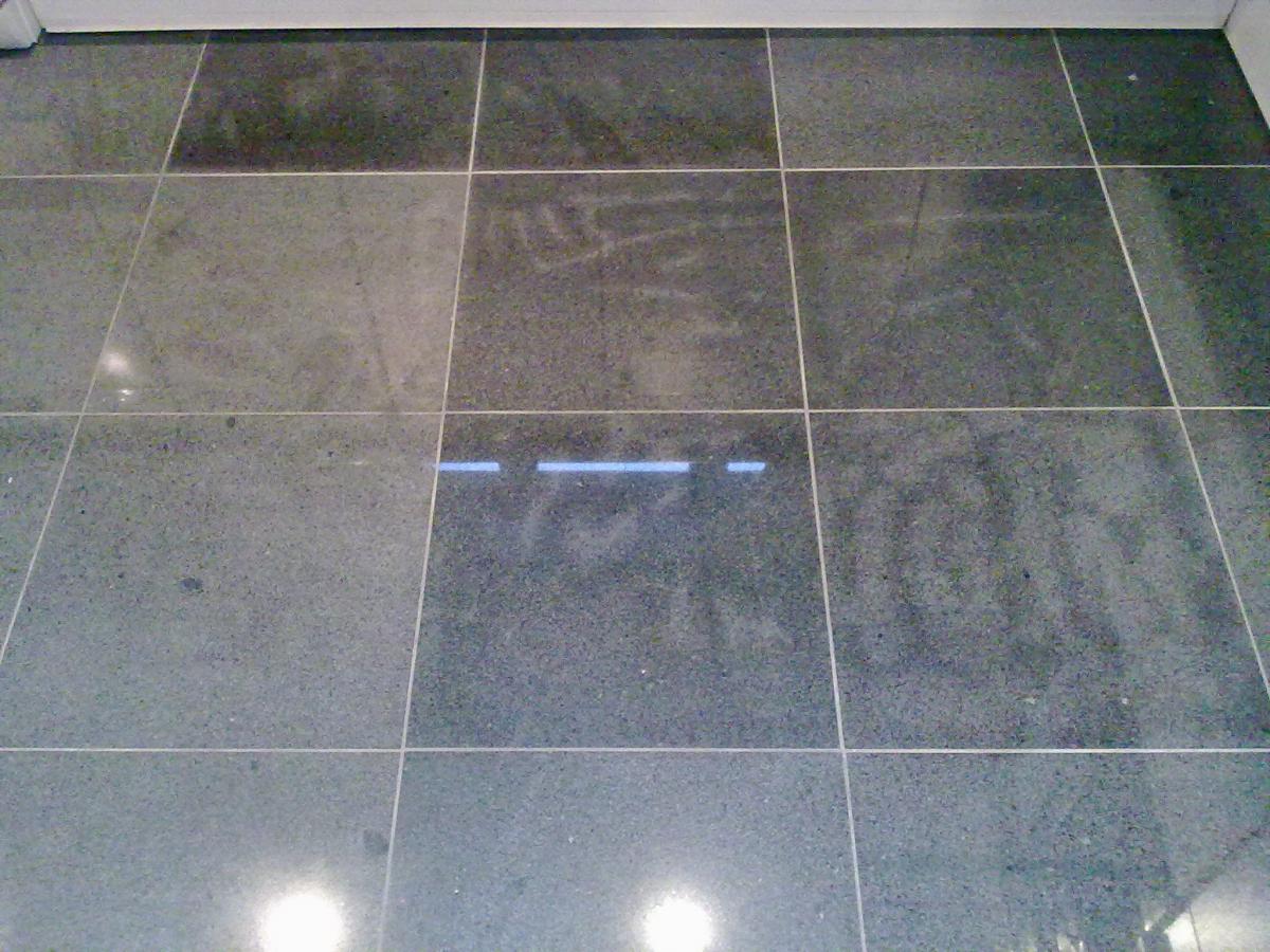

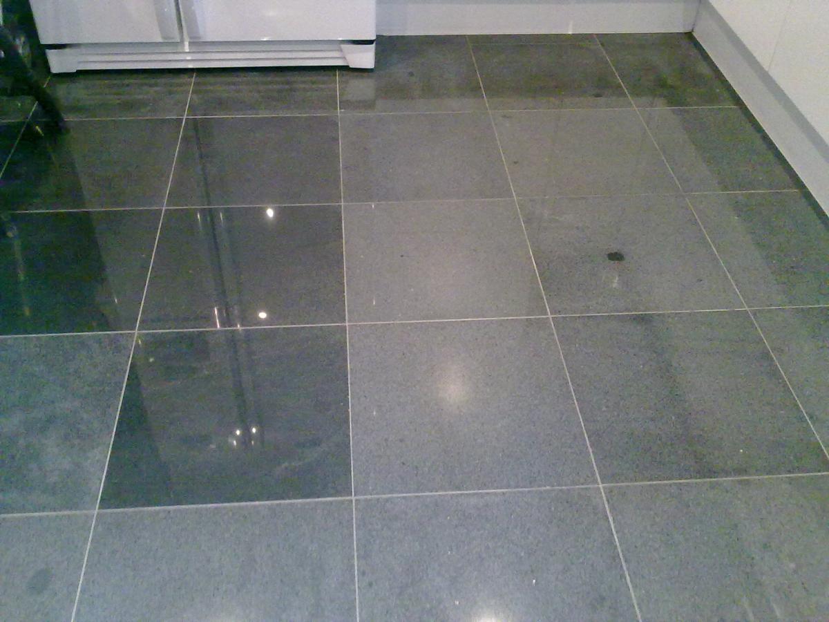

Hi,
I was wondering if someone could advise me on a problem i have been having with this G654 Padnag Granite tile.
We had this tile laid in our kitchen aprox 3 months ago. The tiles were laid and the grouting done there and then.
Once laid, the tiles appeared much darker at first but were a uniform colour.
During the last 3 months, some of the tiles have returned to their original lighter colour whilst others have had "colouration" issues, in that they have streaks, patches and blotches on them of various colours. Some of the tiles look like they have been effected by the sun and gone really pale whilst other have wavy patterns running through them. it just looks horrendous.
We have been advised that this is part of a "drying" process which was supposed to take upto a month. 3 months down the line, we are still concerned that everything still appears to be changing for the worse.
Also as advised, we have applied no sealant as yet which has resulted in stains on the tiles.
Please advise as to what we should do. is there a fault with the tile, the adhesive used or the fact that we haven't sealed yet.
Many thanks

diamondtiling
:yikes::yikes: I see what you mean :yikes::yikes:
At first glance it looks like two or three different colours completely, could it be the adhesive seeping into the tile? it can do that with very light granite if you use a grey addy.
The sun/light is not going to cause that, have you had the tiler/supplier out to look at these?
diamondtiling
Looking again, you have 9 light together and then 8/9 darker ones, that really points to different shade numbers which should have been checked prior to fixing. If the tiler had 3 or 4 boxes open and he was mixing them as he went then you would not have big blocks of them the way you do, they would be far more random.

DHTiling
Use a moisture meter on the tiles.....if no difference then it is tile shading....but you can also see adhesive shading on the lighter ones....or at least looks like it from the pics.
shaic
I have asked the suppliers to come and check it out. they've refused in the past on the basis that they believed that all would be solved in time with the "drying" process. Now that its clear that this is not the case, i have requested once again that they come. they have agreed.
from what is being said, it appears that the colour variations seen is due to a combination of two factors
1. Natural stone varaition
2. Adhesive seeping through and colouring the stone
i must point at that at one point all the tiles were as dark as the darkest ones you see in the pictures, and that only with time have some of them become lighter. Bizarre as it may seem, the tile's colour appaers to be evolving but not always necessarily for the better - like i said, some of the tiles which were once the natural "out of the box" colour now have streaks of white and dark grey running through them.
Please advise on what can/should be done about this.
