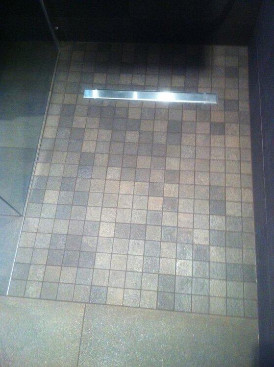

Here you go Martyn
Sorry its of mosaics but there are only 2 falls to the drain rather than the normal 4 so I would suggest on these trays that virtually any size tile can be used, my customer just wanted mosaics as oppose to continuing the 60x30s all the way through the tray

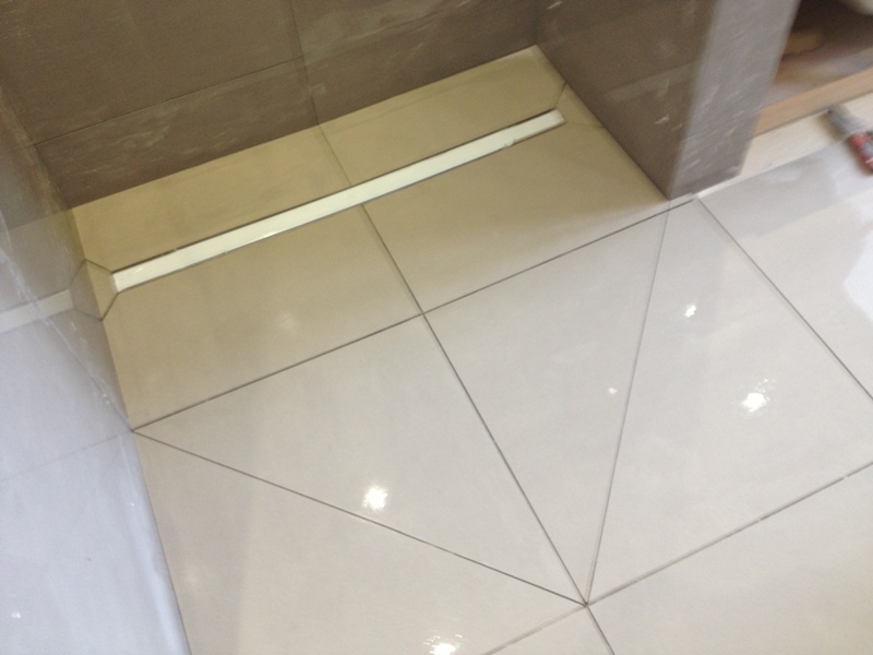

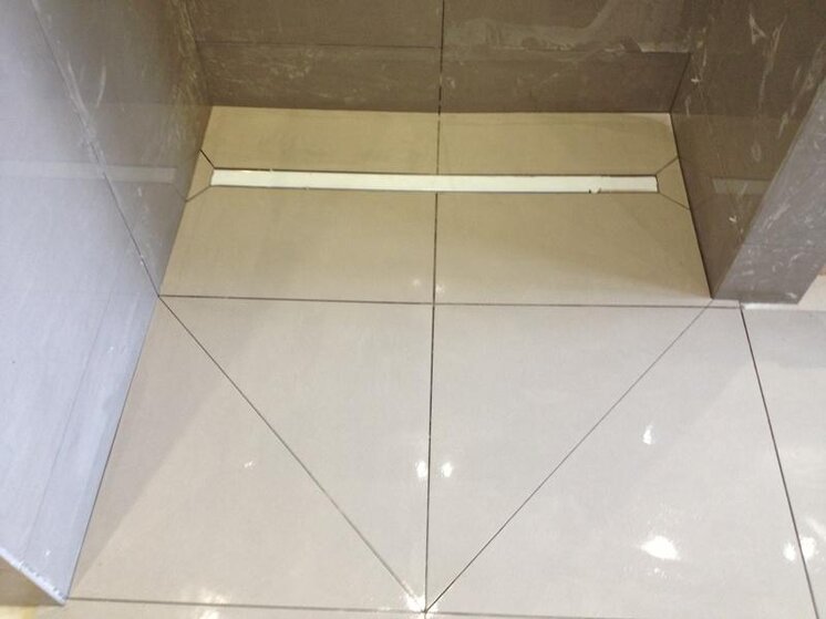

This is one I did today, envelope mitres to suit the falls looks OK imo and will work, no pooling the water will run straight into drain.
