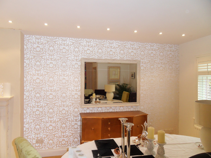

So full of a cold and barely able to think straight I spent the weekend (and today 😳) , preping, lining and papering this job amongst other little bits.
So thought I'd share the pics which I have to say don't do the paper justice because it doesn't pick up the way the wall sparkles, also the room was still in a bit of disaray when i took the photos, so will update when it's dressed again.
Thinking about maybe a vodeo would be better to pick up the shimmer
anyway...

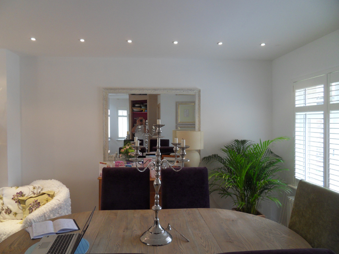

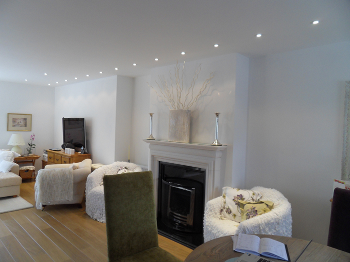

Before shots

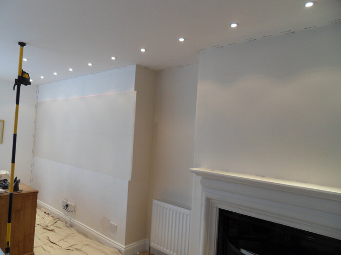

Walls primed with Zinsser Gardz, then lined with Mav 1000 grade lining paper, Solvite ready mixed super high performance paste.

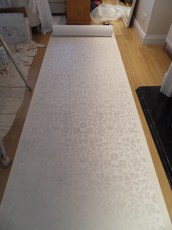

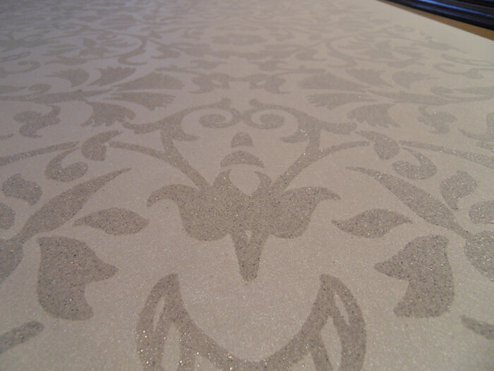

This is the paper Jannelli and Volpi 901VIP - 1m wide on a 30m roll
Close up of the paper (can ss a bit of detail in this shot)

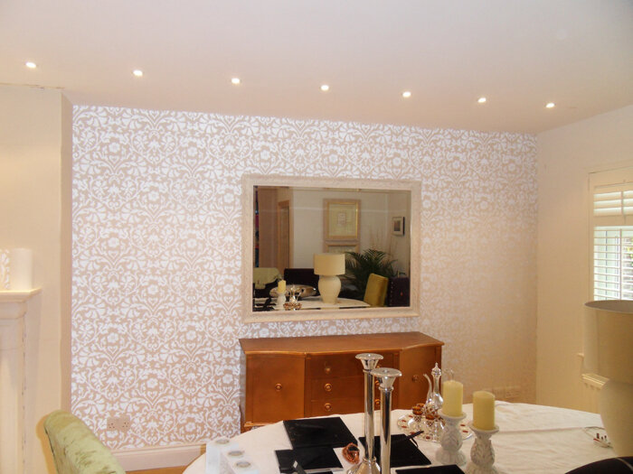

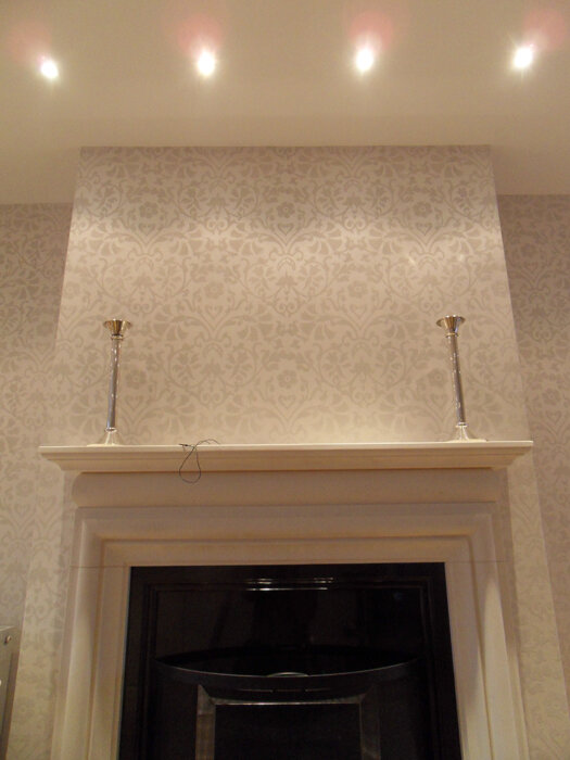

Job done
Picture taken with flash on so you can see how it reacts with light
oh forgot to say, the paper is made from thousands of tiny glass beads, new blade needed for every drop!
superb job Rob
stunning paper
Should be for the price, £40sqm, so that is £1200 of wallpaper on that one wall.
trimming round the fireplace was a bit tricky as trying to cut through the glass was a bit tough.
Mike, sounds silly but do you hang lining paper the same way? i.e over hang the external corners by an inch, let it dry a little then dand off to give a perfect corner?

I was taught to cross line so the chance no joints matched when sticking.
