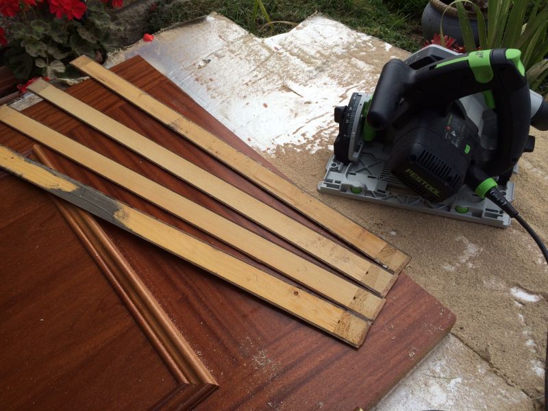

The tool that works for me !
I agree, it might mean the difference from getting the job or not, particularly when starting out, shame those saws that trim doors while still on the frame are so expensive.

Festool...mmmm.....you need to charge for taking bottoms of doors buying tools like that haha. Is that a plunge saw Tubs?
Haha this job was for the mother in law so no charge , others get charged ! Yeah its the ts55 plunge saw on the track !
I've borrowed my mates Makita plunge saw and track, great bits of kit, fantastic for cutting hob and sink cutouts, might treat myself at some point.
TS55 all the way. Takes longer to mark it than to cut it. Fein multimaster 350Q for architraves and frames.
