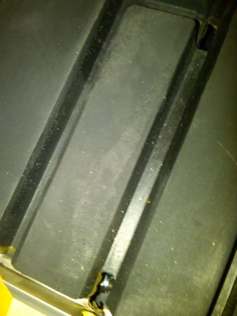

Also, the rubber to one of the sections on my cutting bed looks a bit dodgy and not as smooth and hard wearing as the others sections of the bed :thumbsdown: Does anyone else have this with theirs? Not sure if these photos shows it up very well...
No problems with the rubber at all ???

is the rubber part 58 you refer to to make a kerf referance ? this is just to allow for blade buzz giving a wider cut than its nominal width
as siramic not got my handbook to hand
I think it is Spanish mate:thumbsup:
Once you've set your blade perfectly square and made any adjustments that may be necessary, you run your saw though this 'puck' to give you a cutting reference at the base of the cutting bed:thumbsup:
