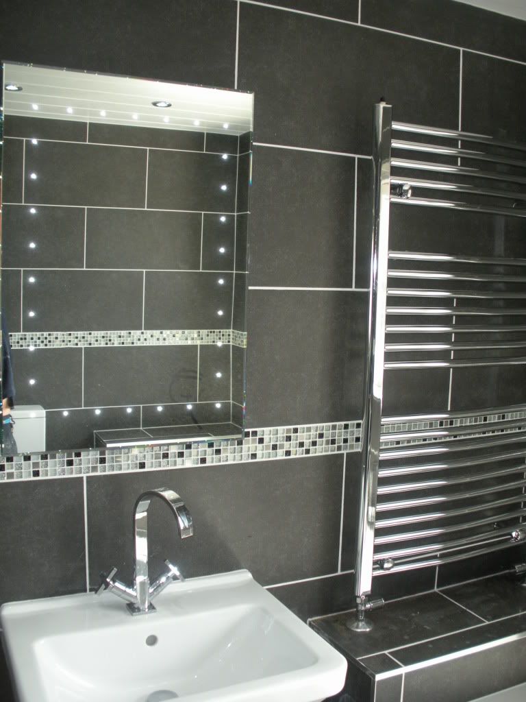

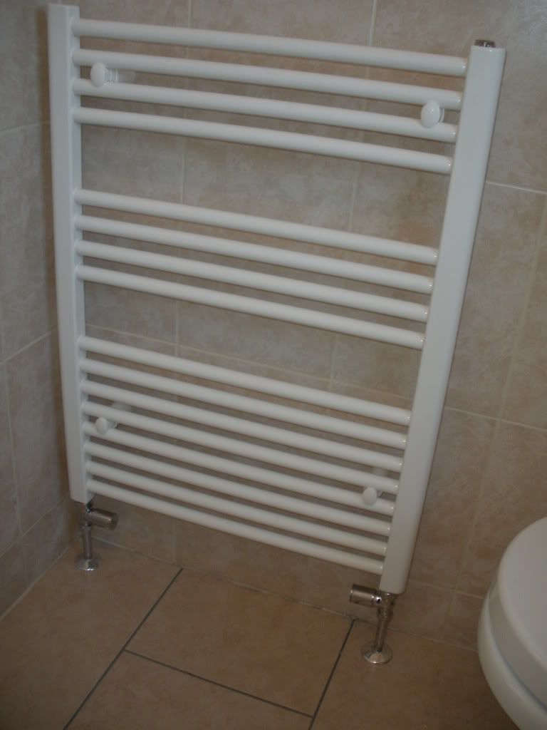

Floor tile will be hard to file, if you dont want the expense of buying a propper hole saw put a square hole in the tile, mark tile and cut from underneath then place the caps over the cuts. not a good pic but heres one: Nothing worse than seeing cuts placed back in place where the rad pipes are.
you can also cut a hole using a holesaw, probably 30mm as you need this size to go over any valves or nuts relating to pipes, fit tile and place the 30mm cut out back in place minus the 15mm for pipe.: looks odd but tidy in a fashion. can always cover it up afterwards.
