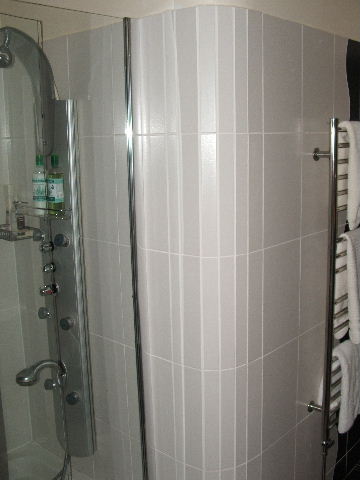

Did a bathroom last year - soundsexactly the same - Tiled using rapid set. worked out length of curve and divided into strips. Slightly back mitred the strips so that they would fit closer. Don't think it looks bad for my first ever attempt on a curved wall.
By the way - there is a trick of the light reflecting off the shower screen at the top - makes one of the tiles look like it isn't cut straight - it is before anyone says anything
