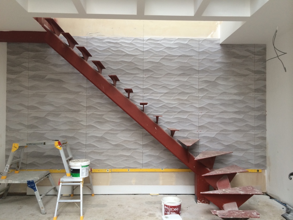

I've always been of the opinion that closing cuts are a big no no, until recently I decided to put them into jobs to help with the layout and I'm now wondering why I've been against them for so long! This is my current job, it eliminates that extra grout line to the side of the door and I don't think it's even noticeable.

The photo doesn't actually show the effect of the closure as the original size tile is not shown!

You're right John, it's not the best example! There were only 4 whole tiles in the room so it's even less noticeable.

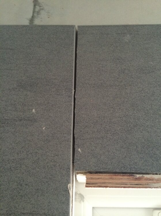

Here's one on the job I'm on just now, done by a local firm,
How not to do it.

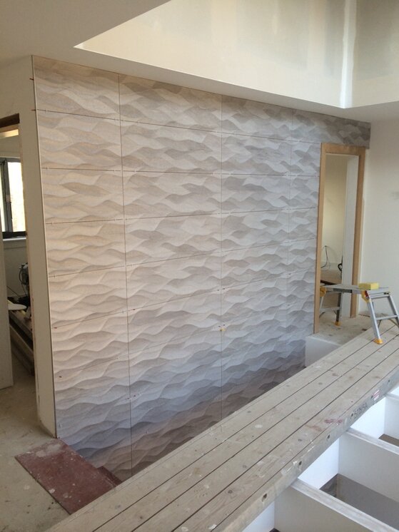

Done these end of last year.

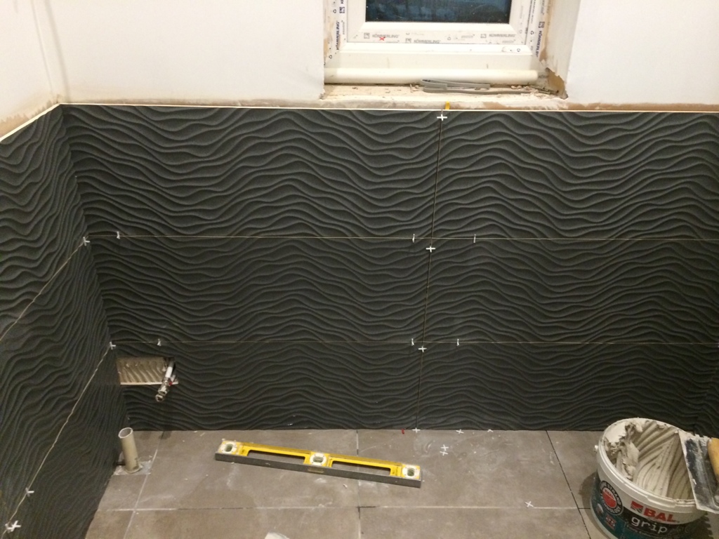

& these are on job I'm doing just now,
It's good fitting Porcelanosa tiles. [emoji106]
