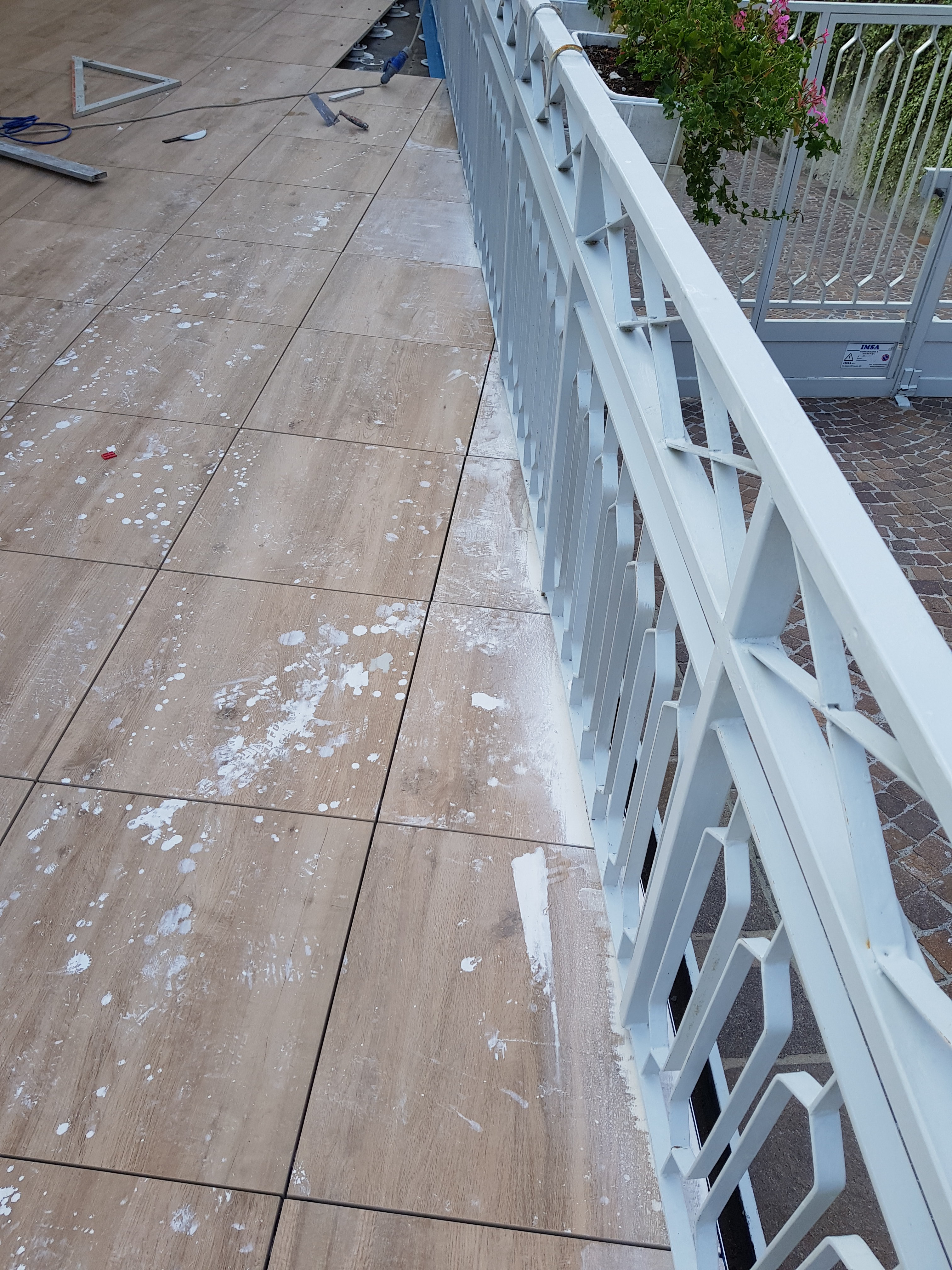

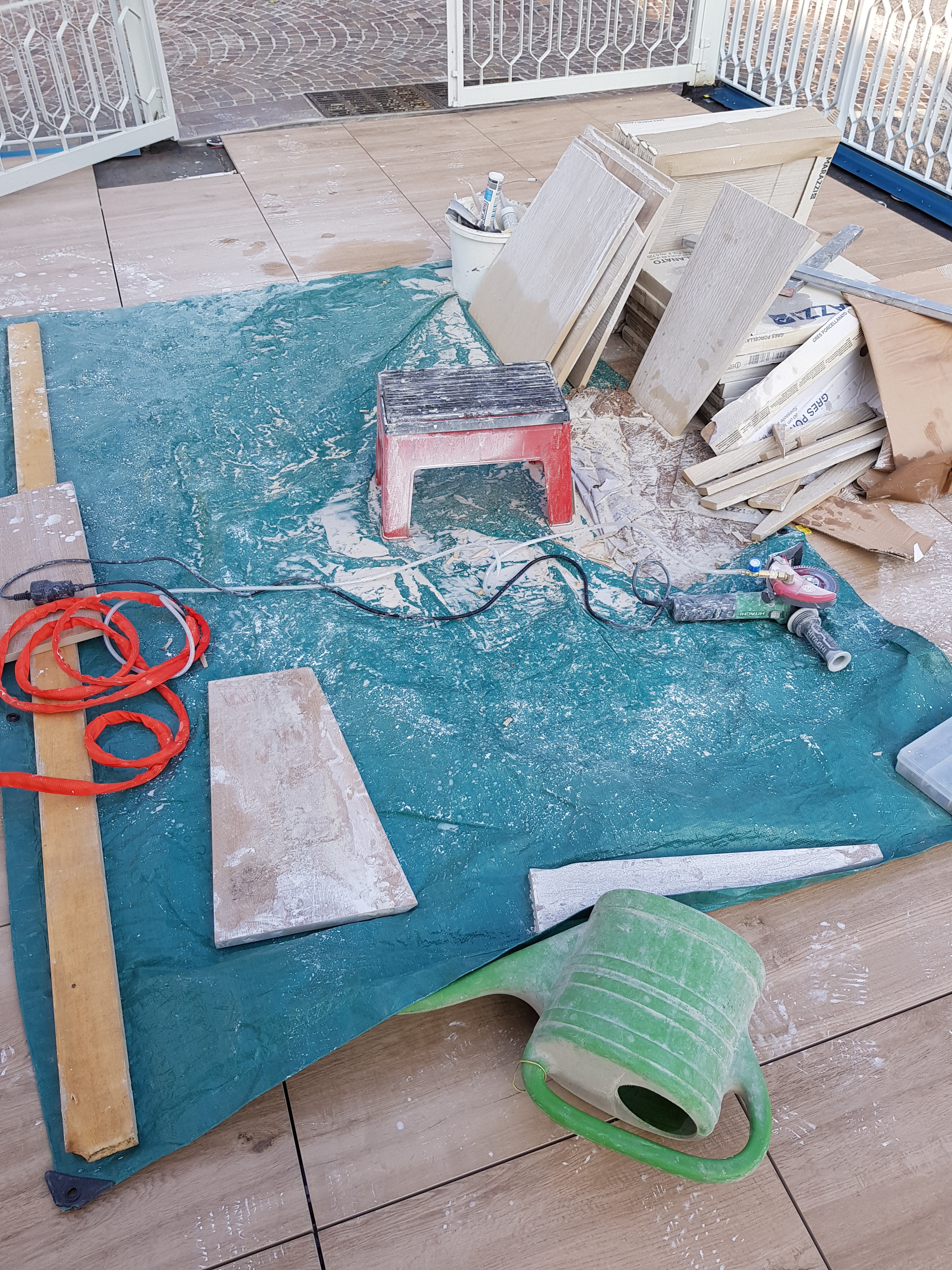

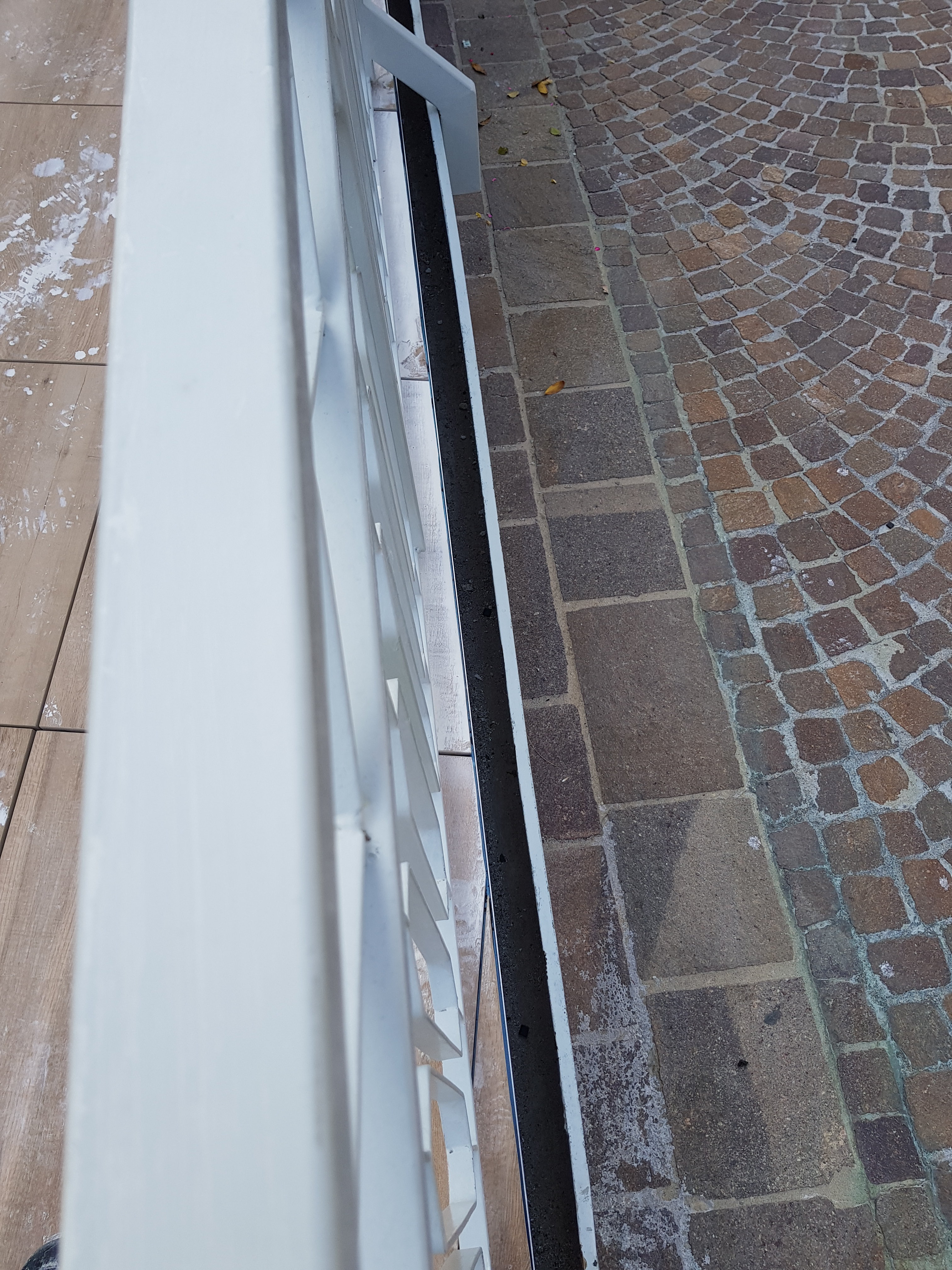

I tried aquaflex this morning,
only 2/3 cuts, first impression is good
more speed (but it depends a lot on the tile match).
with that blade cover I need training.
