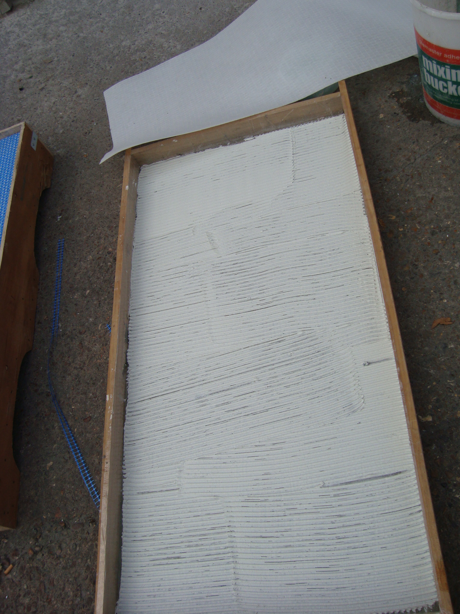

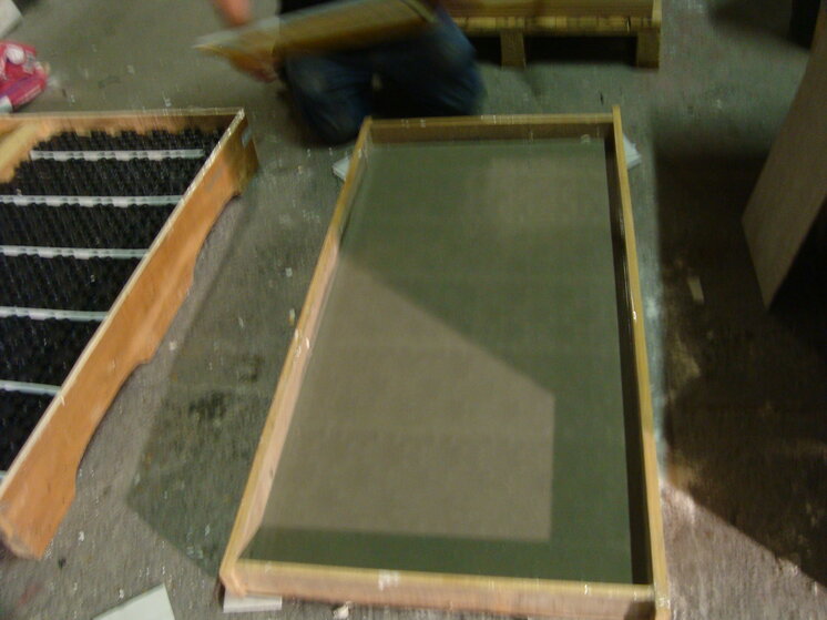

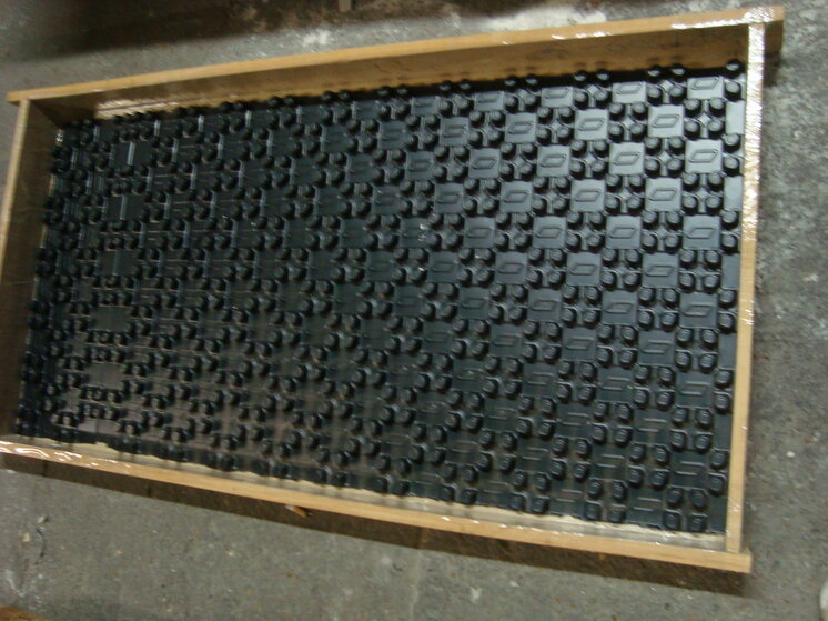

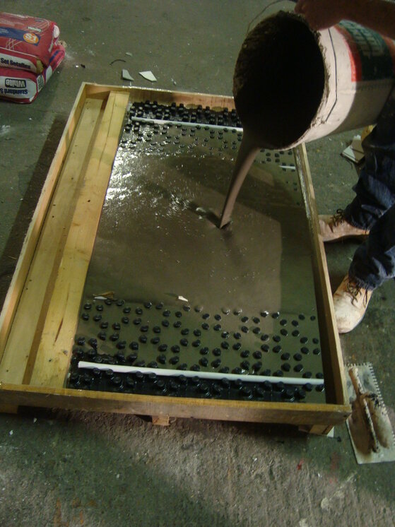

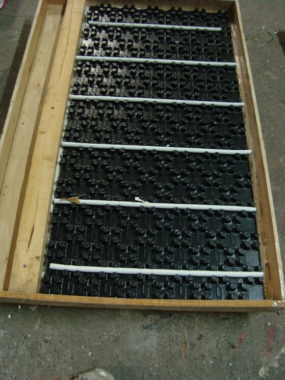

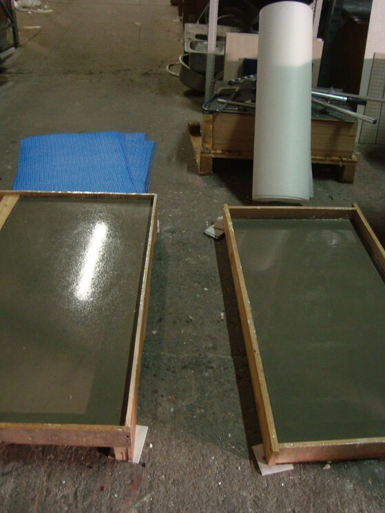

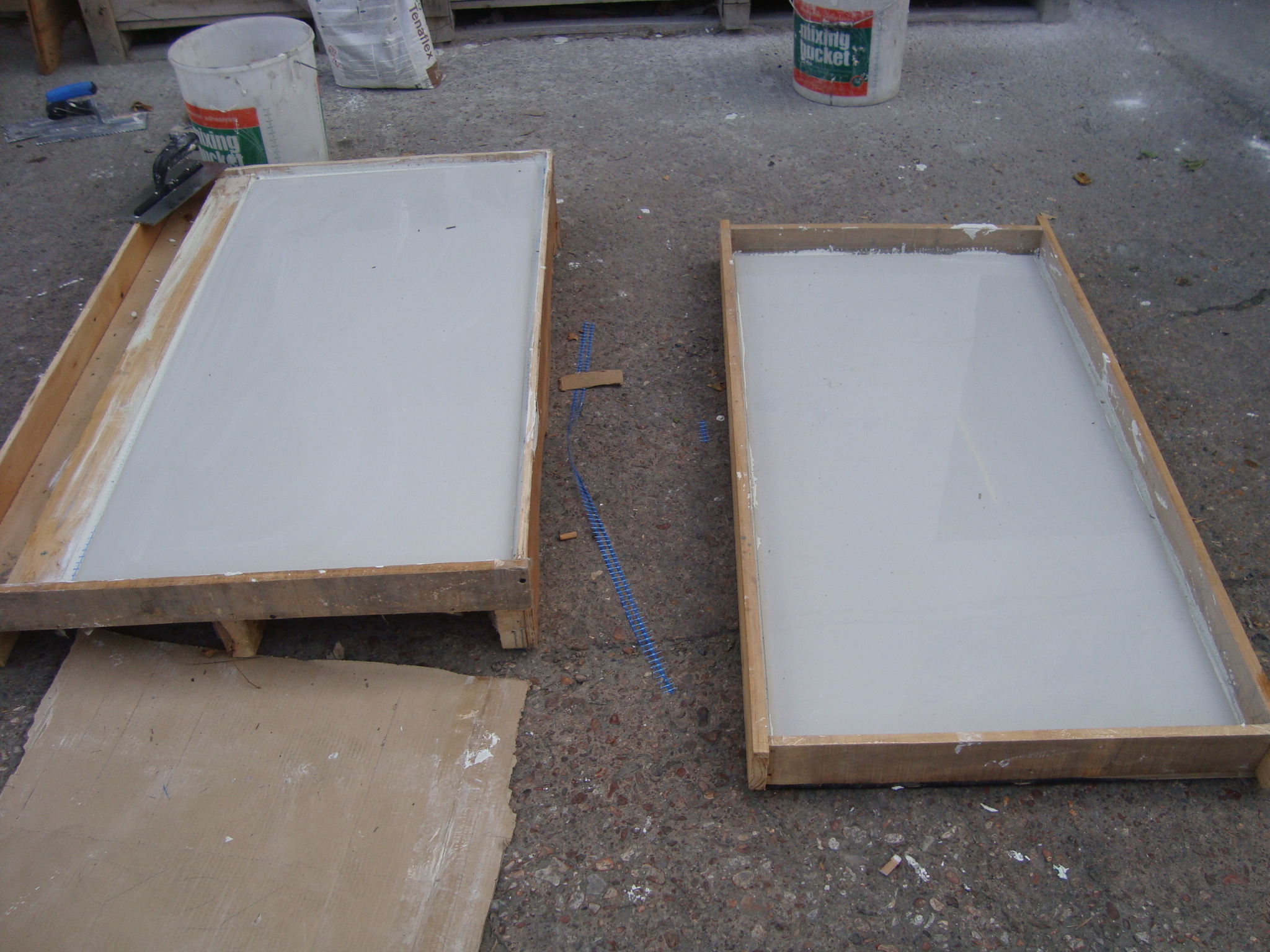

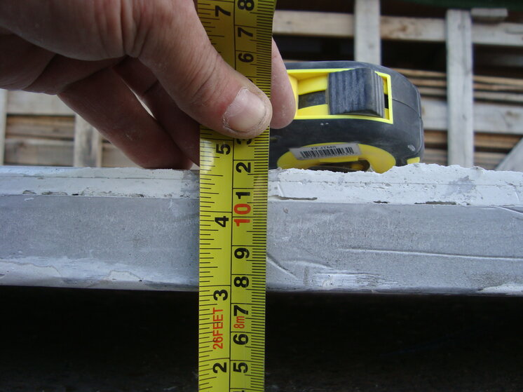

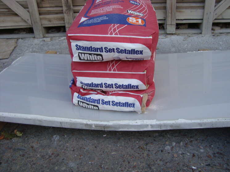

well have been asked to test fixing to wet under floor heating pipe system with porcel thin so first i tested the tile to see how much movement it would allow before fixing so put two battens at each end of a 1200x600x4.8 giving a 150 mm loading each end then loaded the middle to test deflection until the tile broke at 50kg i had 25mm down and 25mm up so over all 50mm of deflection at 55kg the tile broke so unless you suffer an earth quake there is plenty of give in the tile next built 2 boxs 1200 x600 and fixed the heating system in to the boxs then covered the system with mira floor screed .4mm above system .tomorrow i will fit the decouplars one is iso mat the other will be blanke permat then
tile .then leave to dry for a few days then see how much each can take .the plummer has said on site before you self level the system must be under 5 bar pressure so the pipes have exspanded more than when the system is run with heating at 2-3 bar

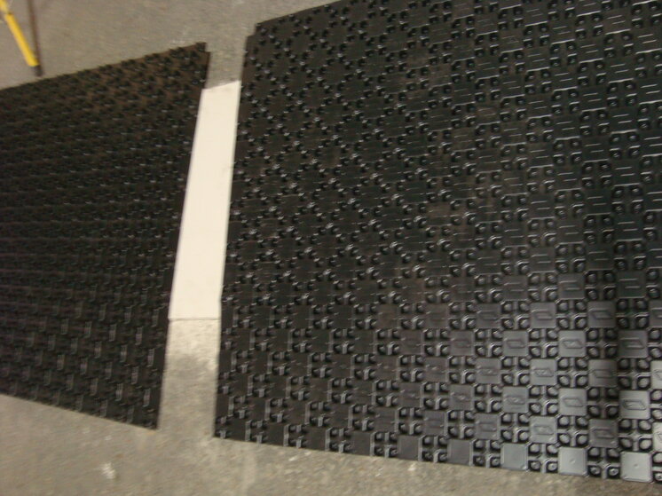

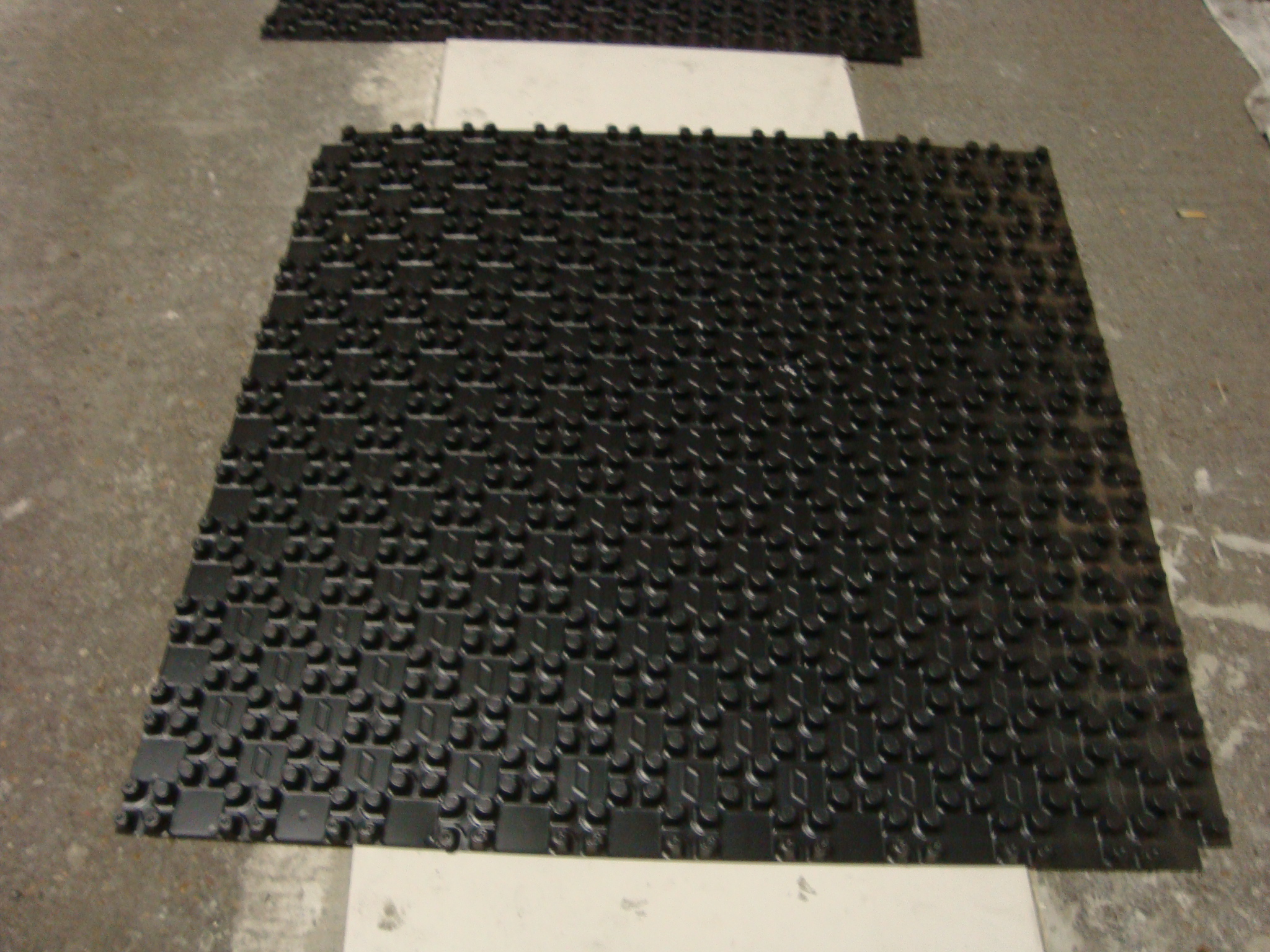

heres some more pictures with the decouplars i will be using
DSC08688.JPG DSC08690.JPG DSC08691.JPG DSC08693.JPG DSC08692.JPG DSC08695.JPG

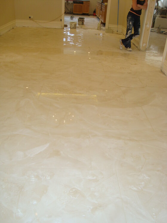

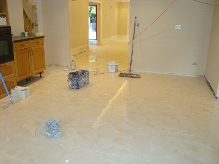

Over a screed covering the pipes and it's been down for 2 years plus though Ray
this system there is 200mm between pipes the depth of the system is 16mm so 20 mm laid .when the tiler bought the system to me he told me they are fixing it down now i said how are they fixing the base down he said loose lay .i said you better stop the plummer now .the second you start pouring the screed its going to lift straight off the floor you will have to keep on pooring till it hits the ceiling .at 120 m2 thats truck loads .he called and stopped it there and then .we stuck it down with rappid set did the trick held firm

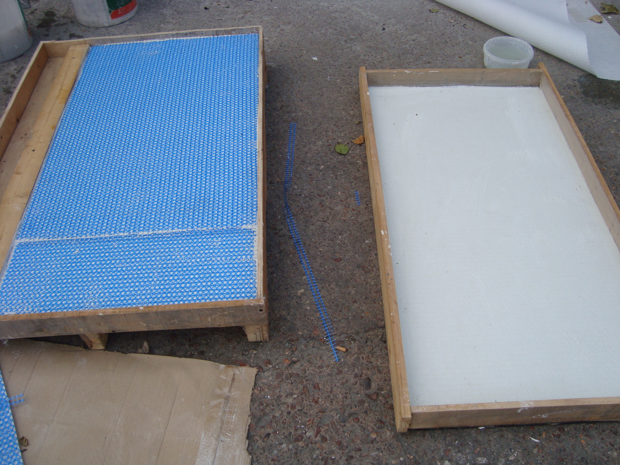

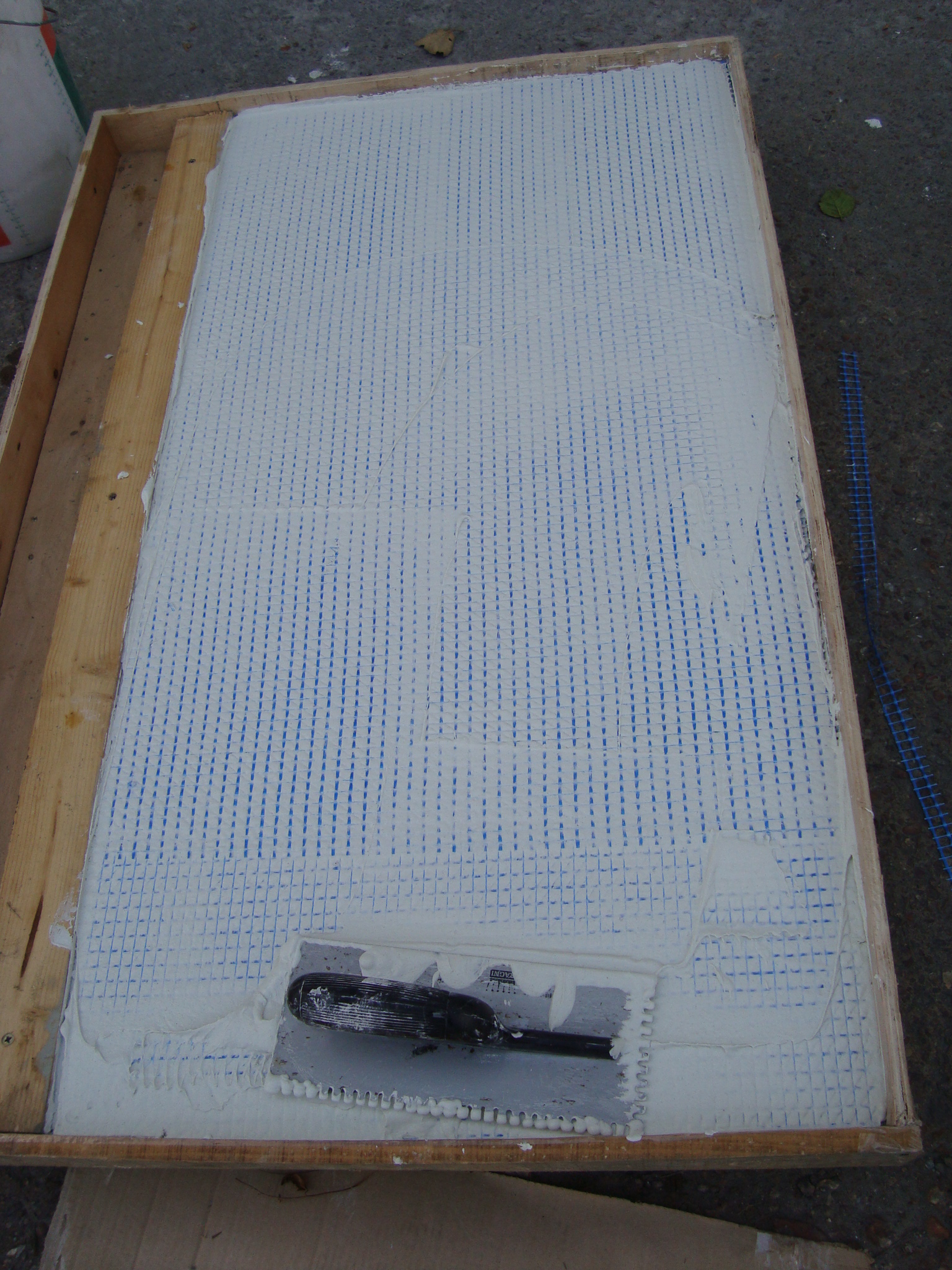

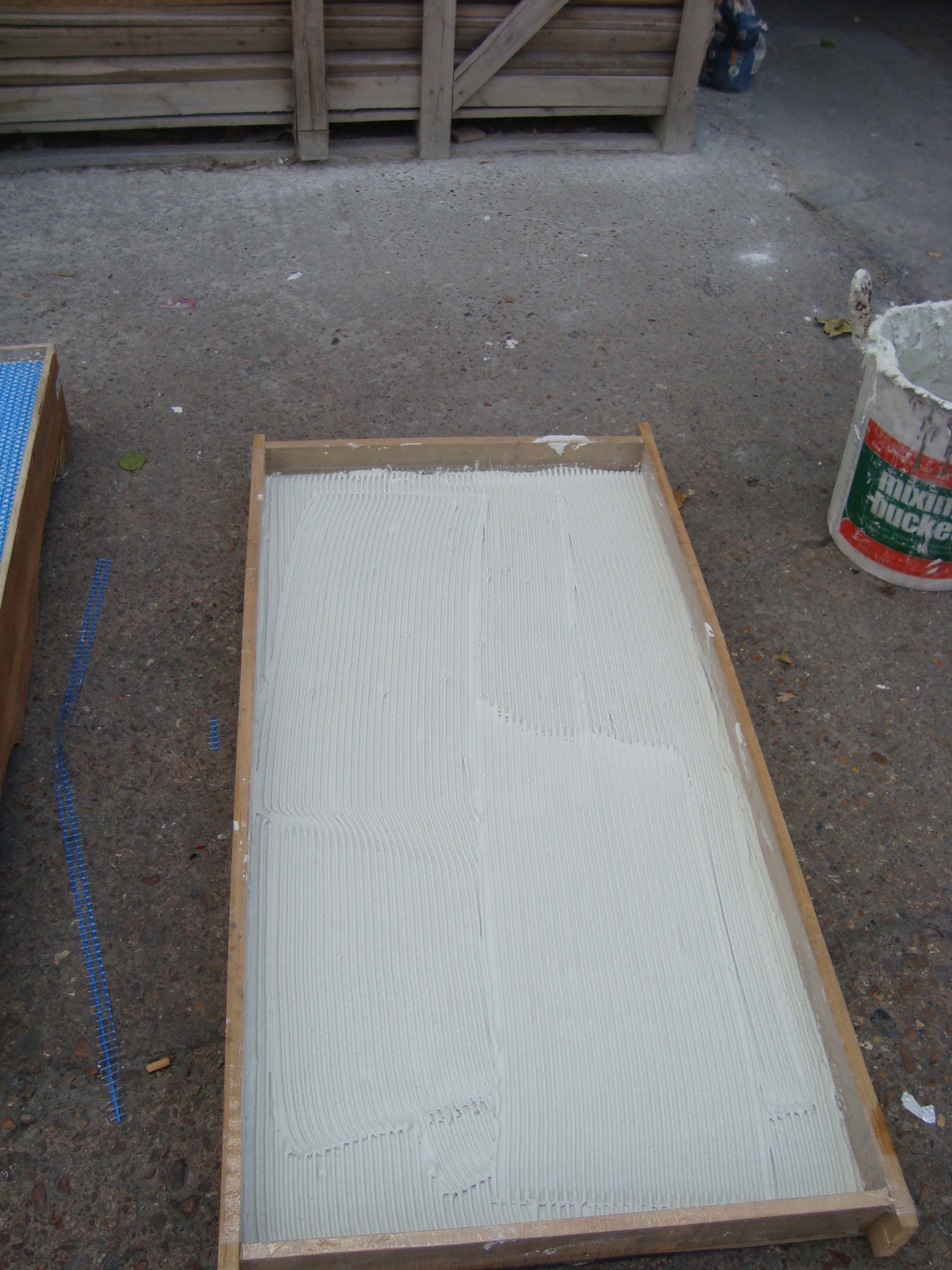

well got the decouplars down and tiles in the box all fixed will brake out on tuesday and test
the results :)

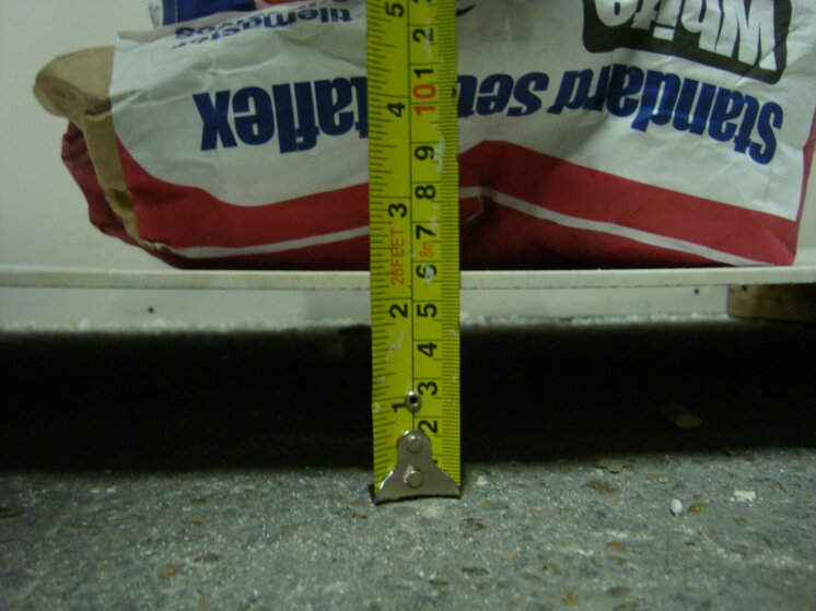

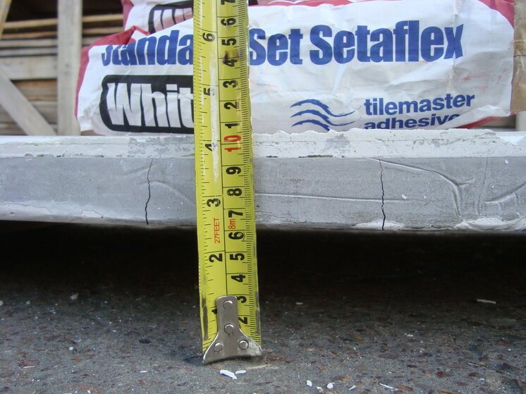

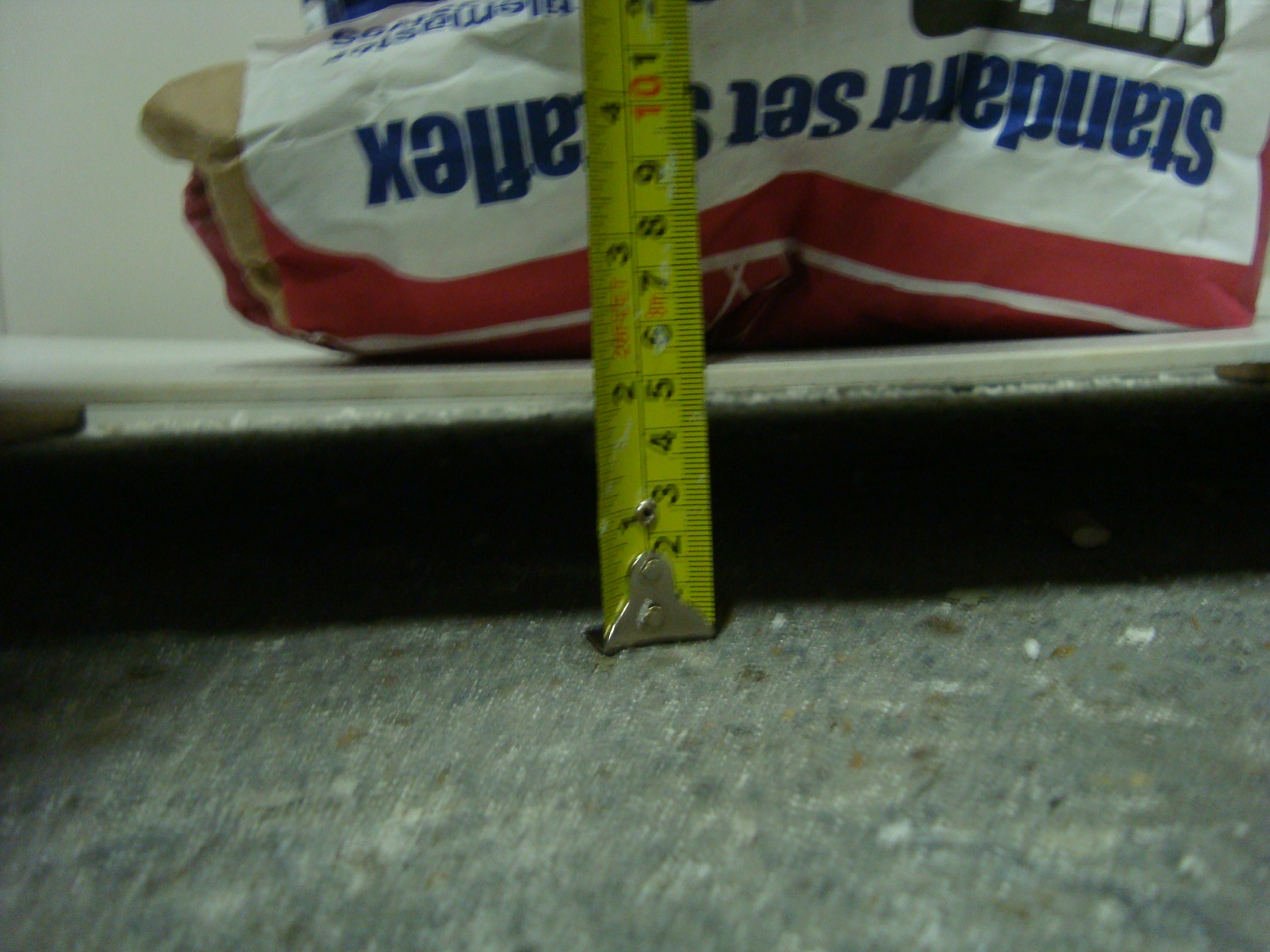

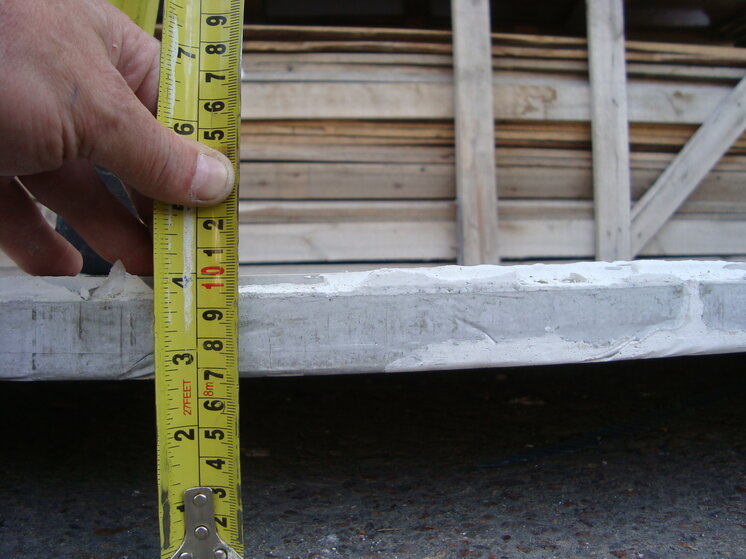

well here are the results of the iso matting
unloaded 68mm off floor centre
20kg loading 64mm off the floor total 8mm deflection
40kg loading 61mm off floor total 14mm deflection
60 kg loading 58mm off floor total 20mm deflection cracking goes through to tile DSC08731.JPG DSC08736.JPG DSC08737.JPG

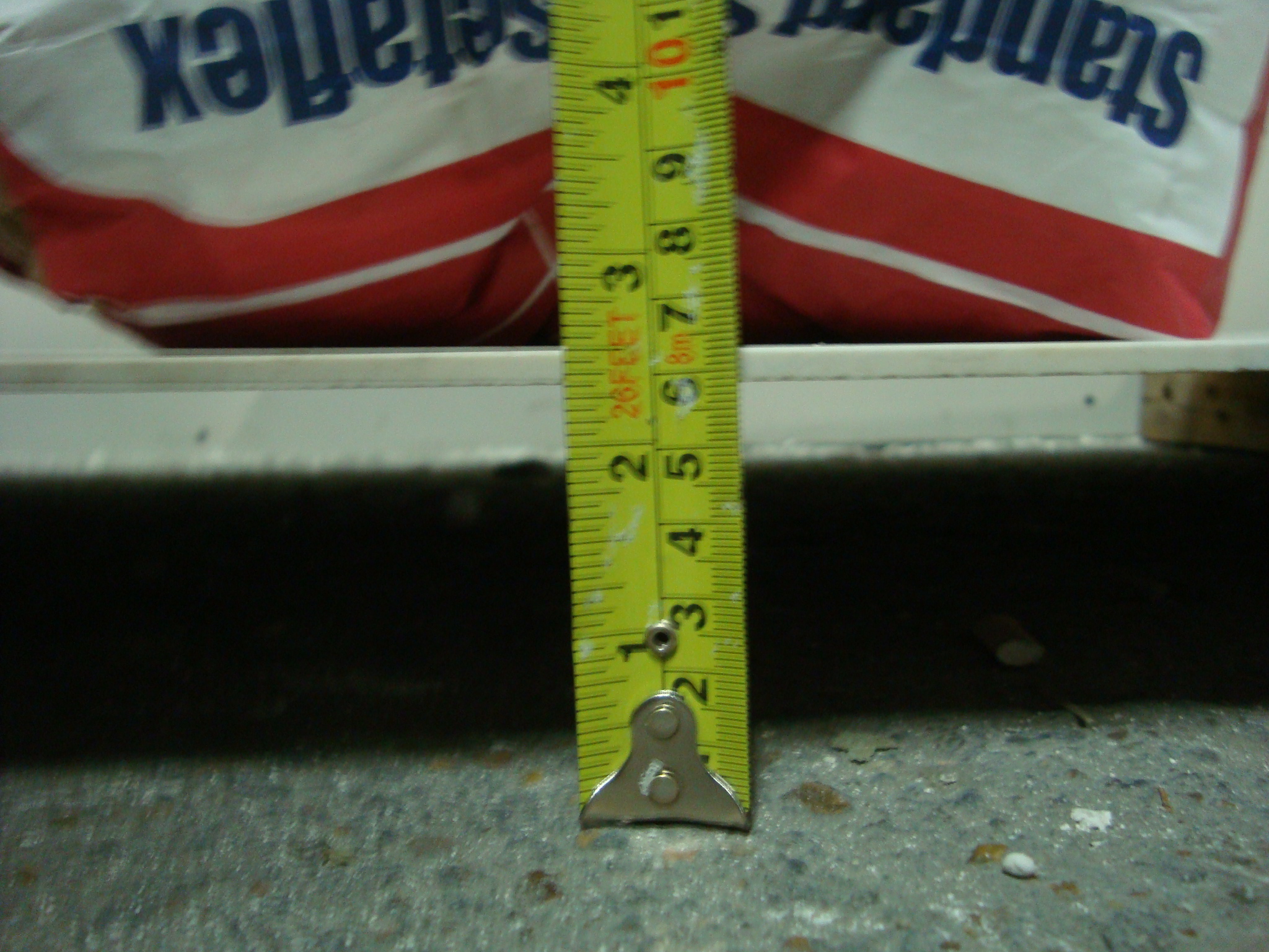

well here are the results of the blanke permat
tile unloaded 75 mm off the floor
20kg loading 73mm off the floor total deflexion 4mm
40kg loading 73mm off the floor total deflexion 4mm
60kg loading 70mm off the floor total deflexion 10 mm
80kg loading 67mm off the floor total deflexion 16mm
90 kg loading 65mm off the floor total deflexion 20mm
100 loading 58 mm off the floor total deflextion 34mm
110 kg loading 54 mm off the floor total deflexion 42 mm
at 115 kg loading the crack goes through to the tile
