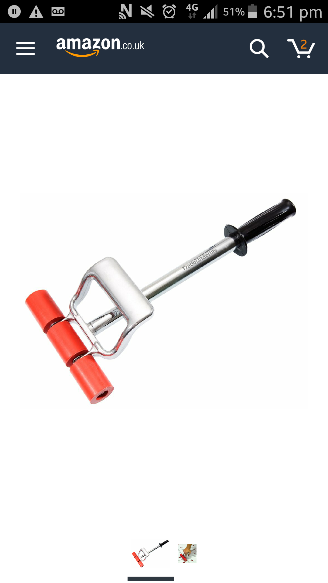

I have a kahndean flooring roller I use to embed it it works a treat
Same as, I use it for insulation boards too.
Me too, it gives you a really confident feeling when you've gone over it with one of these
