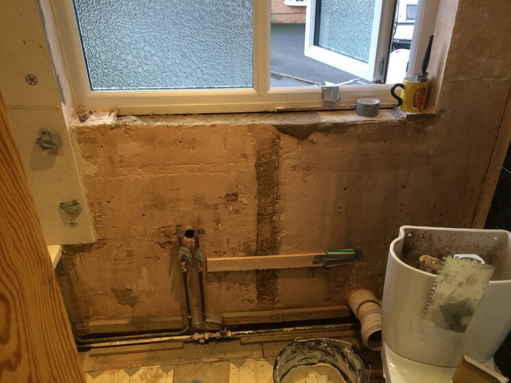

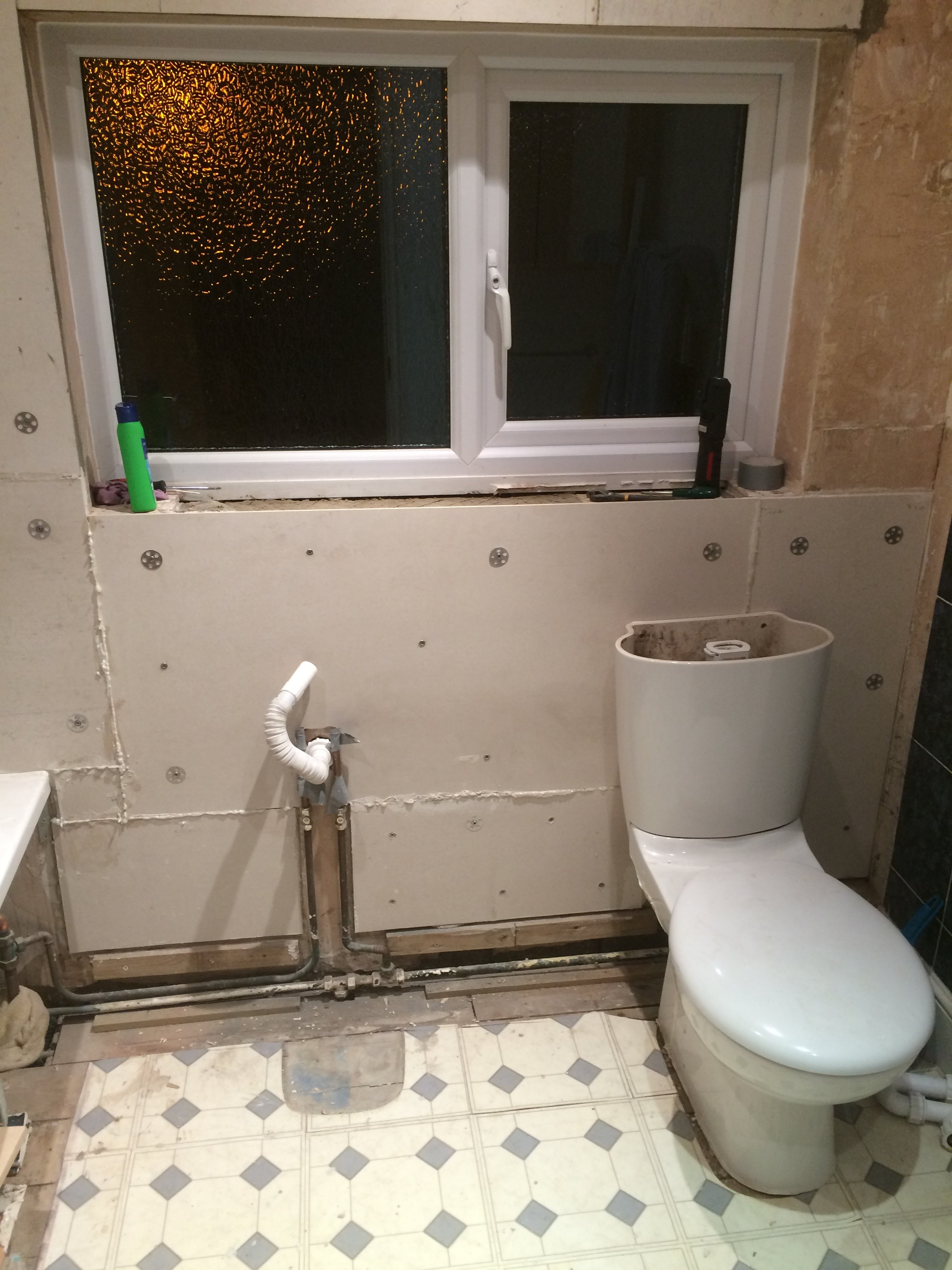

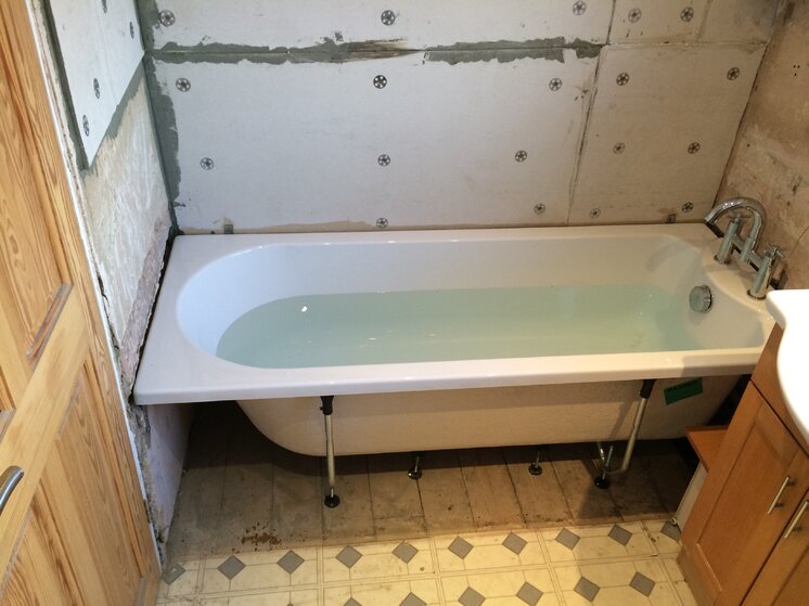

Doing our bathroom over. Just finishing off putting backer board up and thinking about the tanking and actual tiling. Suddenly had a mini panic attack that I am not mixing up the adhesive enough. Mixing by hand, I never seemed to be doing it in large enough amounts that a paddle worked for me. So....My question...
Is it possible to under mix bagged adhesive (Mapei in my case) ? What would be the result if you do? The boards are stuck on fast, tried to pull a small section off by hand (that isn't mechanically fixed like other bits), and there is no moving it! So the boards are stuck on well I should say. Some have been on 6 months now!
Thanks!
Ste
Everyone loves a picture or two, so here are some 🙂
