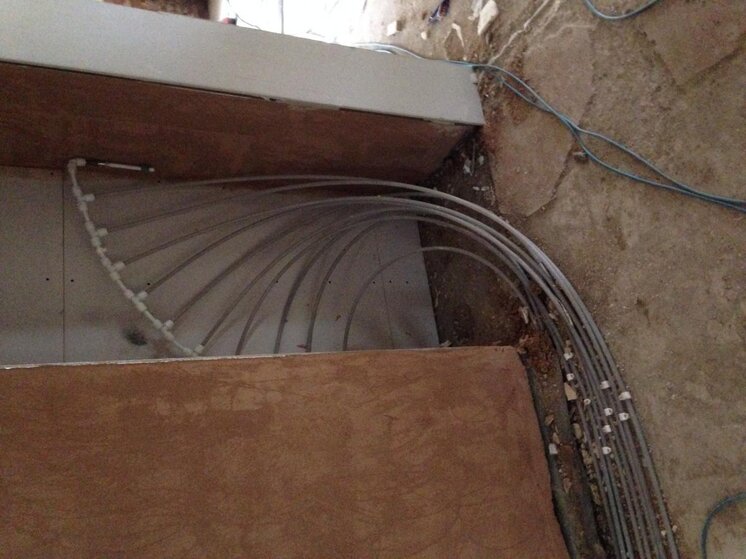

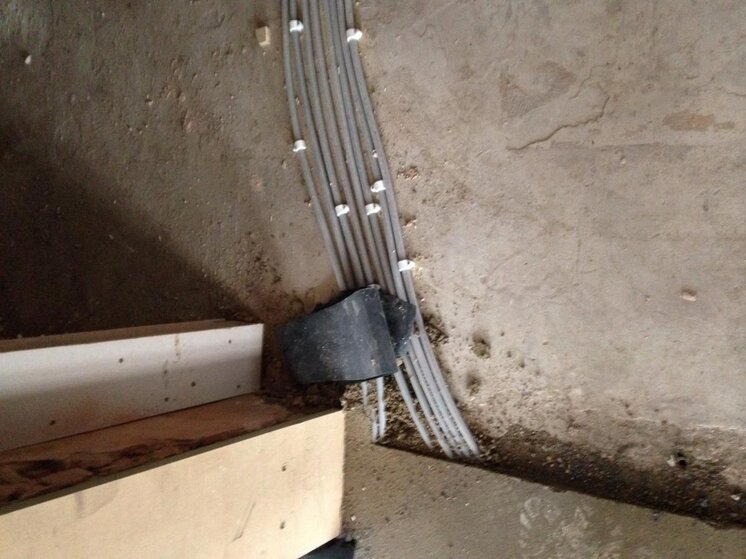

Good morning. I'm after a little advice if possible please. I've read some other threads regarding the commissioning of under floor heating. I'm trying to get my head around it so I apologies at the start. I'm due to tile a large area which has under floor heating encased in 65mm sand and cement screed. The pictures below are of the end of the pipes which run through the screed. Can someone explain the commissioning process when using a piping system like this please. Does this system have to be commissioned prior to tiling. (Probably a silly question)

Have you fitted this yourself?
Those pipes going to other rooms will need sleeving to keep the heat in the room it is designed for.
