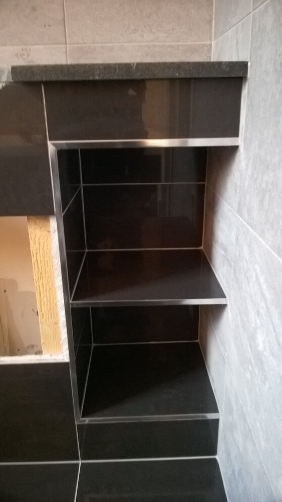

They are only mitres?! eh?!?!

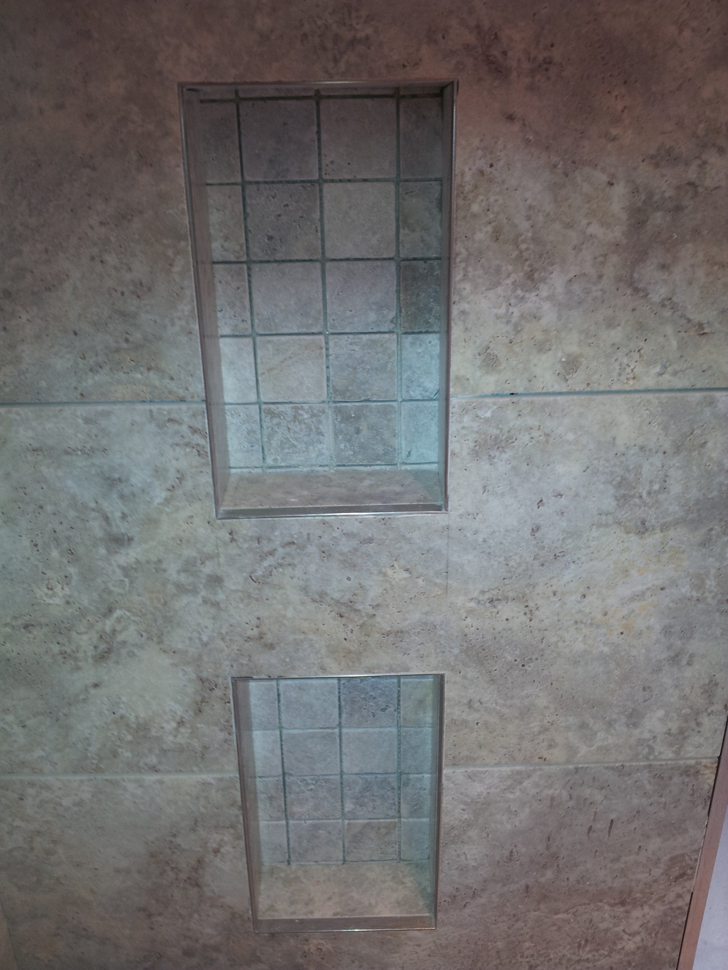

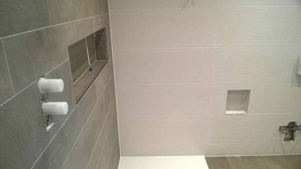

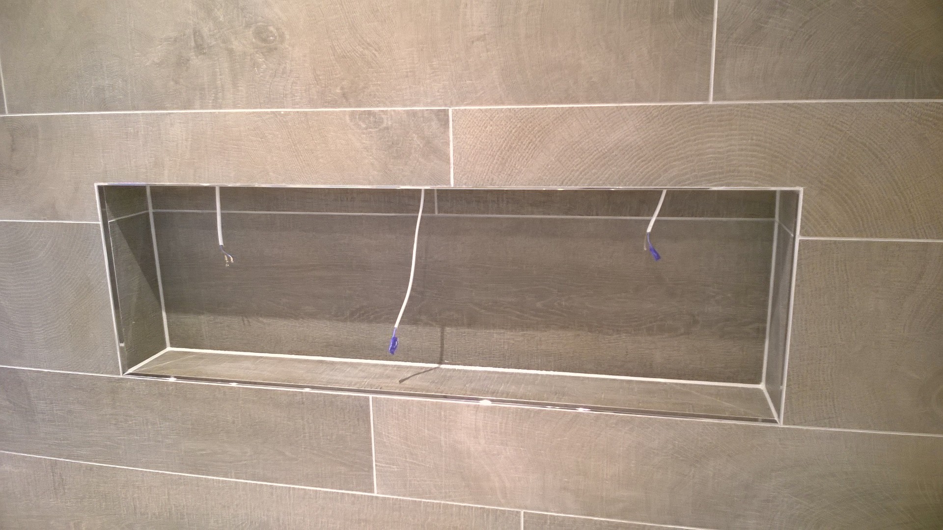

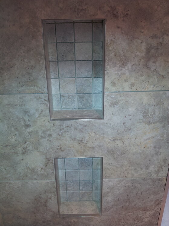

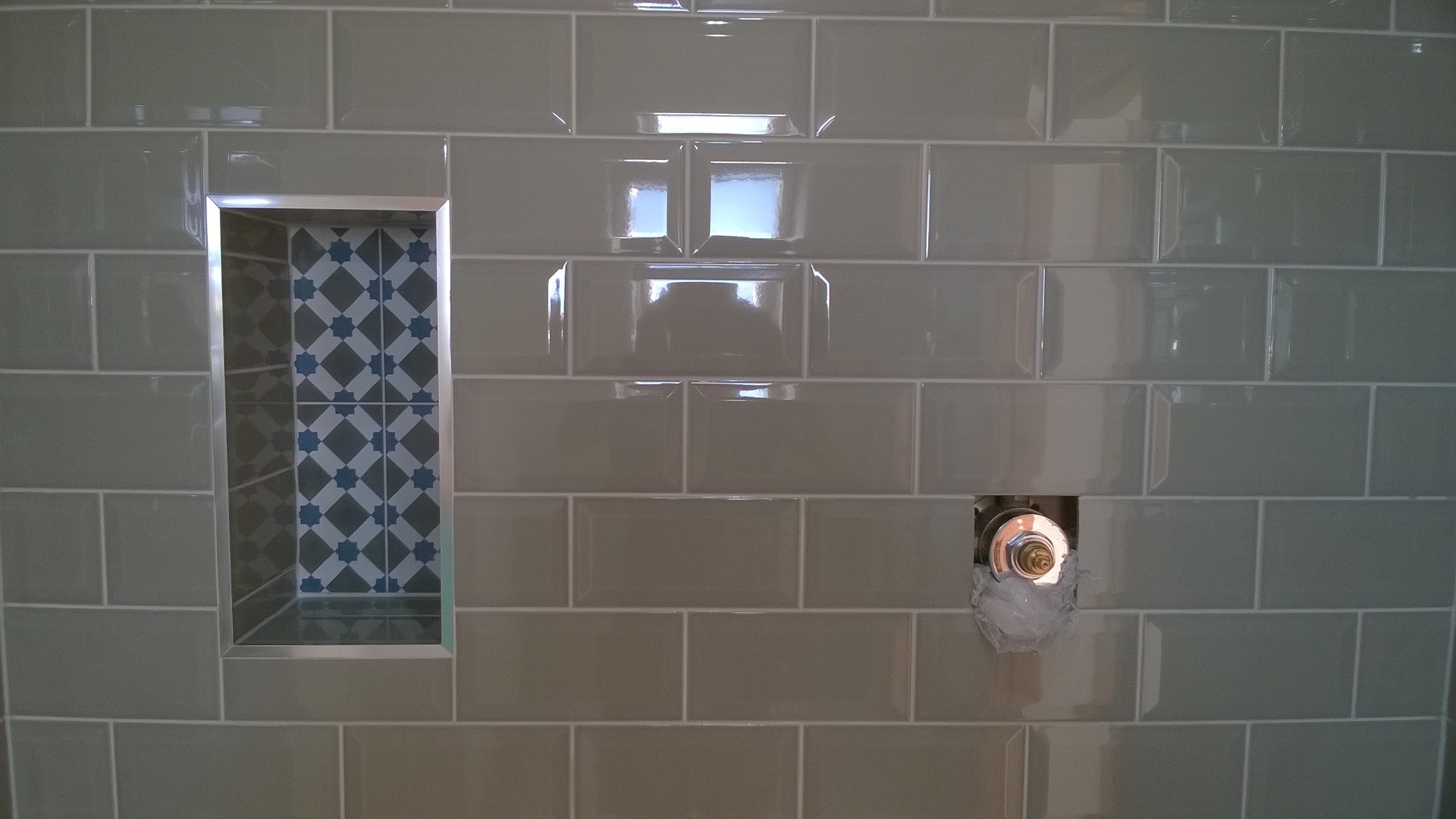

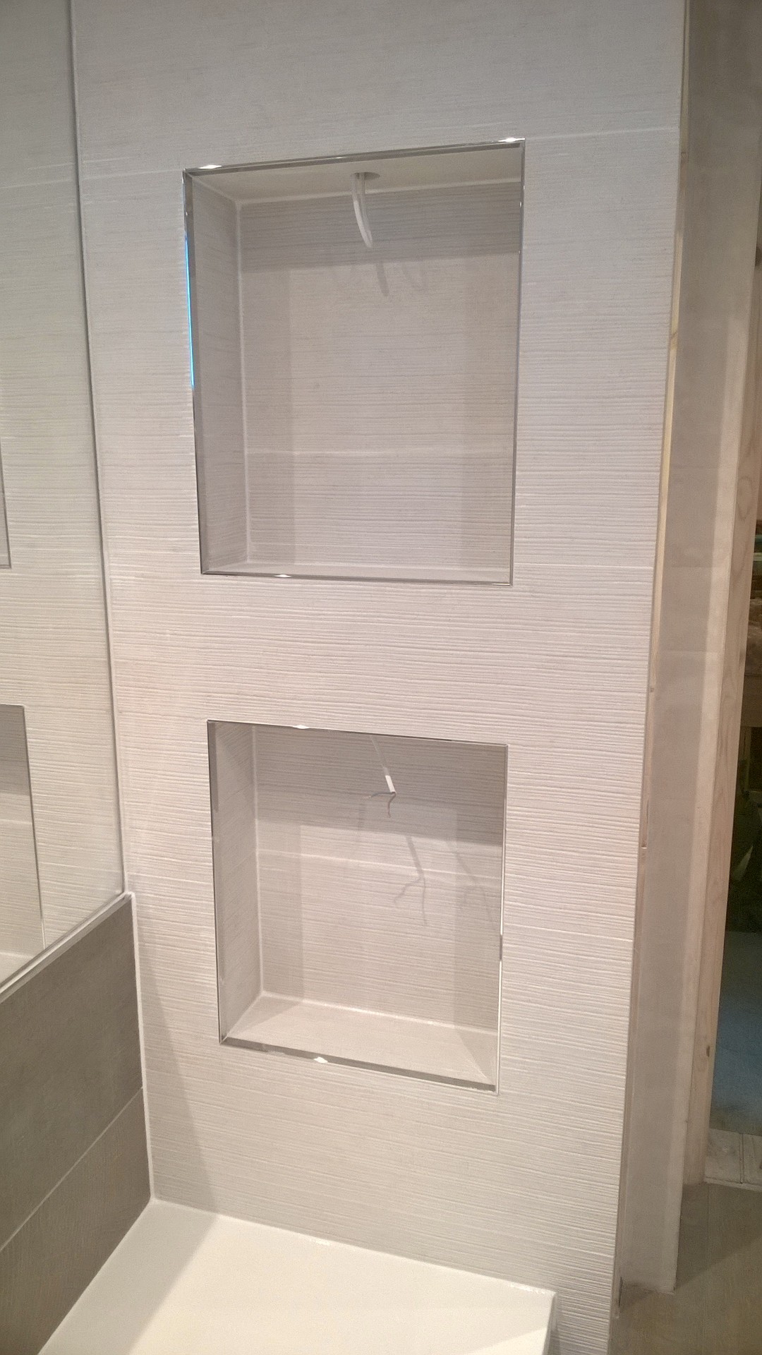

U do know u can use the trim this way also and I think it's a more subtle look.
Its easy once you get the hang of it Bri. I do all my trims this way as i find it more subtle. Just go passed the reveal about 12mm,or more if window out, cut trims and use just a little Silicon or tape to hold in place till you tile the reveals.
WP_20160708_012.jpg WP_20160708_007.jpg WP_20160708_007.jpg WP_20160708_012.jpg WP_20160415_013.jpg WP_20160415_011.jpg
all the trims mitred . and fitted both ways i prefer the trim face not shown , last couple of jobs , there were 6 in the last bathroom i done , all the trim was bought from porcelanosa so it was a real pain to cut,
I might just have to give it a go the next time........like you say subtle and looks a damn sight easier.
