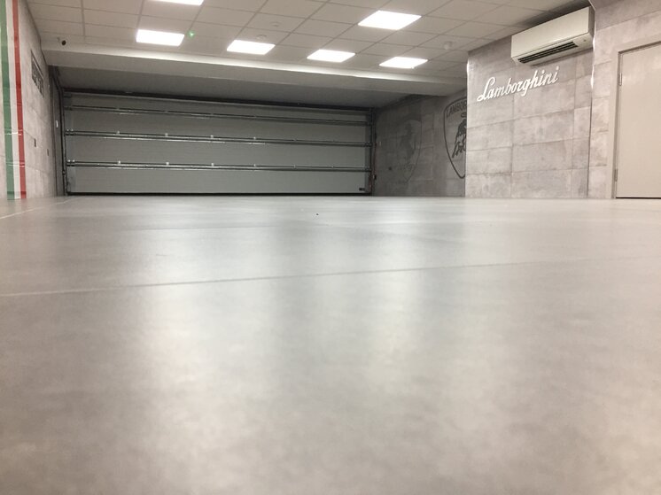

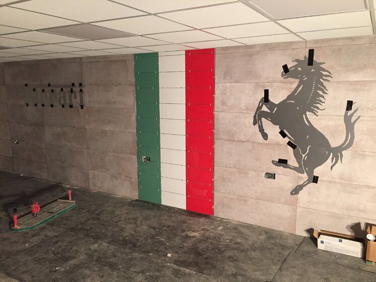

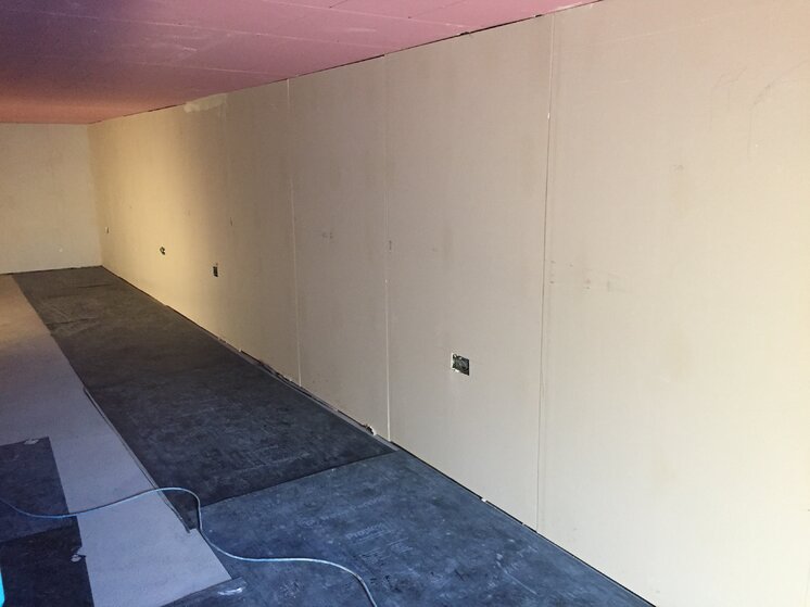

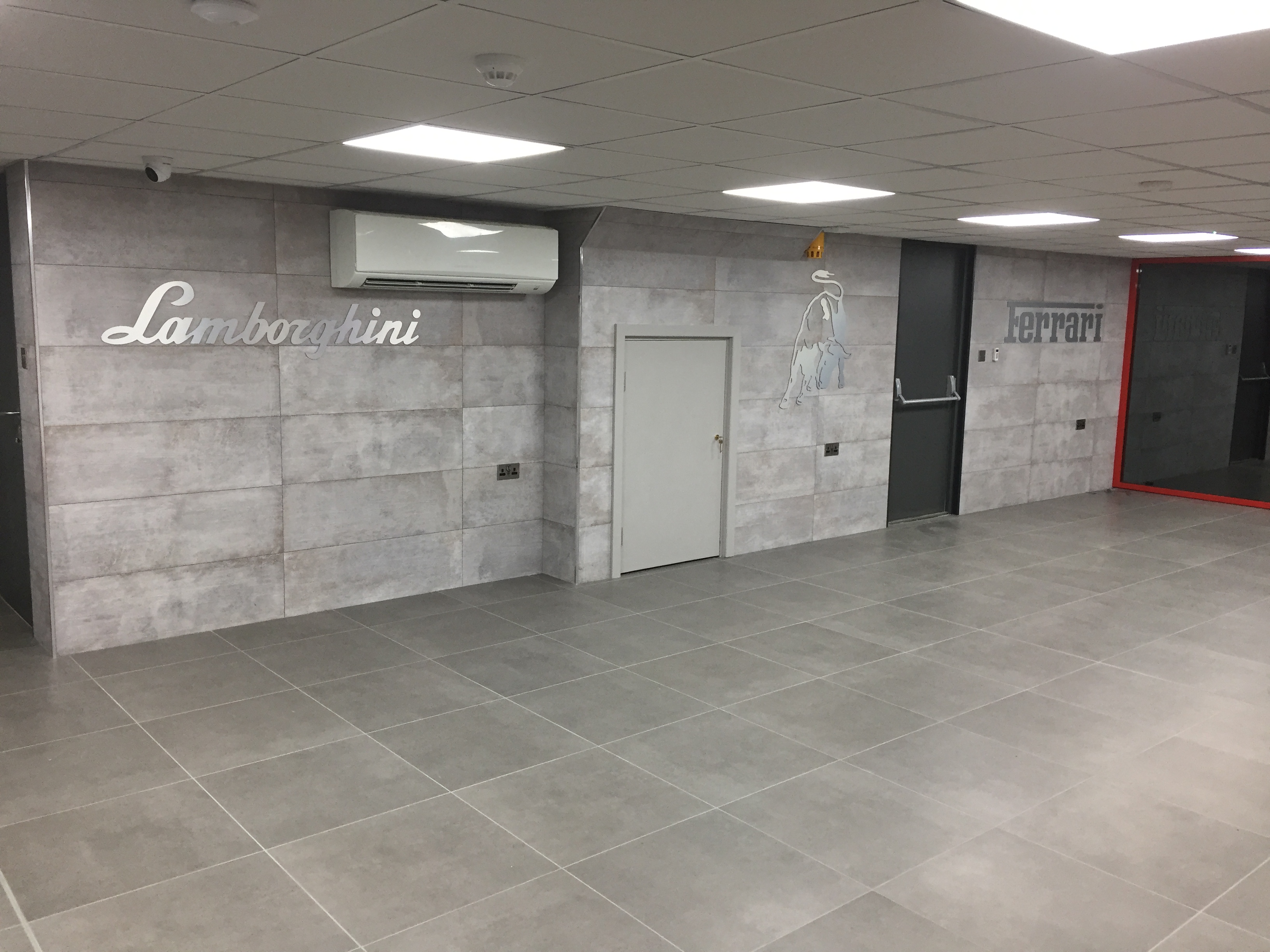

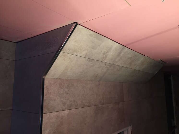

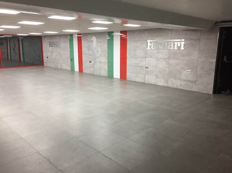

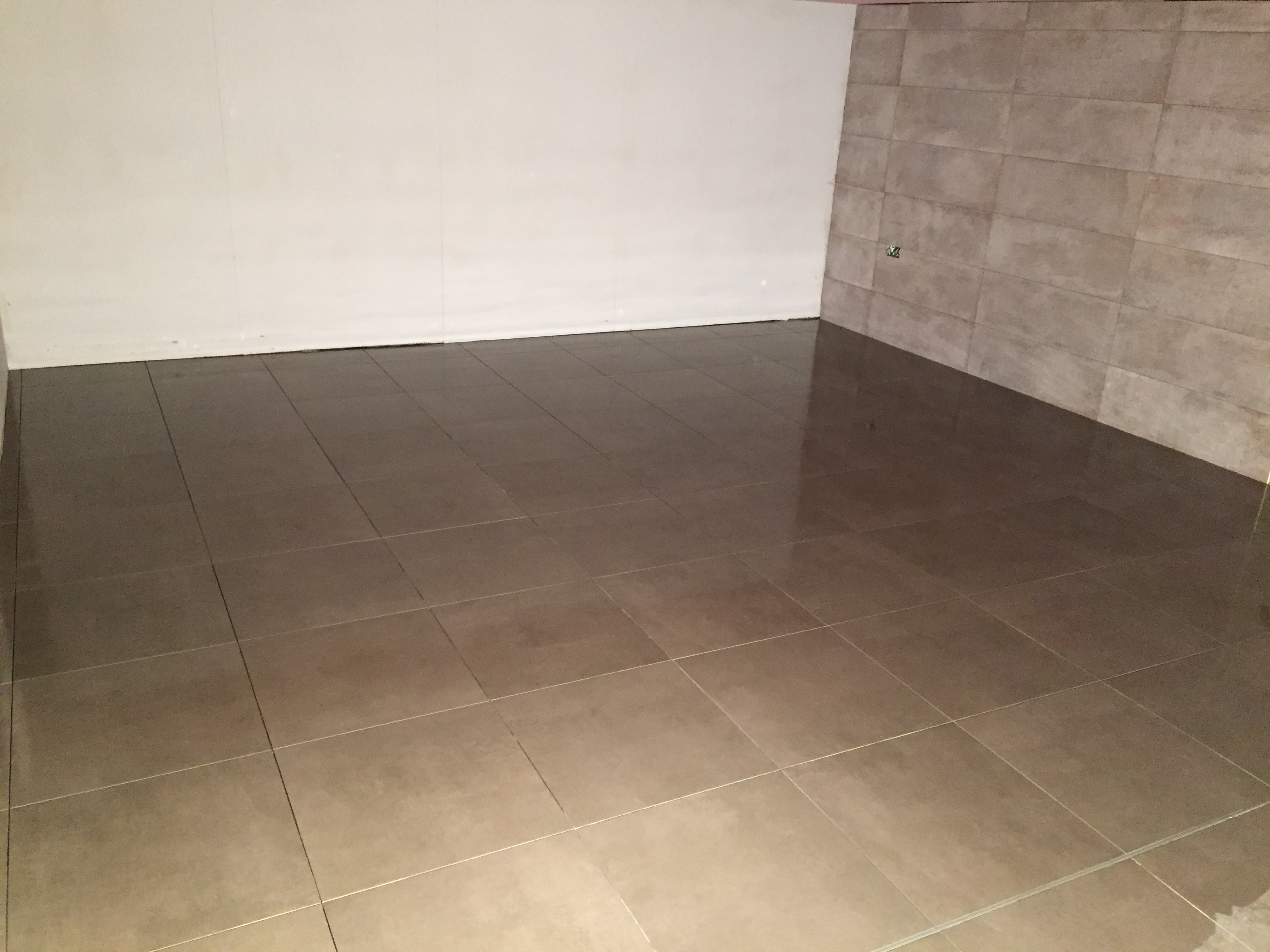

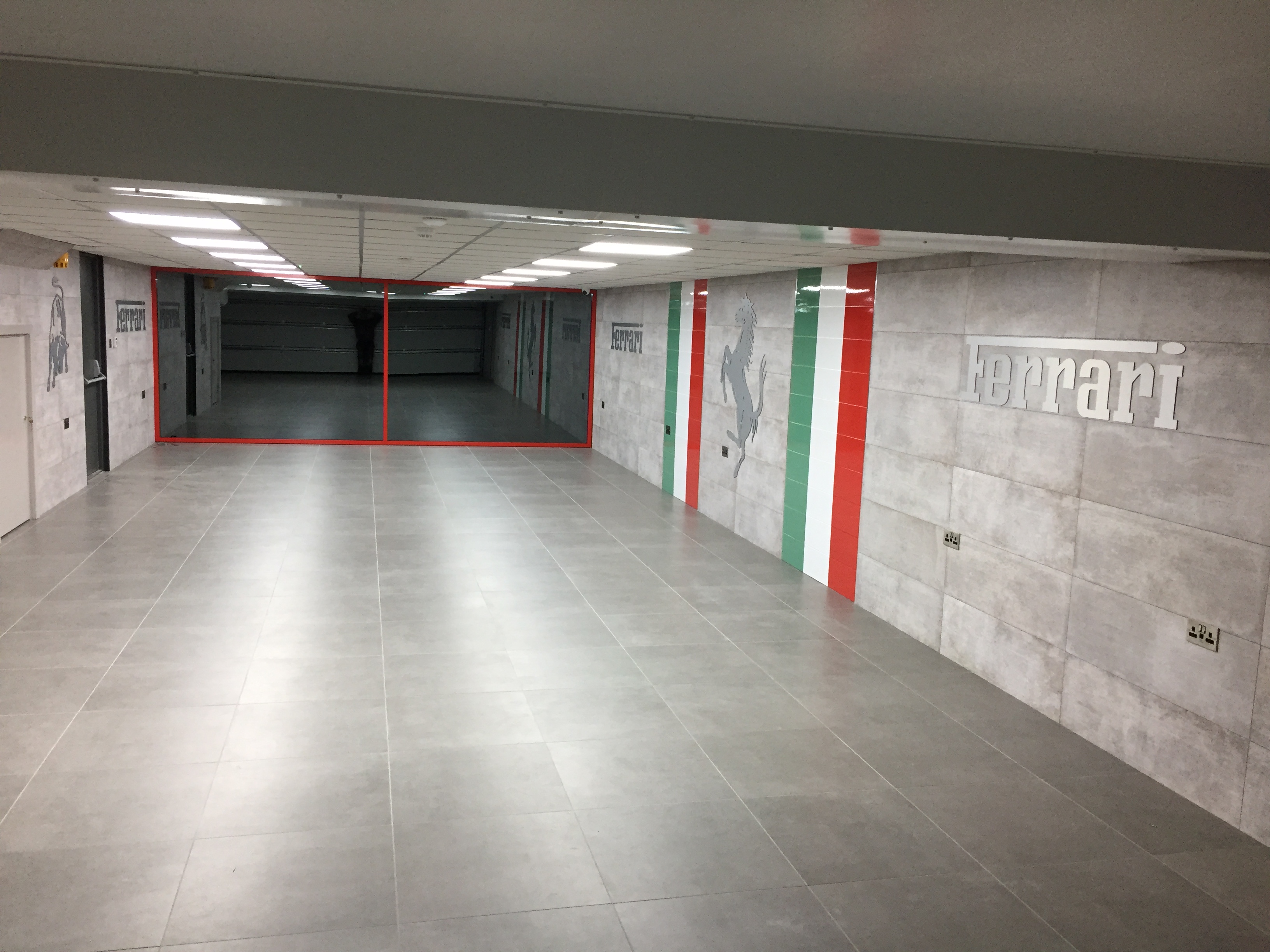

Following on from the basement project, this is the next floor above. 70mm sand and cement screed, sanded and primed. TM anti-crack mat fixed and floor tiled with 60x60 Porcelanosa porcelain, walls are 1mx330 Porcelanosa ceramic, Mapei 113 cement grey grout on walls and floor, 40x20 coloured tiles by Vogue (Italy). Siliconed joints on coloured tiles with RAL coloured silicones.
