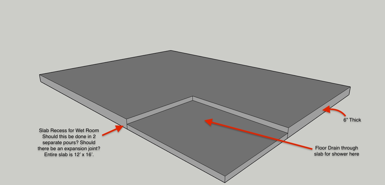

Hello,
I know this topic seems to be popular. I have already learned a great deal from reading so far. I am designing a small shop (3.6m x 4.8m) that will have a small wet room inside (1.4m x 1.83m). I plan to use the Schluter drain and membrane system for my shower in which I recess the flat slab foundation that I pour to allow for the subsequent mortar bed and preslope in the wet room to be close to the finish floors in height. I plan to use a wall mount toilet on a built-out cavity to keep the drain pipe inside the building envelope. I have attached a few renderings now that I have done some research. Where I live, there are not many wet rooms so I am seeking some feedback on what I have drawn here. If something looks egregiously amiss, feel free to offer up any suggestions.
Thanks in advance.
John
