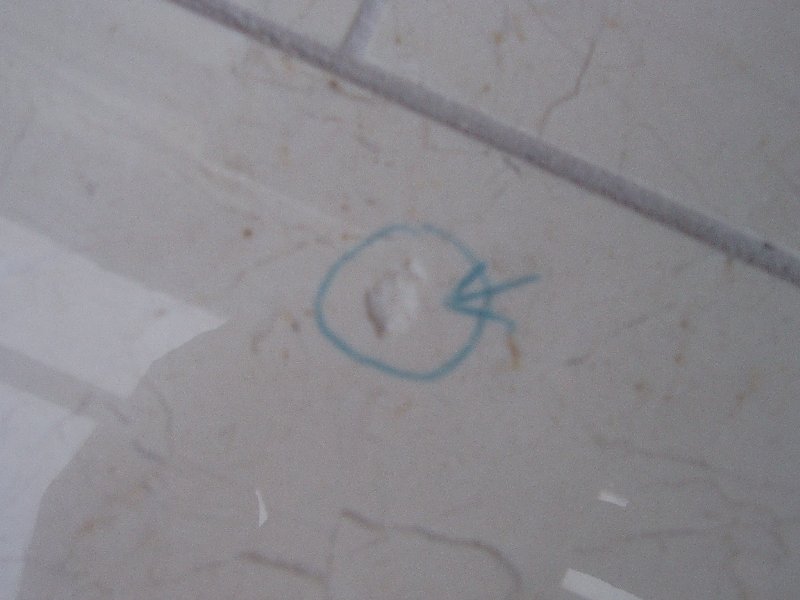

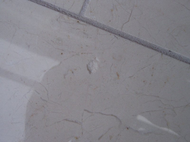

Just been to a customers house and they have a marble floor in there kitchen. One tile has got quite a big chip in the middle of it (well not massive, about 10mm x 10mm), rather than replacing the whole tile is there some kind of filler on the market they could use to fill it with, i think you can get a filler for travertine just wondered if there's anything for marble.

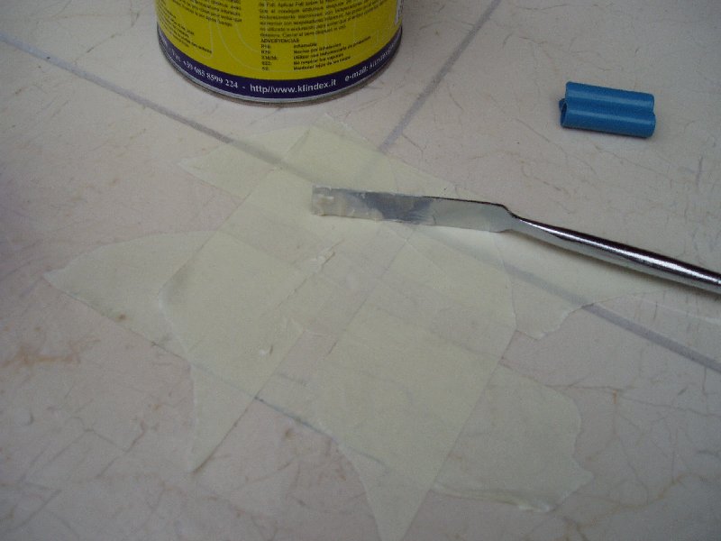

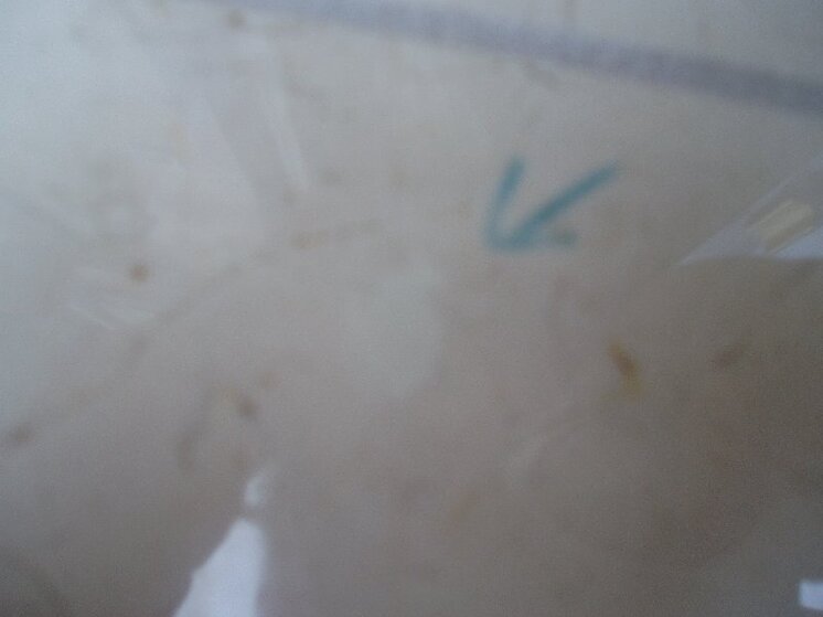

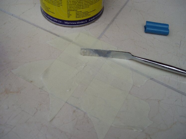

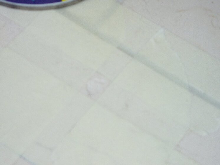

chipped tile 012.jpgchipped tile 010.jpgchipped tile 015.jpgchipped tile 017.jpgchipped tile 014.jpgchipped tile 019.jpgchipped tile 011.jpgYes you can get resin to fill Marble. Here is one i did a while back to give you an idea.Once polished you could hardly see it.chipped tile 022.jpg
The gear i use is Klindex Stukko...Go onto ebay and type in klindex click on the first item on that page then go to the visit shop. All the details will be there for you.
